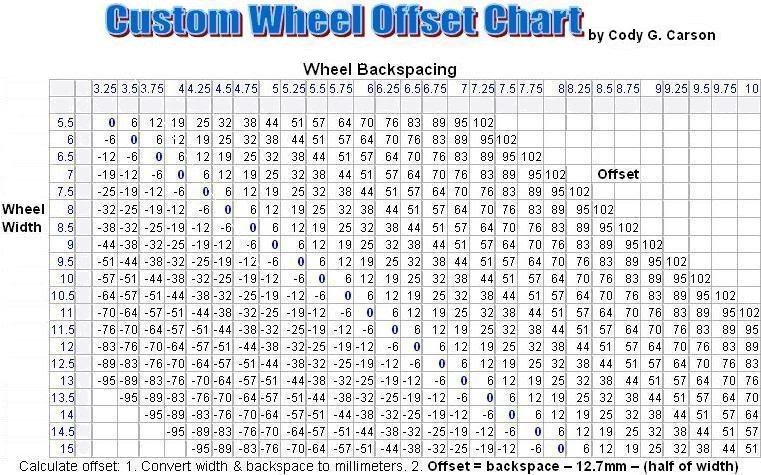

    I'm looking at some Dick Cepek DC-2s in 17x9 for my DCSB Off-Road.
    My question is how much farther will they stick out vs. the OEM TRD Off-Road wheels
    TRD Off-Road Wheels:
    16x7
    +32 mm offset
    5.25" backspacing
    DC-2s:
    17x9
    - 12 mm offset
    4.5" backspacing
    I looked at the BS and Offset sticky and tried to do the math, but I'm still confused.....

    They will stick out 2.75" more than stock. 0.75 from backspacing, 2" from width

    I think it would be more like 1.75" further than stock. The 2" wider wheel width doesn't all go to the outside, it also goes inside and sits closer to the frame and suspension.

    Backspacing already takes the spacing on the inside into consideration. So all of the extra width gets added to the outside.

    I.e. if you add some of the width to the outside, and some to the inside, you have now changed the backspacing.

    So it looks like 2.75"s farther. Do you think this is too much? Or will it be good to go. I want them to stick out a little more, but don't know if the 2.75" will make them stick out too far???

  14. Mar 18, 2012 at 1:03 PM
    AWorthyOpponent
    AWorthyOpponent Member Caught Off Road
    Aug 22, 2011
    #62164
    2,967
    Dan
    Palm Beach County, Florida
    2013 MGM DCLB TRD SPORT 4x4
    TRD Catback Exhaust
  15. Mar 18, 2012 at 1:17 PM
    60guy
    60guy [OP] BADASS
    Sep 6, 2009
    #22363
    185
    Dustin
    Maryland
    2017 Limited Double Cab
    Dude, that is AWESOME! According to this they new set up will stick out 1.7" more then the OEM set up, which is pretty much exactly what I'm looking for.

    Nice tool indeed. And the discrepancy between what I told you and what it tells you for "how much more it will stick out" is that I was referring to the wheel only. Their calculator uses the tire too. Because the tire is stretched more (9" vs 7"), it will not stick out as far out from the wheel as the stock setup does from the wheel. .

    Yes, I noticed the difference once once the tire was added in as well. The 1.7" with the whole set up made me feel much better then the 2.75" with just the wheel.
