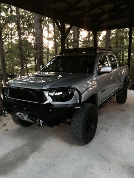

    You got a black lab with an orange collar also?!

    Haha I do! Got him the orange one to spot him easier, and it's the only one that's a rubberized material that doesn't stain or hold in smells from the farm.

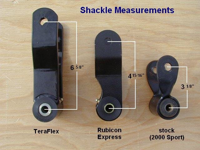

    You're going to want longer shackles to take full advantage of that set-up.

    What would you recommend?

    You're going to want a ~5" shackle length like an XJ shackle (vs 3.5" stock length) to take advantage of the extra travel you get from the shock relocate/12" smoothies. Ideally need to cycle the new setup and custom order the proper shackle length, otherwise pointless to do the shock relocation with stock length shackles.
    @ckeene9 correct me if I'm wrong

    Thank u so much for the insight. I'll look more into XJ shackles.

    I'm assuming they are 5" based off bad memory, you may want to look into it farther to make sure of the length, let me know what you find out!
    Edit, Found some stock length measurements for you @rka:

    Correct, I'm running the rubicon express and @loco was as well with his shock relocation.
