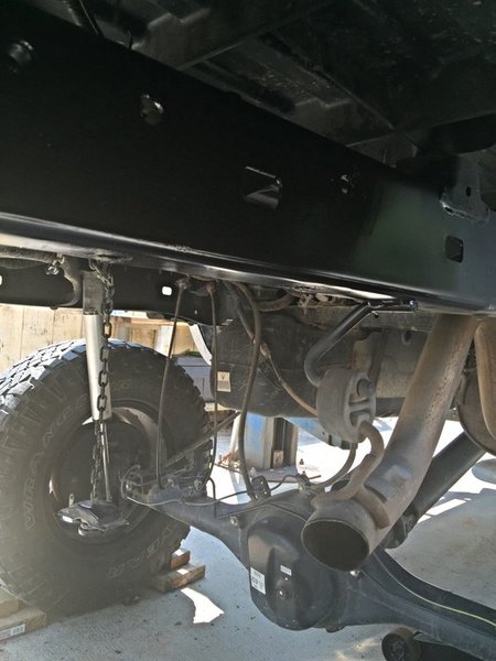

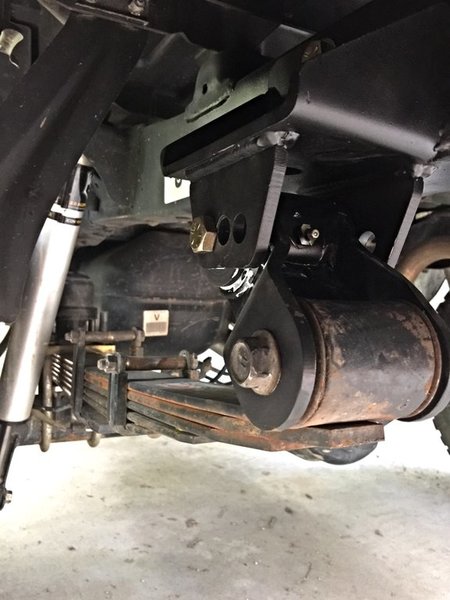

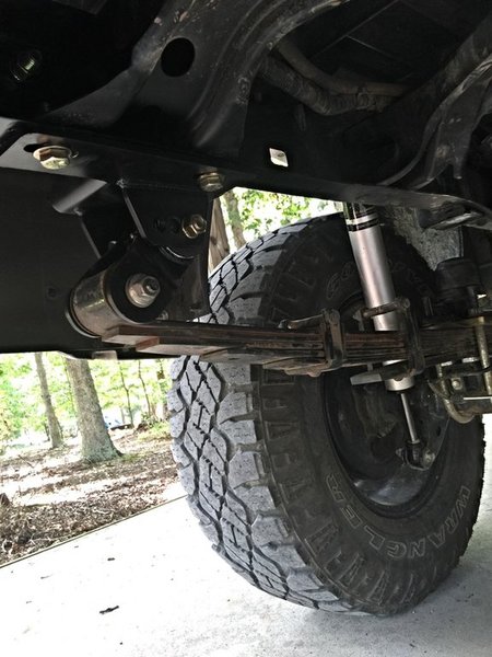

    Alright, finally finished my shackle flip. Extremely happy with ride height and droop. I put it on the fork lift and looks like I'll need to extend my bump stops by an 1" at most.
    Oh, and all my vibrations are now gone!!!!! Stoked.
    Here's pics of ride height, the Dakar's have slight positive arch. Shackle angle is good. When drooped the shackle sits just before the 90 degree mark so worked out well.
    It was a tough job by myself, not pretty no matter who or how you do it. Worth it imo though.
