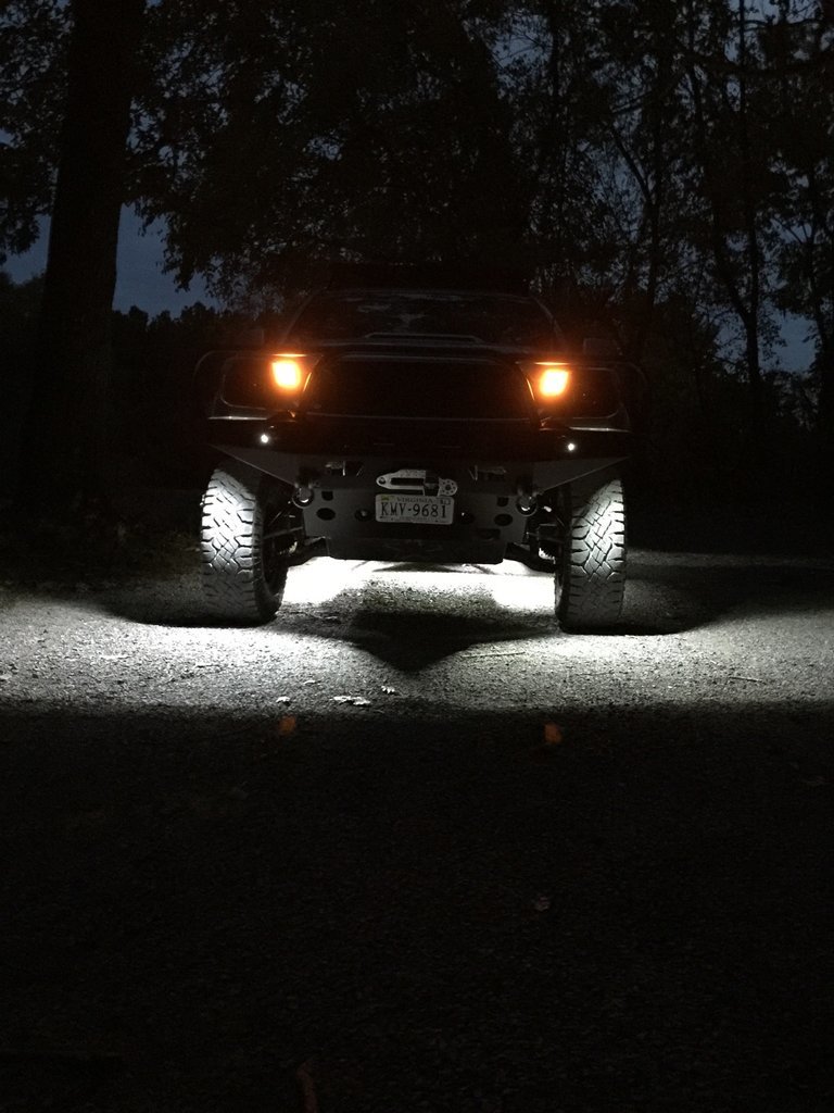

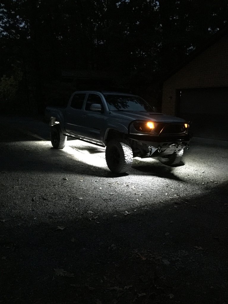

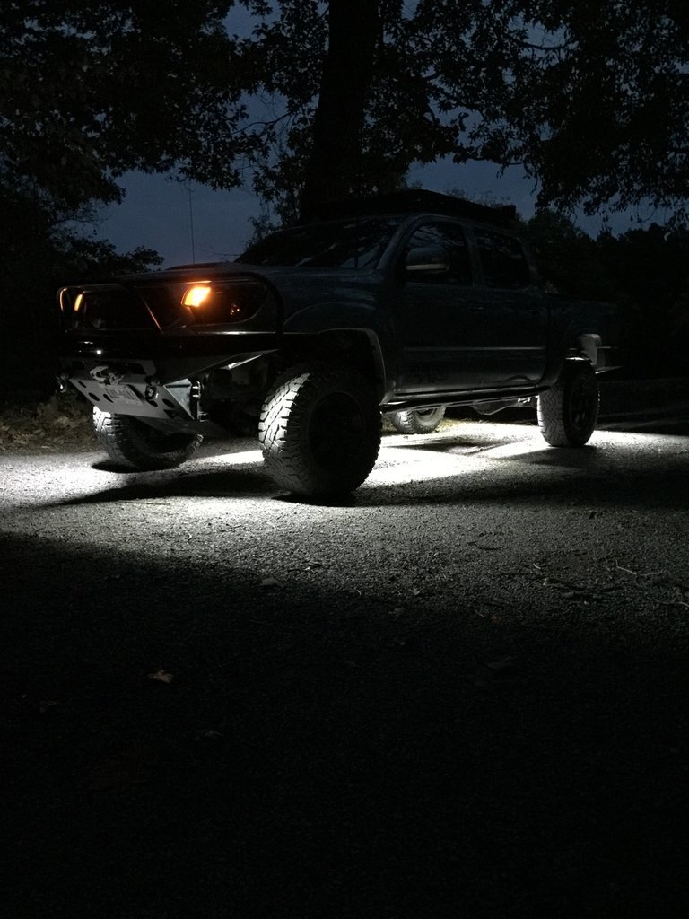

    And rock lights installed, may add one more but it looks pretty good how it is:

    I need this.

    Yea I really didn't know what I was expecting from them but they turned out better than I hoped, only issue is how strong these magnets are. I did some fast driving on washboard fire roads today and they stayed in place so I assume I'm good.

    Excellent. I have been looking forward doing to rock/camp lights for a while. How many did you use? They look bright. I have been going back and forth between those and the Wurton pods. I think I want to use a SPDT for use with the dome circuit too just not sure exactly how to do it yet.

    I used 11, you can get by with less considering how bright they are, really wasn't expecting that. 11 pulls around 6 Amps and I figured that may have been too much for the dome circuit so I didn't bother.

    Dome light is controlled by a switched ground. Just wire your SPDT with the light ground on the center pin, one pin tapped to the dome circuit and the other to the chassis.

    Makes sense, at the time of the install just wasn't sure of the amperage but I realize now it makes no difference due to the switched ground. I also didn't have an spdt switch handy :smack: I will eventually order one and do it. :thumbsup:
