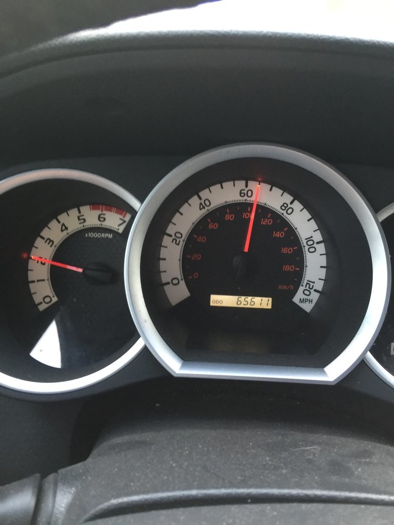

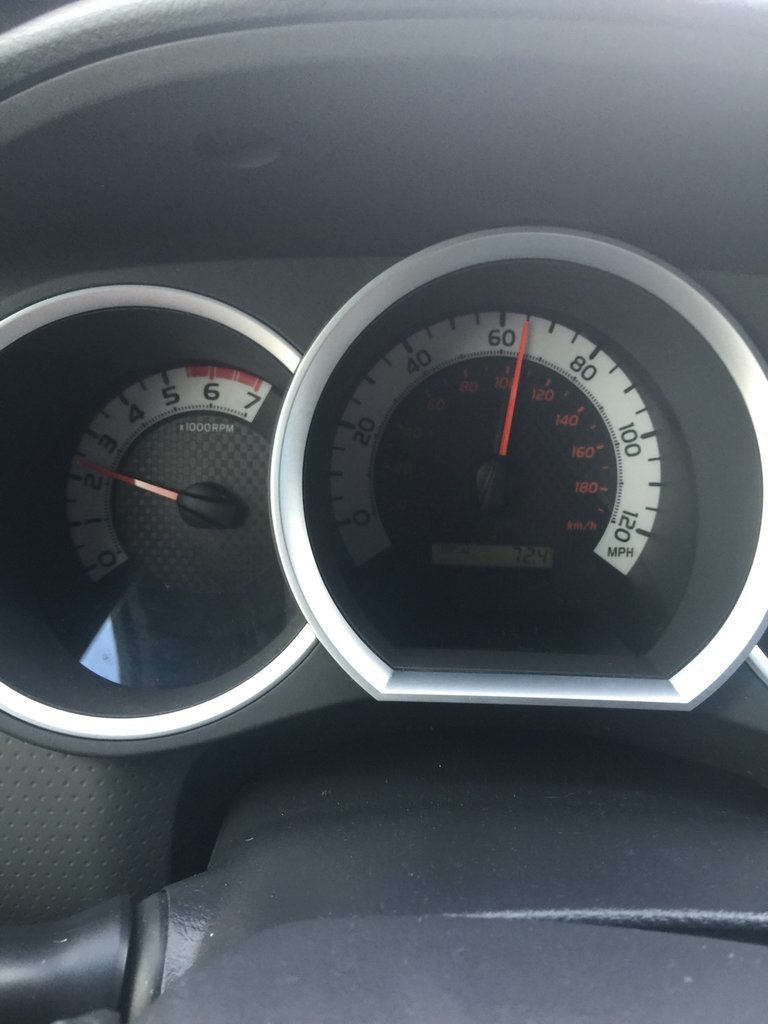

    And if anyone was wondering what RPMs were with new gears, I got before and after shots:
    Taken at 70mph via gps:
    34's and 3.73 gears:
    34's and 4.56 gears:

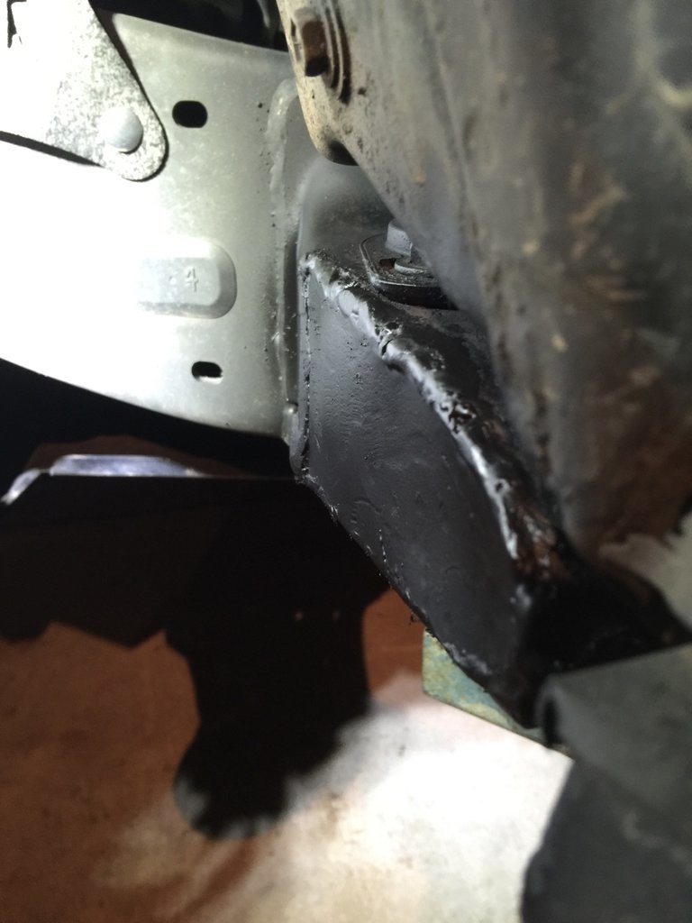

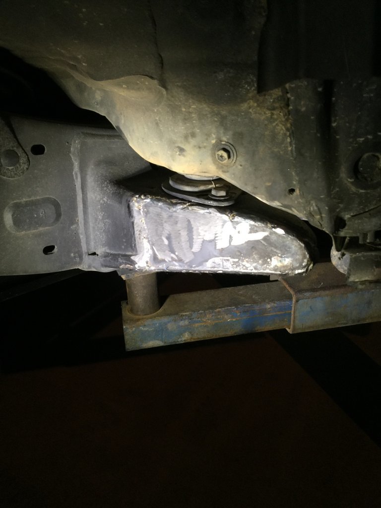

    Cut the drivers side cab mount back some more because rub:
