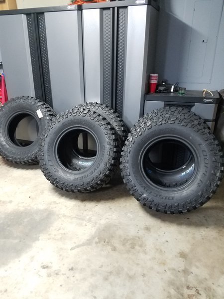

    Cooper stt pros in 315/70/17
    Sandman614, Acerwin and ChandlerDOOM like this.

    As much as i love the nittos theyre too wide with my shock relocation and 4" bs wheels

  20. Feb 22, 2017 at 4:58 PM
    #760
    TacoFMS
    TacoFMS Bubble bubble bubble pop
    Jan 24, 2010
    #29938
    7,996
    Justin
    Louisa County, VA
    Just a vehicle to take trash to the dump
    One or two things modded... Check out the build thread
    Hory sheet! Did you clean your garage?
