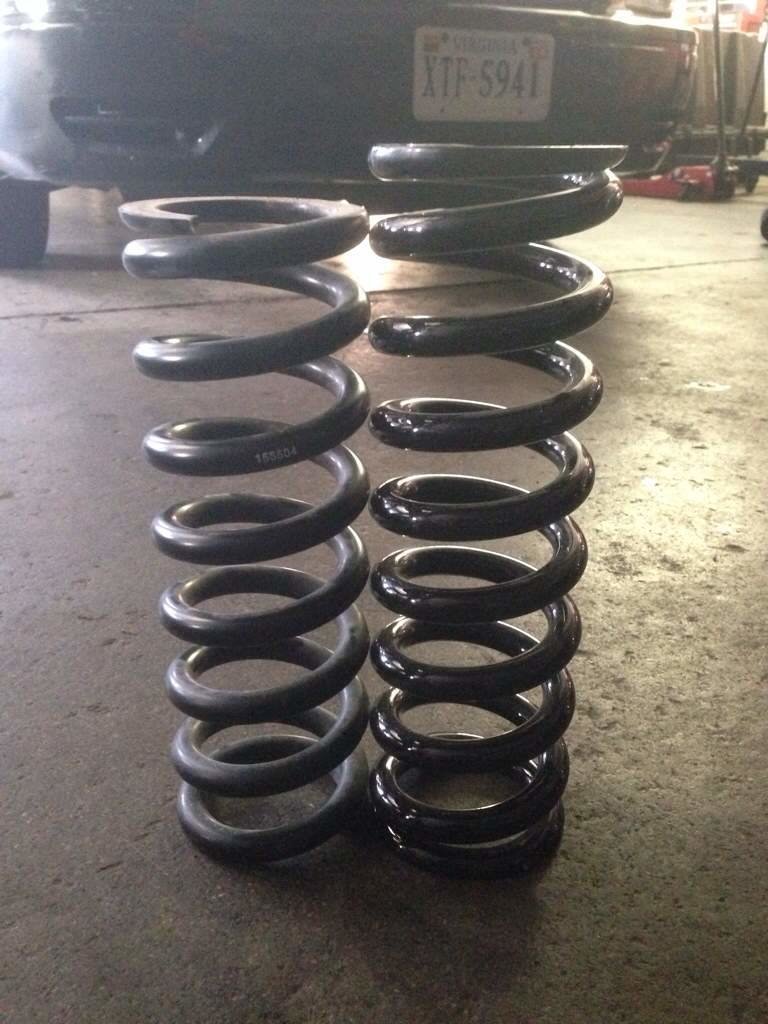

    A lot of Yeungling and Parkway Drive on the radio about to happen after supper while I add my D29XL add a leaf to the Dakar's, and then get some ride height measurements and pics, also on the 700# coils from Icon compared to 650#cause I have been meaning to get that on here.

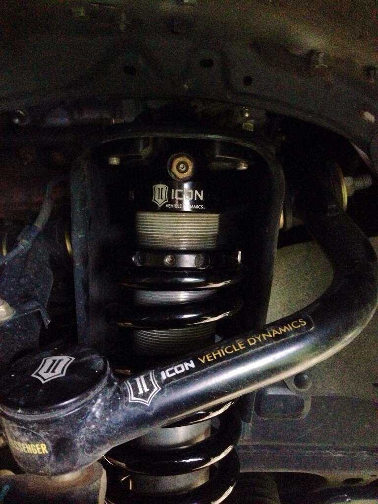

    Got the coils swapped, all pro ss brake lines didn't fit (they slide right through the bracket holes, not good) started storming pretty good so the rear dakar add a leaf will go in some other time:
    I need to take out some of that preload, more than I already have to get back to 23 1/2" up front

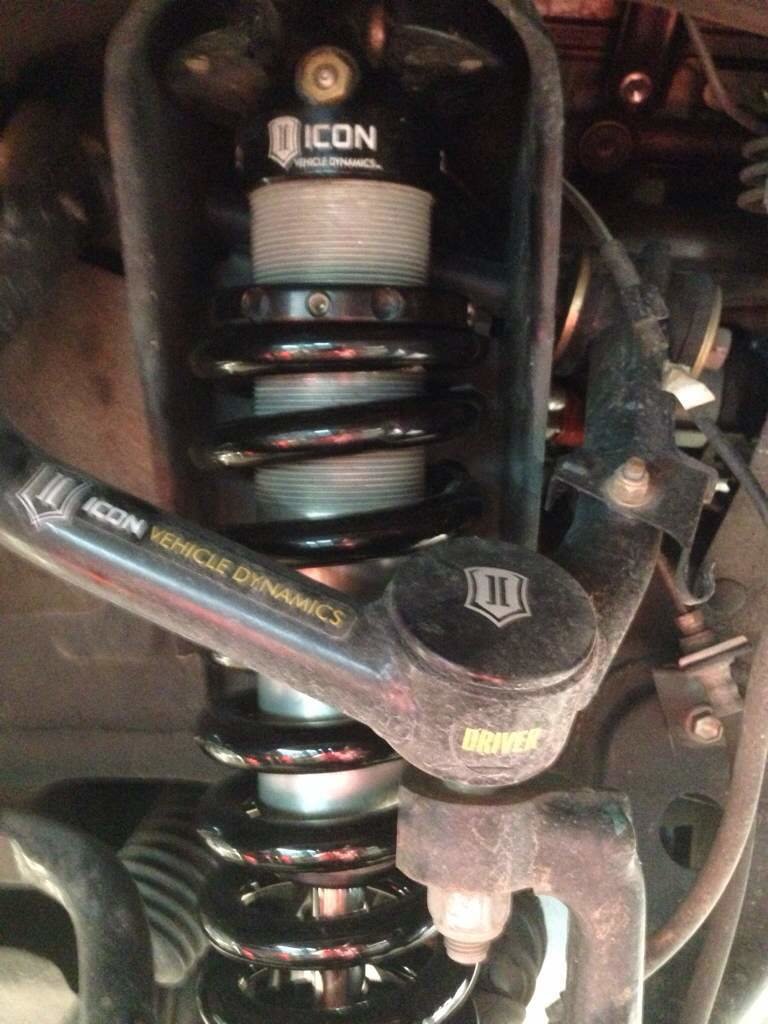

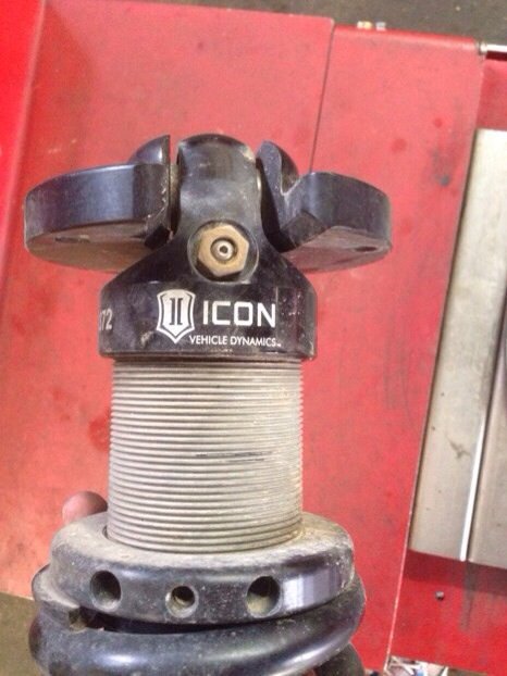

    Before at 23 1/2" with 650# coils (2" thread showing):
    Preload with 700# coils at 23 5/8" (1" thread showing):
    No noticeable ride difference with no extra weight in front.

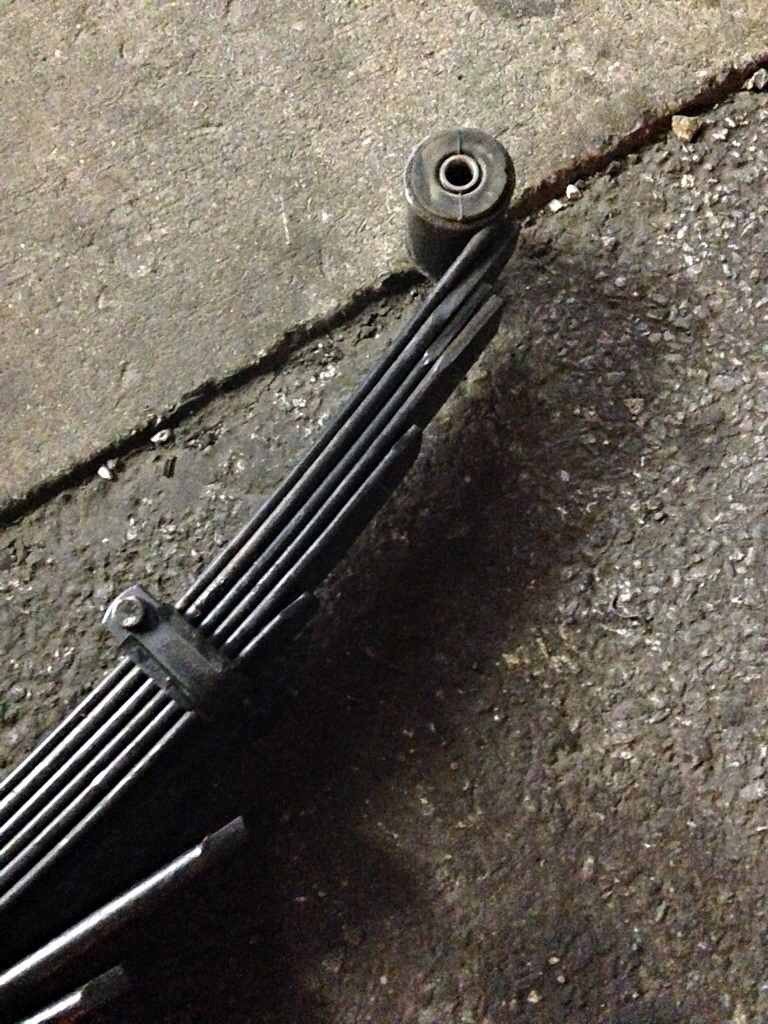

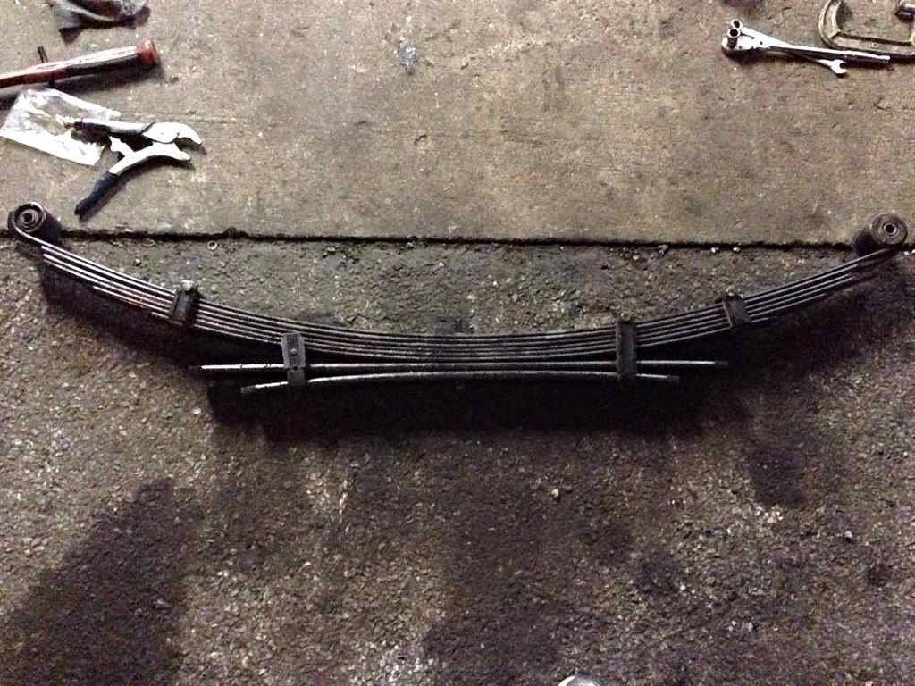

    Ugh, finally got those d29xl added to the dakars. Just a pain in the ass by yourself, took about 3 hours. Here's some pics when I thought about it:
    3rd leaf down. Gave me 3/4" lift in rear but I expect it to settle to 1/2" soon. No real difference in ride quality that I can tell with no added weight in rear.
