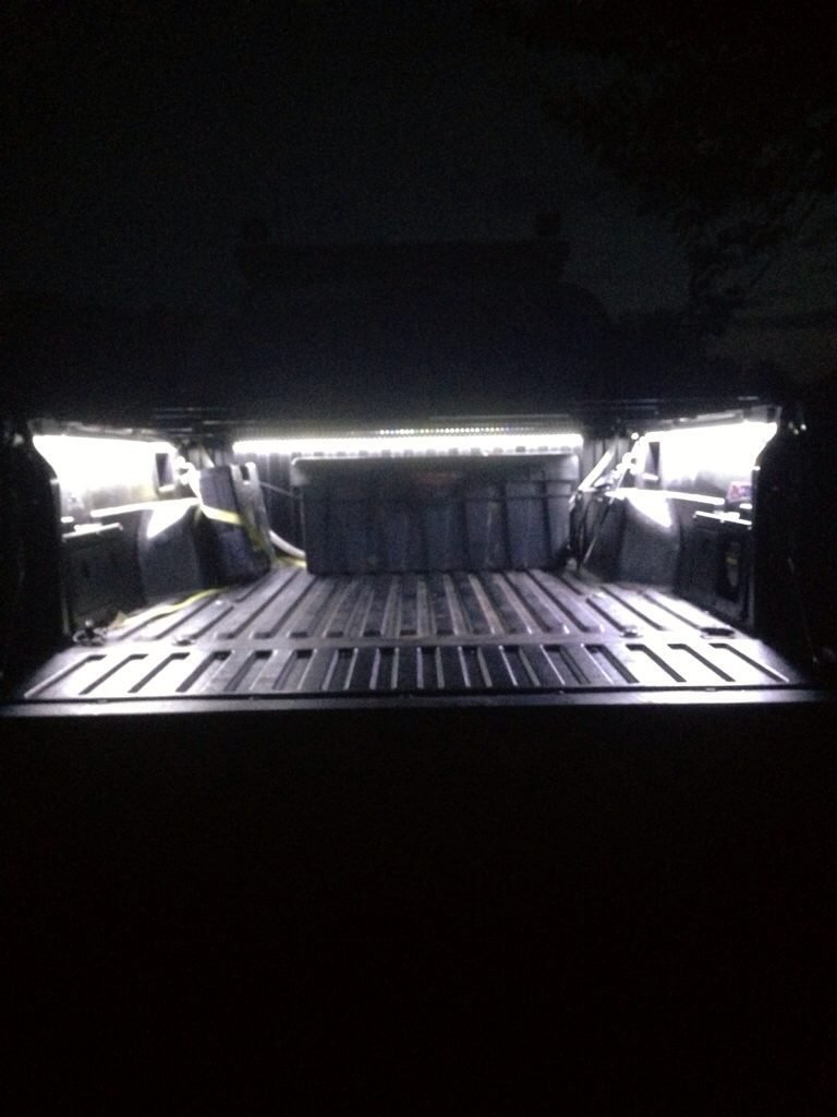

    Finally got a set of bed lights from mattgecko, love them, just waiting on darkness to check the lighting area!
    Edit: darkness has arrived
