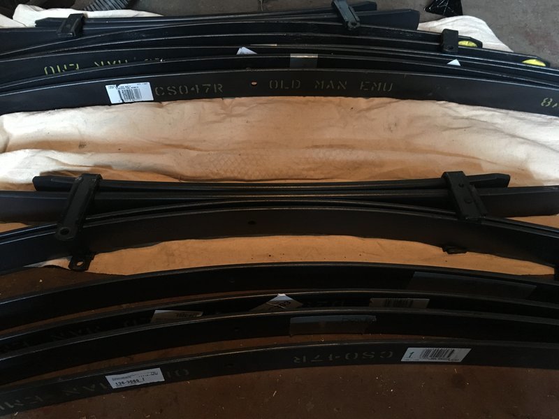

    All separated prepped up marked up.. It's drilling time tomorrow. I received "0" spec and "-" spec'd leafs.

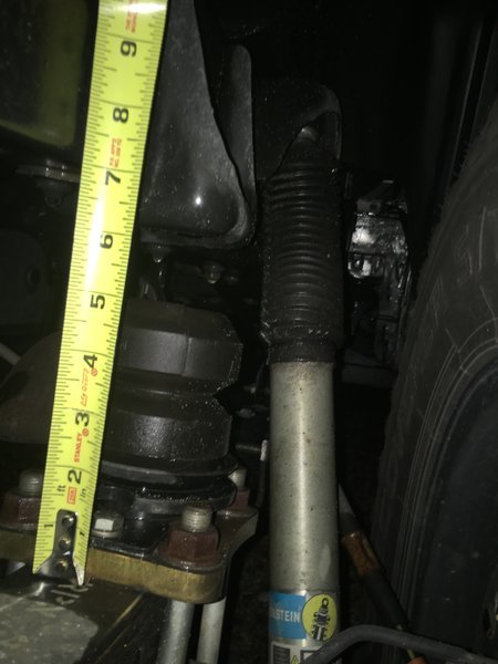

    I actually wanted to measure them about an hour ago but it's dark and raining here. I'll post up some measurements if you want. I'm fairly certain we could find a spec out in the internet somewhere.

    That would great....a pic is always awesome too!!

    Welp just struck out trying to get the holes drilled in the leafs at a local shop. The main mechanic just said it's a slow process and that it's $90 an hour blah blah. Essentially making it seem like it was going to run me $200.. Off to my next spot to try and get this done.
    Edit: Success! Not sure if the outcome cost wise yet but what a nightmare getting someone to consider it. I know that I at least have a handshake on not going over $90.00 to get the 12 holes drilled. Should be done by Friday.

    Here we go. With the U Bolt plate it sits roughly at 5" off the top leaf. I am still running my OEM 5100 Bilsteins. These colllapse somewhere around 14.5 and extend around 22.5... I'll get the official specs up but these are getting swapped out. I'll have to cycle the suspension at some point after I install the new leaf pack and the B110. I can say for sure that these Timbrens do not compress nearly as much as the super bumps from wheelers so now I'm actually considering leaving the D29XL out and dropping it in if need be in the future as my truck starts to ramp up to full overland mode.

    Thanks for the pic and info. I'm thinking about the super spring ssr610-40. I talked to a guy today at Timbren. They offered to special make a tortun4 kit with 3000 lb rubber instead of 6k. I've thought about finding some factory bump stops somewhere and put on a set of Bilstein 5100's since they are a progressive self-adjusting shock. Decisions decisions.
