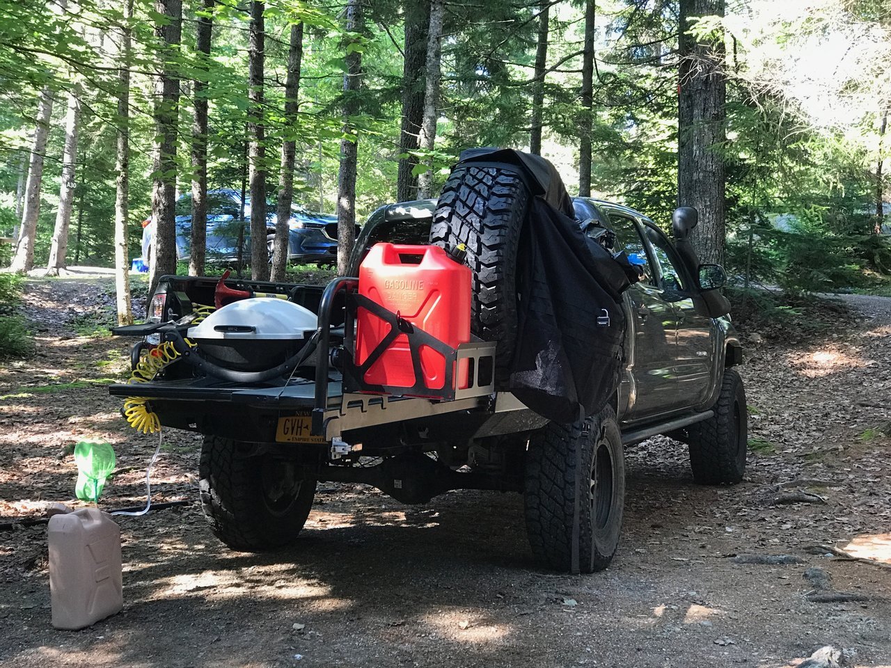

    Looks like you have a bedslide. Nice!

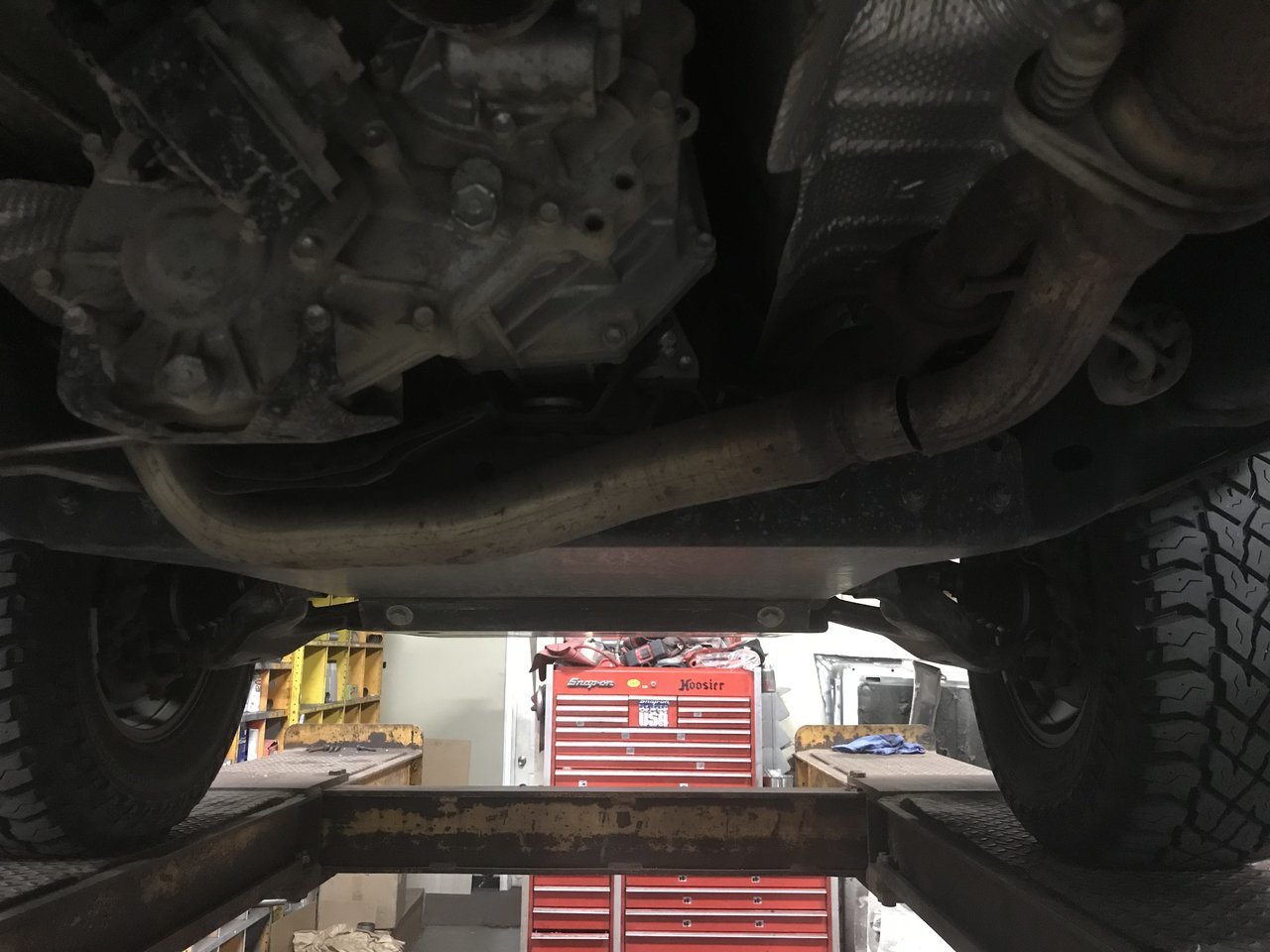

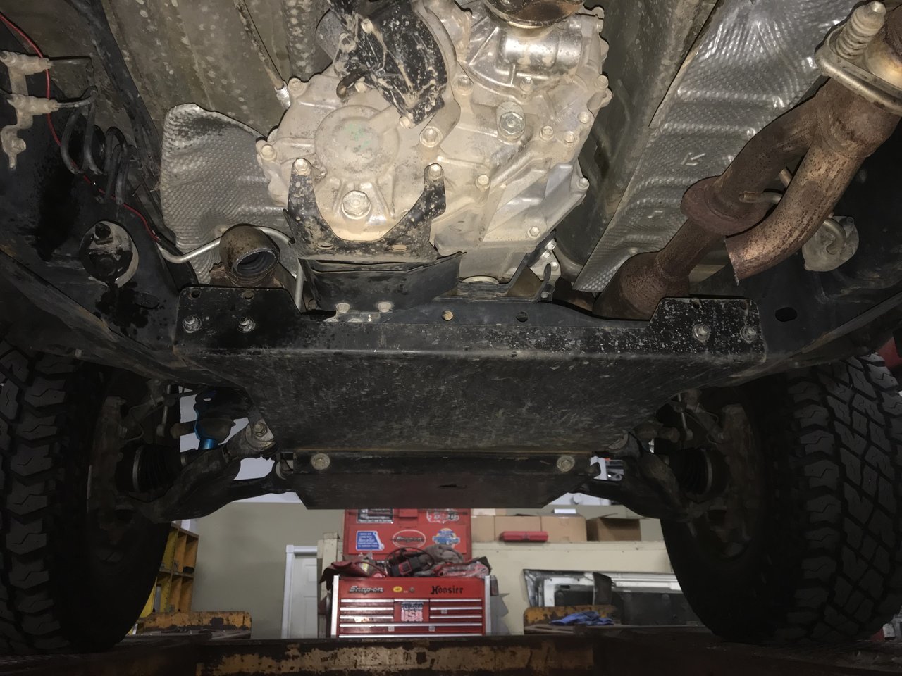

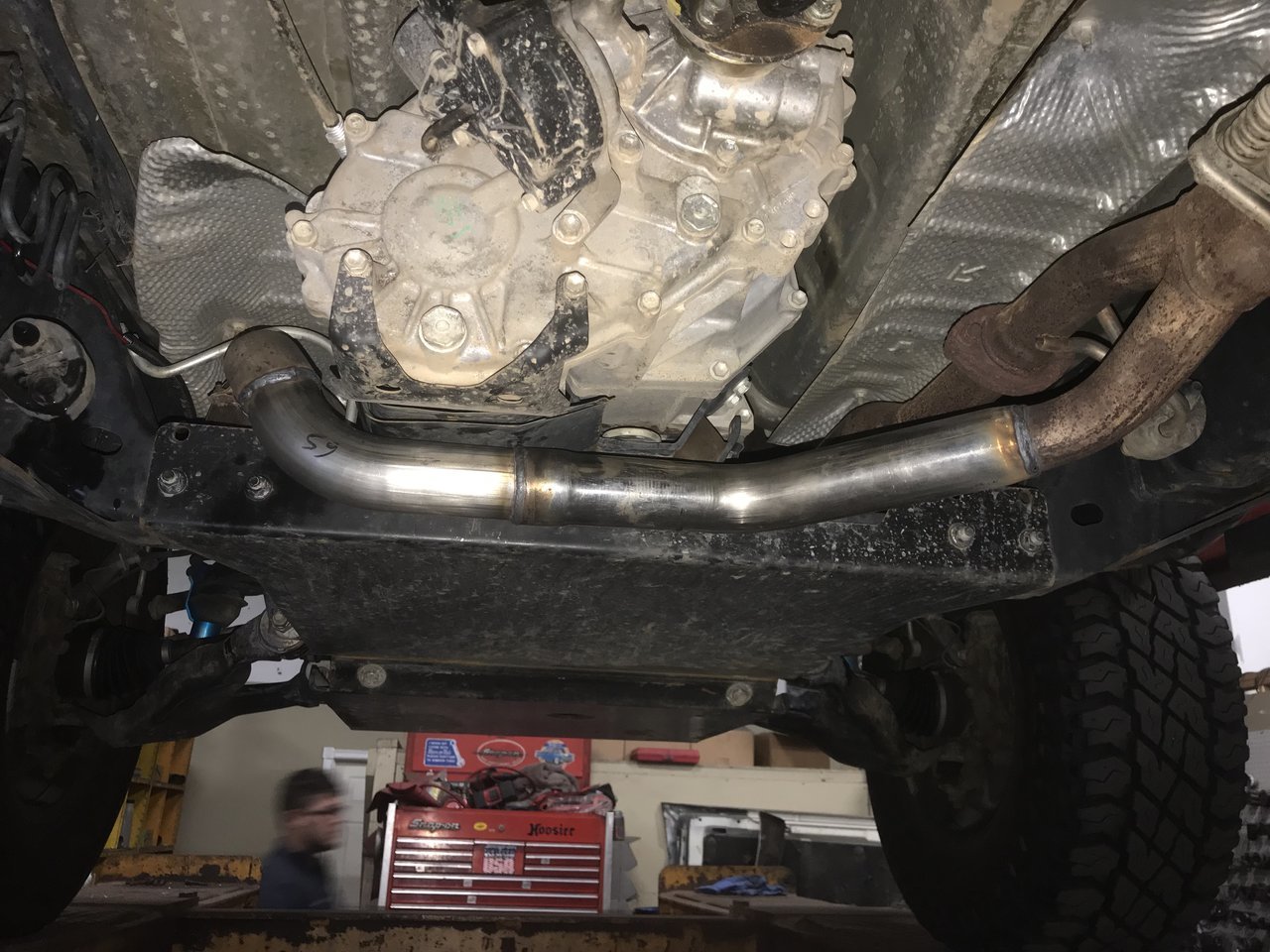

    Re-route af

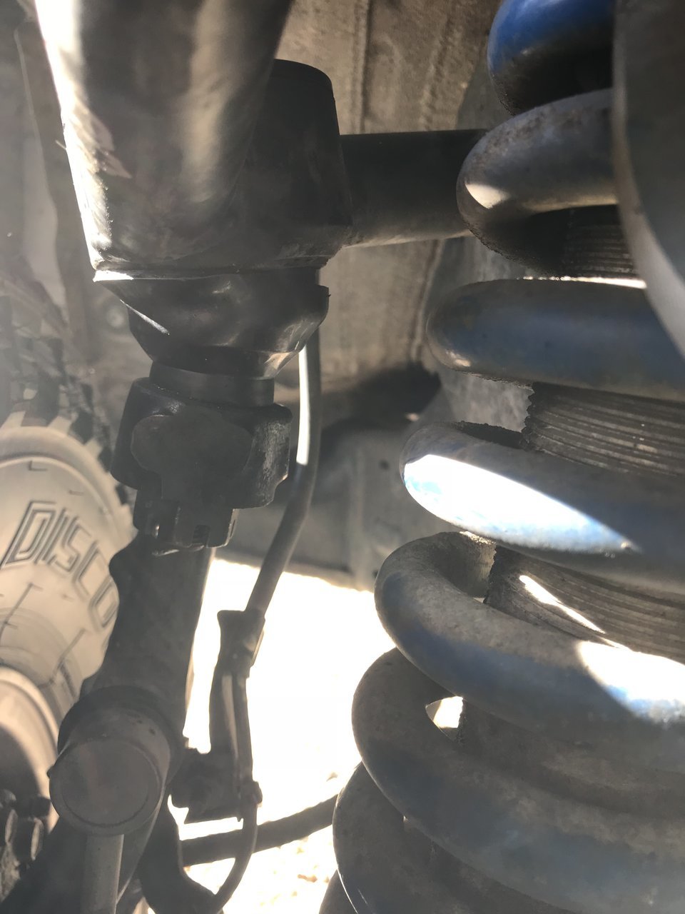

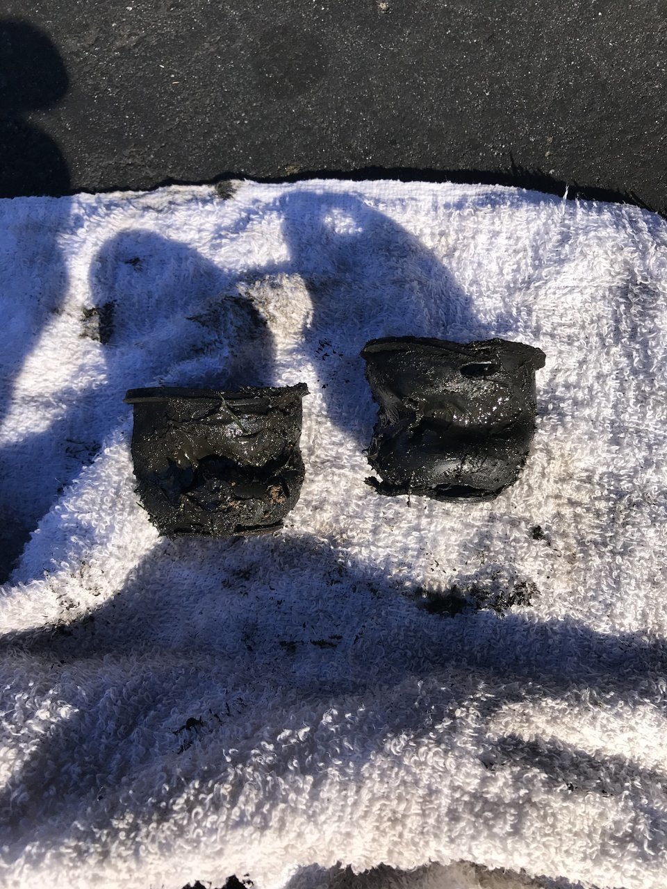

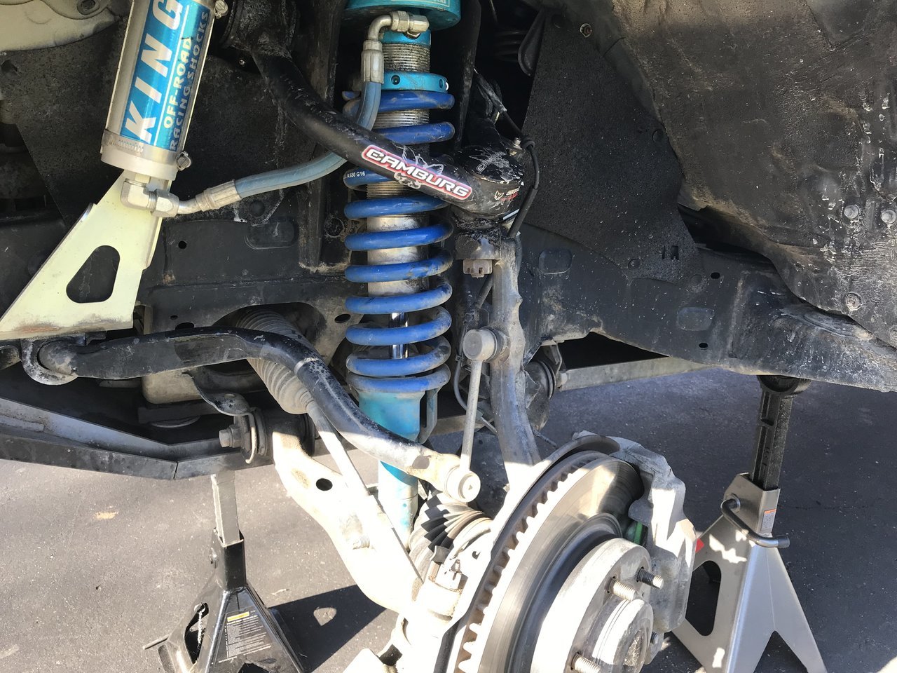

    Finally got around to changing these balljoint boots. These originals were littered with tears. $25 ball joint seperator from harbor freight was a tremendous help. Re-torqued my UCA bolts to 82 ft# also while I was at it. Fit and finish on the new boot is better actually after driving a few miles it settles in nicely. (After first installed I wasn’t to keen on how it would fit up).. I guess only time will will tell but anything is better at this point than what I had. Thanks again @motoxscott
