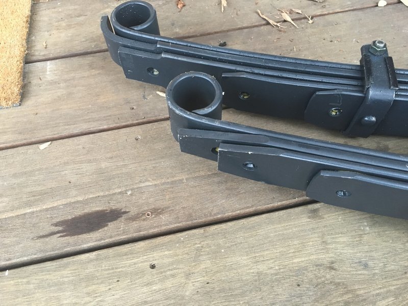

    It's official! @300AACTaco
    New ARB pack fully insulated and "+" on both. Looks like I'll be dropping out that Aal

    I'm also interested about the plus on both sides.
    Mine came with a - and o
    bski22[QUOTED][OP] likes this.

    Zero bro lean. 0 driver - passenger. Felt like it was a great set up. I think I added 1/4 with the insulators at the end but either way I sat dead even 25.5 on each side. The rating is based on the tolerance of the spring when it's tested. With the plus plus I'll have a little stiffer ride than say the 0/- that I have now but I can't imagine it being stiffer just due to the fact that I'm running the AAL. I have a feeling I'll be measuring up the same as I am now. Fingers crossed. Or I'll be dropping them and the AAL to get to the desired ride height.

    Basically one of the guidelines is to shoot for a 0/- or a +/0.
    Kind of curious to see how the +/+ turns out

    Awesome! Mine came "+" on both as well, haven't noticed a big difference if any!
