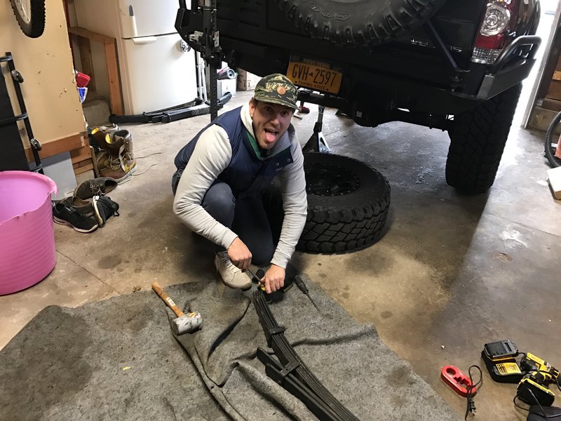

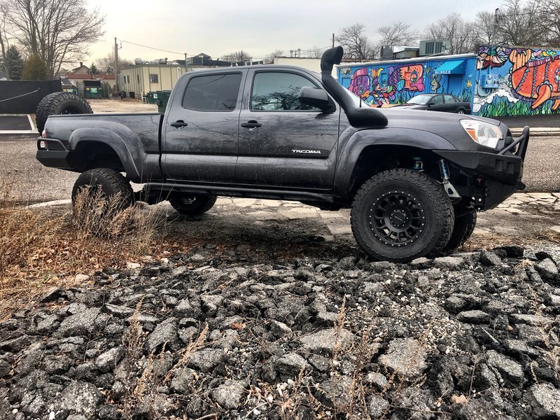

    Leaf spring swap.. again
    Slashaar likes this.
  12. Feb 5, 2017 at 1:53 PM
    #72
    bski22
    bski22 [OP] Shaka Zulu \000/
    Feb 14, 2016
    #178123
    6,775
    Rob
    Toyota
    Finished the install of the new Dakars. Few things that I noticed were the bushing eyelet is tighter and doesn't have the 45° cut at the end of the hole bend which essentially is making that hole more rounded out. The leaf pack braces seem to be taller on the back and front end a hair. I also had to remove one of the center pin dividers to get the bolt threaded all the way on after I added AAL as the center bolt only had about 3 threads showing. I super greased everything this time. All the bushings and the areas between the leafs that didn't have dividers. Feels much much more smooth now and no barn door creaking which lead me to believe the poly bushings were binding. I should have taken a picture of the leaf spring eyelet as one of the bushings actually started to get an indent. (I'll add pics where I think it was hanging up)... either way rear end feels and sounds completely different.. oh one more thing. Truck is pulling more to the right now. When I had the truck jacked up I had to move the axle to get the center bolt head into the axle both times by pushing the axle forward to get it lined up.
    Old eyelet
