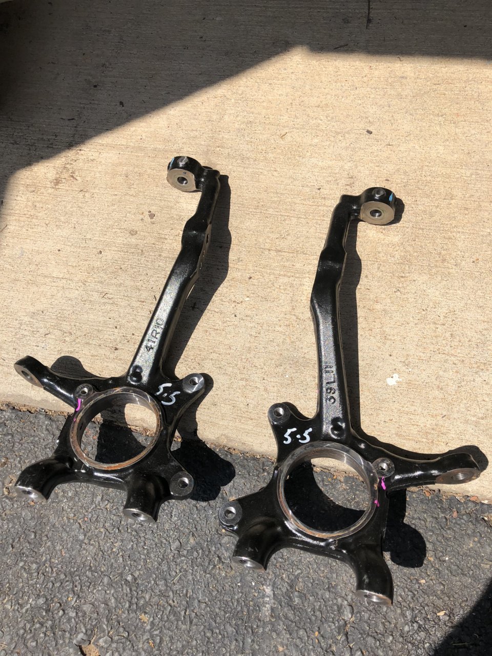

    Not saying you need you “need” spindle gussets or not. I got mine as insurance, like cam tabs, and skids. Better to have and not need...

    Just saying, i have pair of spindles for sale. You can get them welded and have no downtime. Brand new. Special price since I know you

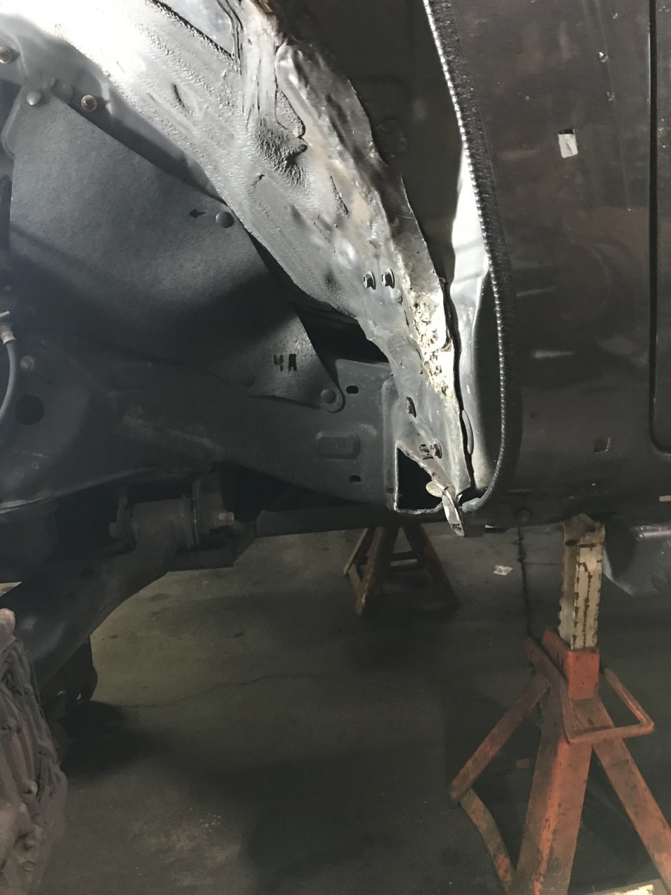

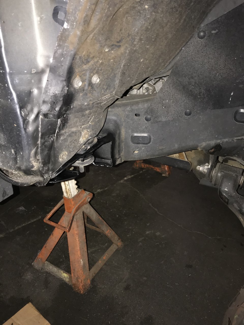

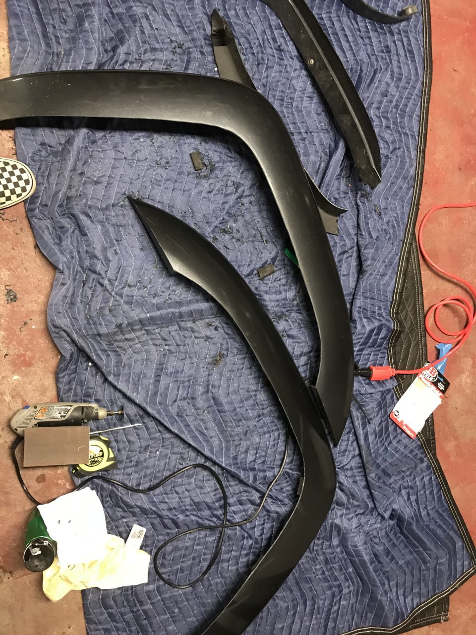

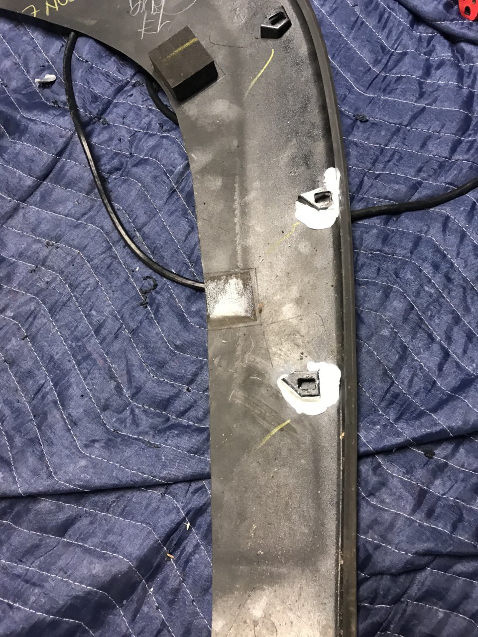

    Ready for action. All trimmed up took 2” off the flares should just cover the lip of the cut fenders. JB welded the tabs on th back for extra strength

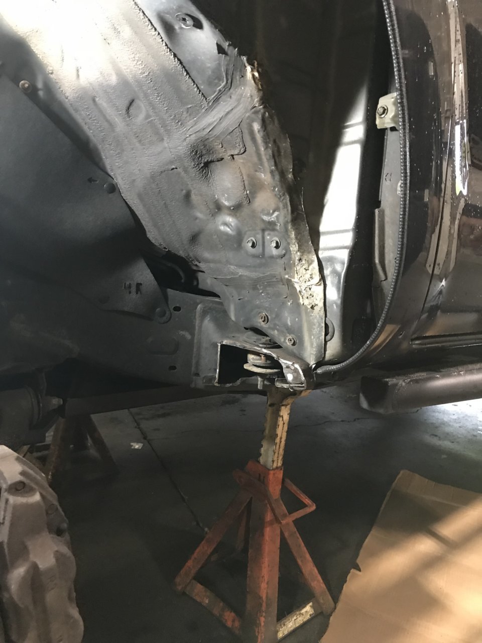

    Did you do any firewall hammering?

    Very slightly. I’m going to cycle to figure that out
    EatSleepTacos[QUOTED] likes this.

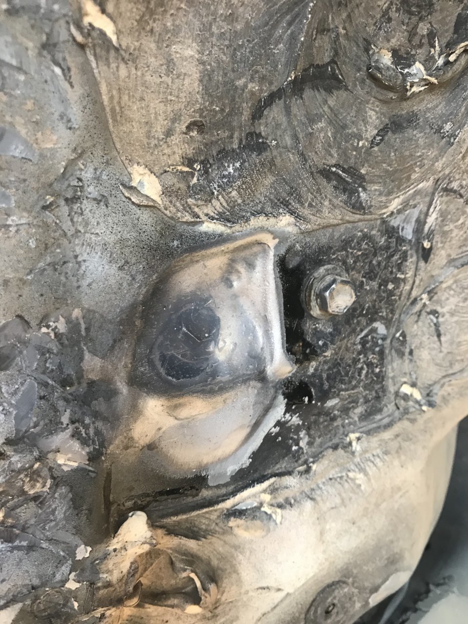

    What’s the deal with those bolts... I want to take em out

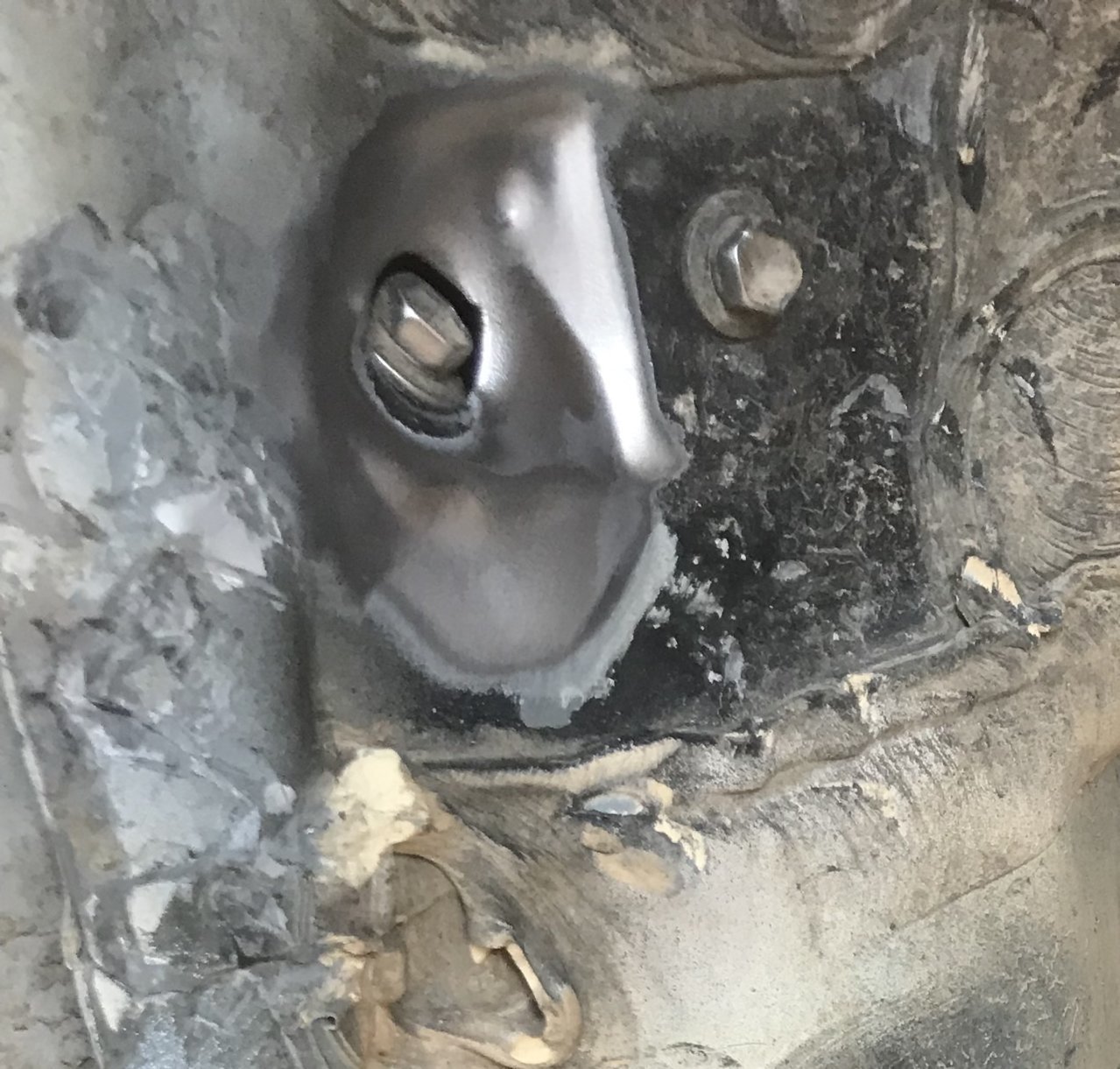

    I have no idea. I just gently hammered around them and pushed them back. I wanna say someone pulled out the trim in the cab and saw that they went to nowhere. Would be worth checking.
    If they are useless, I’d pull them and fill with silicone. I was rubbing on them before I started hammering.
    One final tip is if you leave them in and start hammering, be cautious. I managed to punch one through from going too hard. Cleaned up the area with a wire wheel and siliconed and haven’t had any issues.

    Might get some Sika seal and remove
