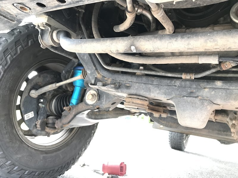

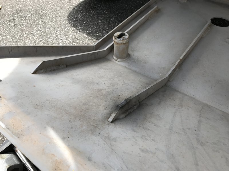

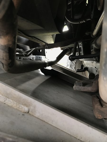

    Let the light shine through. Figured out what was making all that racket.
    Sway Bar Probelms
    Slashaar, fatfurious2 and ChadsPride like this.

    My gut's telling me something's not right. That swaybar should've cleared. Are those RCI skids?

    They are mobtown. I have swaybar relocate which is pushing the sb down. Technically it should clear but yea I don't know

    Never heard of someone relocating a sway bar so we didn't take that into account when we added the reinforcements. We designed it off the stock truck with and without a diff drop.

    @bski22 - did you just grind off some of that center support rib to clear the Swaybar and it fixed issue?

    Yes and yes just grinded down about a 1/4" of the reinforcement and about 2" back from the front of the reinforcement. My blings (kings) require the sway relocate so they don't smash against each other

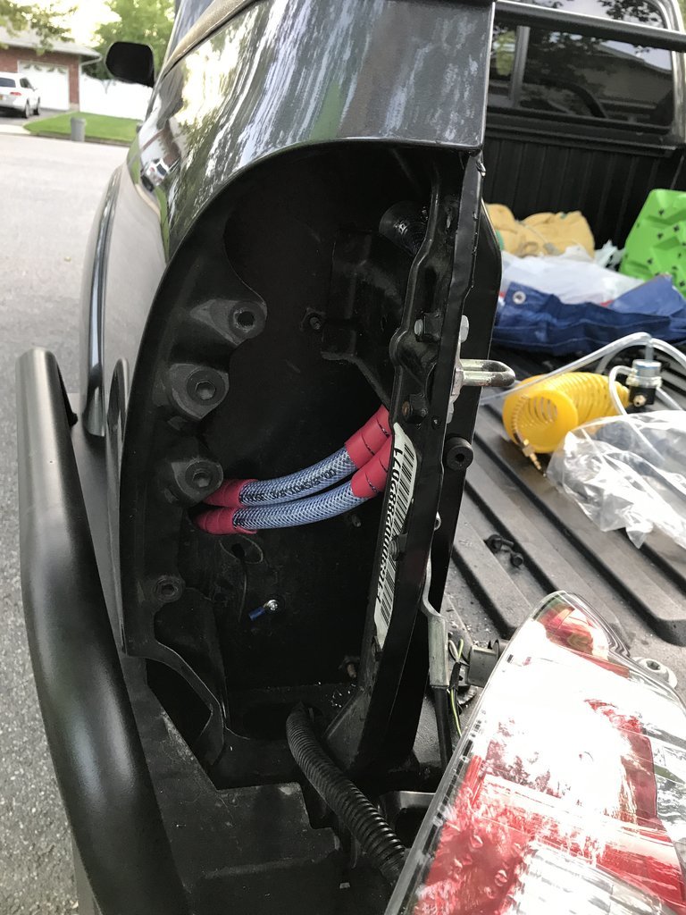

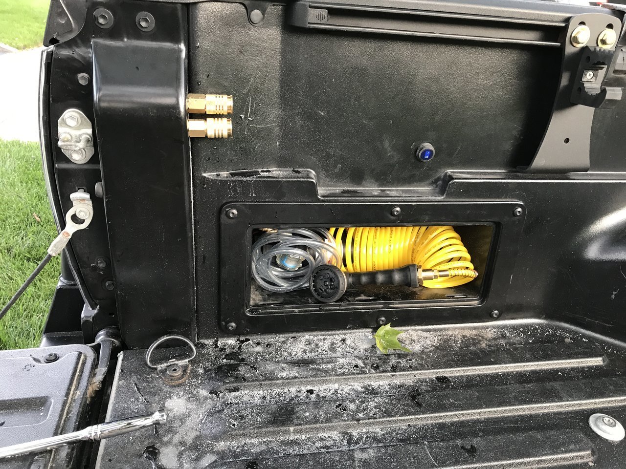

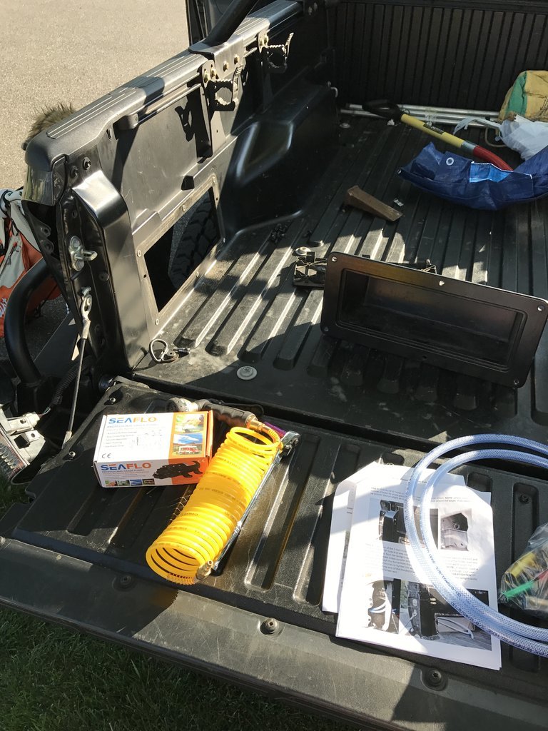

    Pressurized Water anyone?
    Slashaar likes this.

    Where's the tank?

    Any portable tank will do just fine. The connectors are for in (bottom/connect clear hose and drop into water tank) and out (top). I have a 5 gallon tank for water I'm going to carry.
