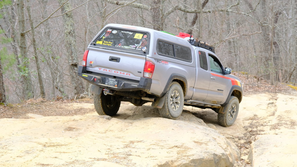

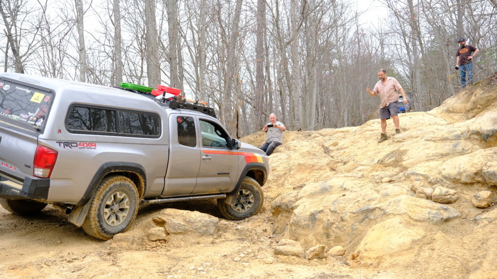

    I don't know if I should say anything, but I have a 4WP bumper. The reason I say that is the bumper was discontinued/closed out in Dec of '23 and is no longer available. That's a pity, because it's a great bumper. The finish is really good, the clearance is very good (even though you still have the stock hitch receiver) and the BSM sensors work perfectly.
    Been in some interesting spots and haven't touched anything but the hitch skid...and lightly at that.
