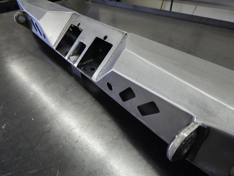

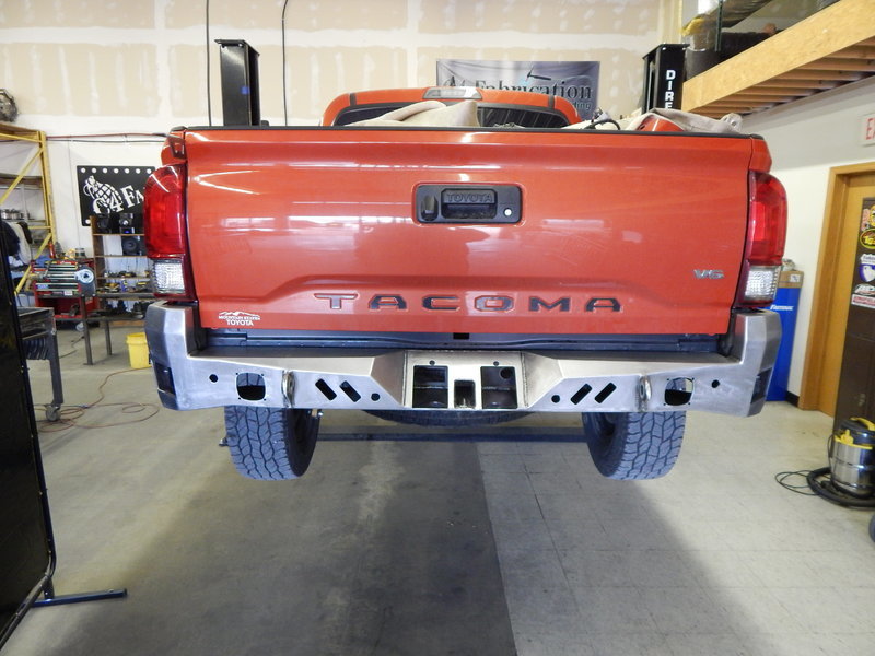

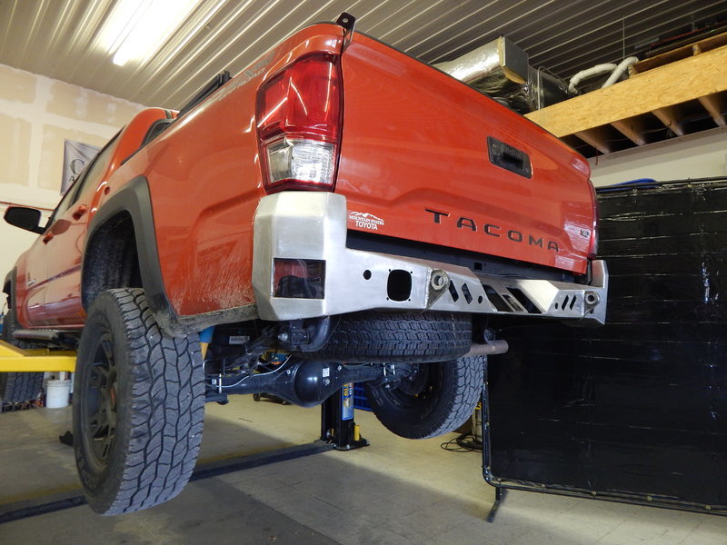

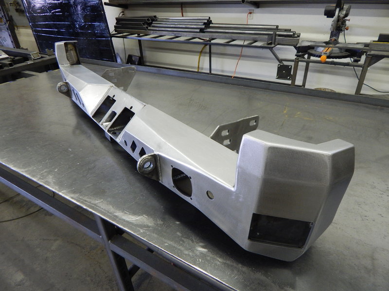

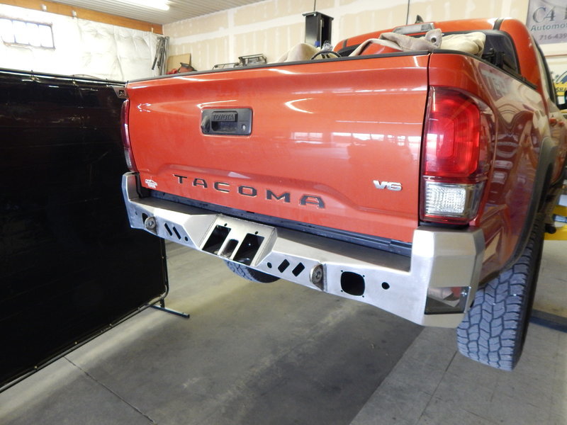

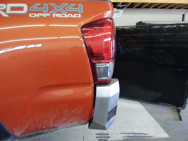

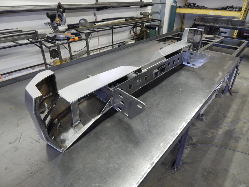

    Here are some pics of the bumper finish welded and sanded before it went to powder coat yesterday. We are really liking how it turned out! Right now there is clear lexan Panels attached inside the bumper where the BSM sensor cutouts are. They will be painted black to match the powder coat during final install.

    Any plans to reuse the OEM license plate lights in this bumper? Just realized there are no cutouts for those. Would also be great to have some optional bracket that would put the license plate into a vertical position. (Rear plates have to be vertical, oriented horizontally, and lit up w/ lights to be legal here.)

    Will this have a spring-loaded hinge for mounting the license to, or will you have to get out tools to hook up a trailer?

    We will be sending a sticky back LED strip light that sticks to the bottom of the tailgate which will be used as the license plate light. We do not have an option for mounting the plate 100% vertical. That may be something we need to come up with if we have quite a few people that need it.
    The bumper in the pics is on a local customer's truck. He will be testing out everything to make sure the BSM system all works properly.
    Yes we are excited to see it as well!
    No tools needed. The license plate will be mounted on hinges at the top so you can flip it up when you want to use a receiver. Otherwise gravity keeps the plate sitting in the normal position.

    Will this still carry over the full 6400 lb tow rating I currently have?

    The bumper has not been officially rated and we do not have a way to do that, but the bumper is designed with 1/4" plate all boxed in from the frame mounting points to the hitch. There "Shouldn't" be any issues towing the same amount of weight, but like I stated, it has not been officially tested.
