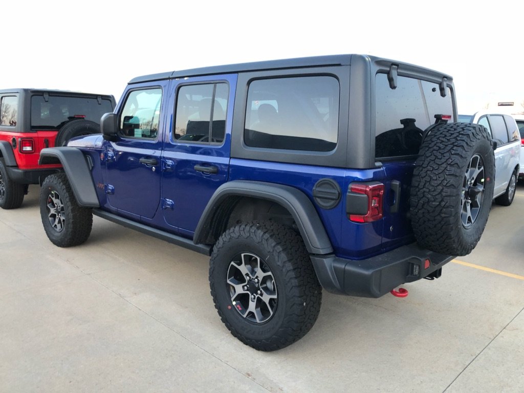

    Would be nice if Toyota threw the BSM sensors into the tail lights like on the new JL. IMG_14681.jpg

    that would make it a lot easier!
