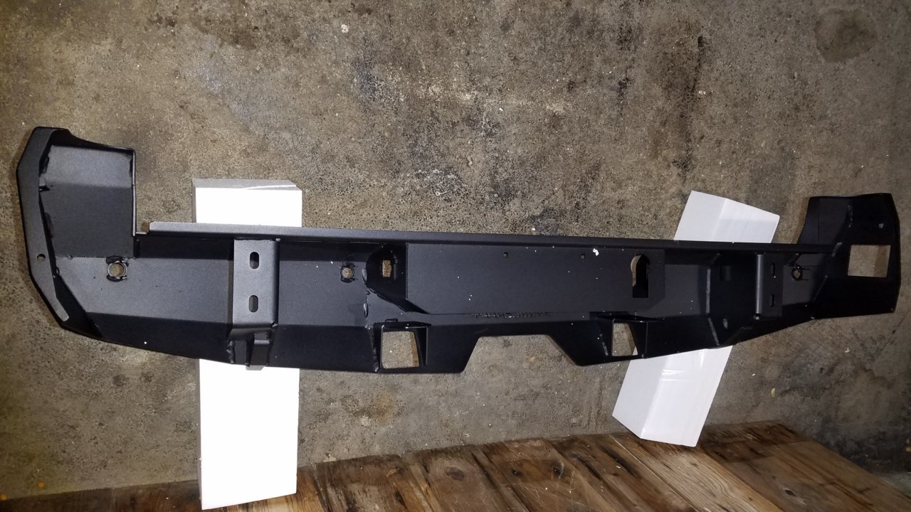

    I'm not really thrilled about being the Guinea pig, but oh well, I'm sure I'll find someone to take it off my hands if it looks like a diaper. :rofl:
    It was only $570, compared to the $2,373.96 bumper at Apogee (6 ga steel vs 7 ga, they were even going to charge me extra to make "flat" BSM covers, and, I don't think that's a good spot for a step because you'll end up kicking the 1k+ BSM monitor each time you use it) :eek:

    Thats a good looking bumper and can’t wait to see photos of it on your truck!
    RyanDCLB[QUOTED] likes this.

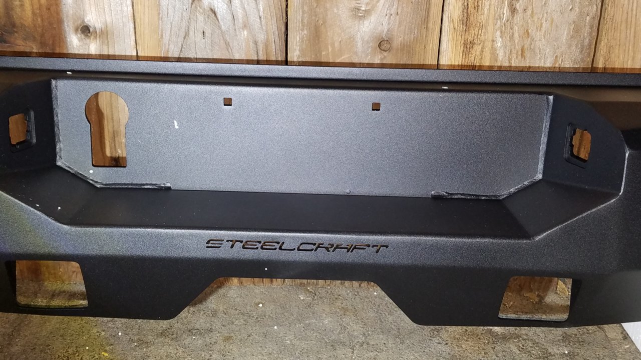

    The steelcraft bumper looks like it would "work" but won't give the full range of sensing like the OEM position. The Steelcraft bump looks like it senses purely from the side of the vehicle but not the rear angle as another vehicle approaches so it will be a delayed notification and not provide sensing as originally designed.

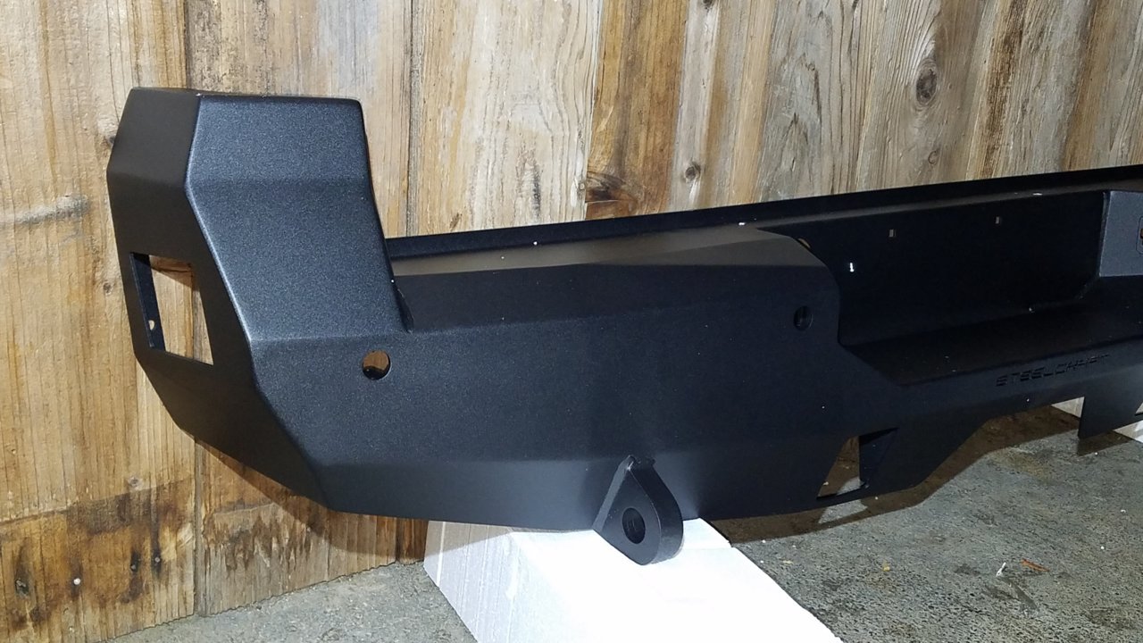

    It's still sitting on my sawhorses. I really want to install it, but I'm also tempted to cut the bottom skirt, where the backup lights go, and leave the D-ring anchor points as drag bars. I'll take pictures of it mounted up in stock form before chopping it up. My only excuse is the holidays came around. Maybe I'll get to it this weekend. It's on the "to do list".

    I had the same thought. It's a bit bulky. Eager to see how it comes out.
