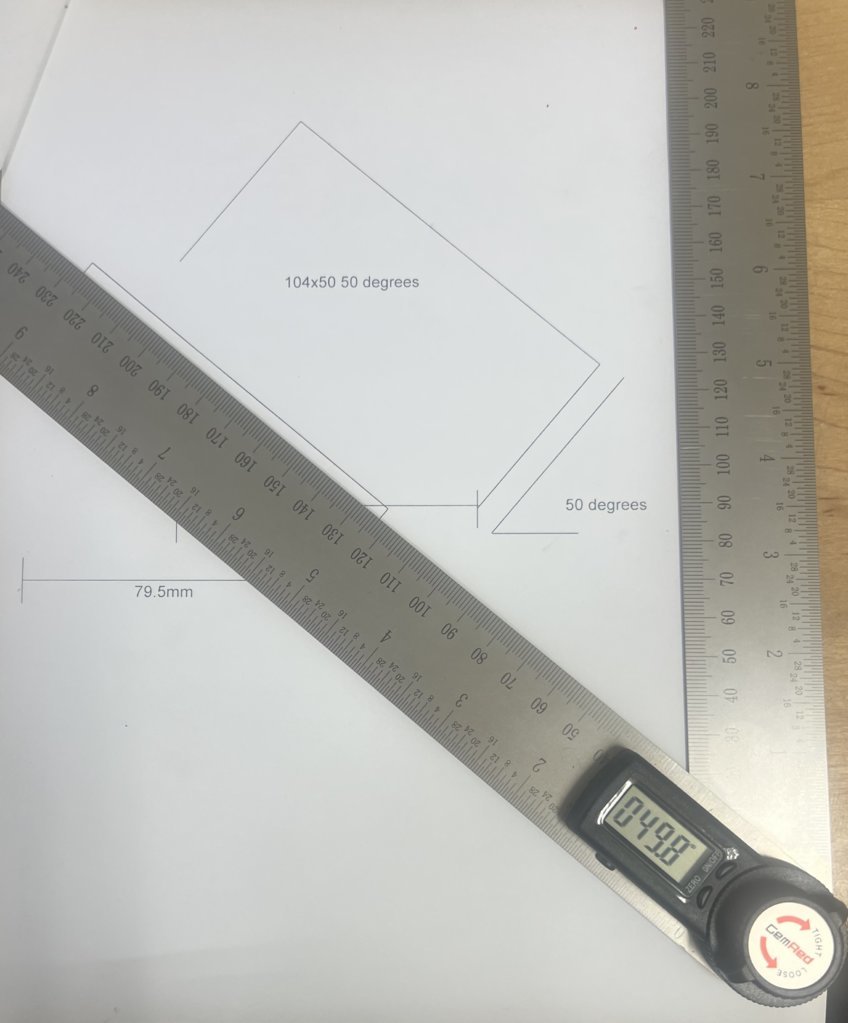

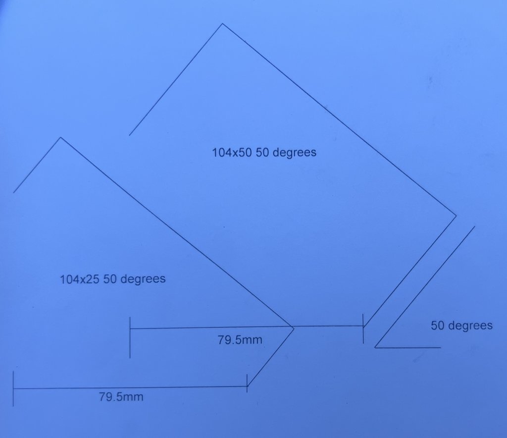

    I concur, at least from what I can determine from the Rago website pictures and installation instructions. The proper measurement is 40 degrees from the rear or 50 degrees from the side. Five degrees off from a 45-degree angle, with it angled more towards the rear.
    The last page of the Toyota instructions linked above in post #10 shows a misleading diagram unless you draw out what they show. Perhaps the bumper manufacturer followed that diagram. Looks to me like they might have. I will attach a few pictures of a diagram I drew from page 8 of the instructions showing quite a different angle.
    The first picture is of two different stud lengths (25MM and 50MM) I did this to prove to myself the stud lengths made no difference to the angles calculated/drawn. Page 8 of the instructions say nothing about stud length, yet they are referenced. Drawn out shows quite a different angle than the Toyota BSM Alignment procedure.
    OP, I am not doing this just for you, but for myself as well, one day I will be fabricating my own bumper and need to know all these angles. This type of inquiry helps me learn.
    The second picture shows the 50 degrees from the side measurement.
