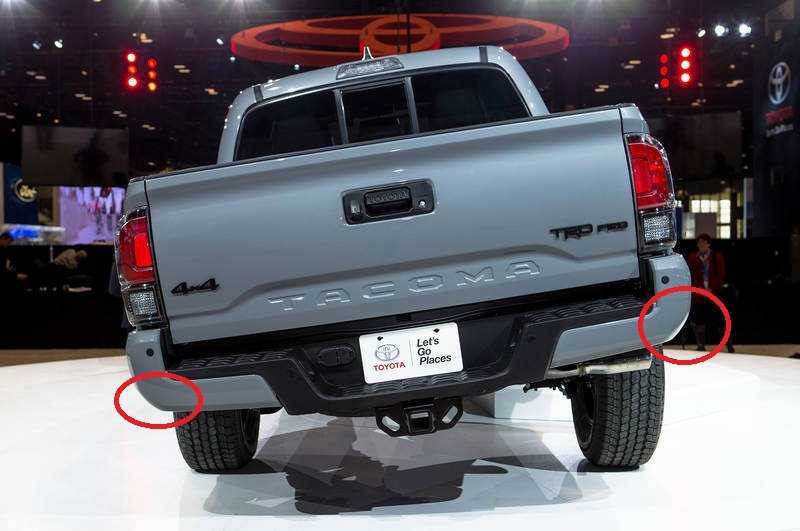

    I most certainly do as well as cross traffic, but no rear parking sonar so was just curious

    ...and how can you tell that from the picture? They are hidden under the plastic caps. Maybe your thinking of proximity sensors?

    Are the bsm, cross traffic and proximity the same sensor location?

    Anyone got a pic that shows the sensors?

    My rear bumper has 4 little circles which are the Sensors, was part of the Premium and Tech Package.

    Thats what i mean. I see an outline but no cutout but i assure you i have bsm and cross traffic but no sonar

    They are under each plastic corner cap on each side and consist of a slave and master. They actually point out the sides and slightly back. Be careful backing up. Striking the corner bumper could be expensive and requires an adjustment procedure using Techstream when changing out a new sensor which can be expensive.

    Those have nothing to do with BSM.

    Im guessing rear proximity since i dont have those cutouts or rear proximity

    Those little black circles is what I was thinking of but apparently that is not correct.

    They did an alignment on the sensors and that fixed the bsm error, now I don't know how they would go out of alignment, sounds like it was fixed thru software.

    Misalignment can happen if the bumper gets a banged into. Don't quote me on this but I think if it's out more than 5° it will throw an error code. Yes your right, alignment is done by software adjustment. There is a reflector target that's put in specific location that the sensor reads then calibrated to the target position.
