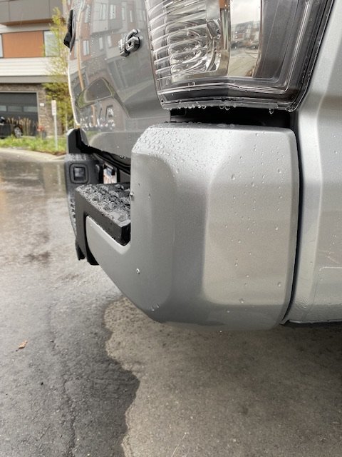

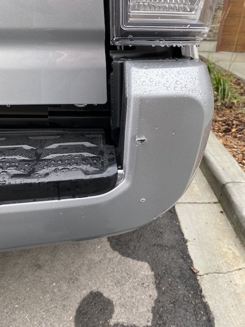

    Couple days ago I came back to my truck in a parking lot, noticed minor damage to the rear bumper (R side).

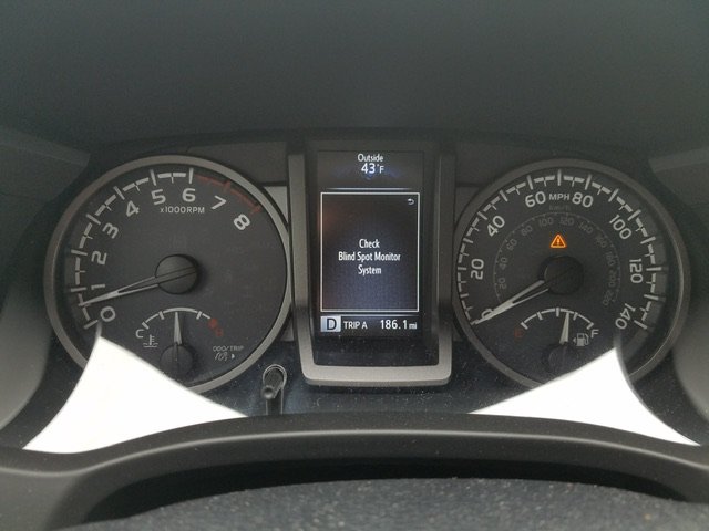

    Seems to have been bent and pushed in a bit with the plastic and metal frame under the bumper step. Everything was fine otherwise at that point. BSM operated as it should. Took it to the car wash and after driving a couple clicks “Check Blind Spot Monitor System” comes up on the dash. I turn the BSM button off and on again. Same issue. Figured the parking lot hit-and-run knocked the sensor out of alignment.

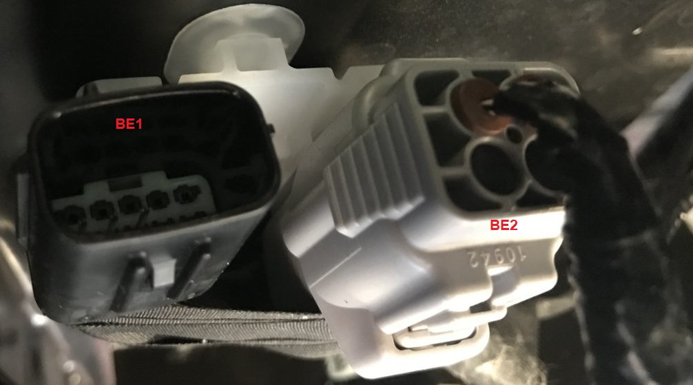

  7. Oct 6, 2023 at 5:59 PM
    caribe makaira
    caribe makaira Well-Known Member
    Feb 13, 2011
    #51121
    11,724
    Caribbean, Puerto Rico
    05 PreRunner TRD Offroad AutoTrans
    Hood Struts, My version Fogs always ON, Map & Overhead Light Mod,
    BE1 is the male connector coming from the vehicle to bumper.
    This is what Toyota does for the no-gadgets at bumper version...they leave exposed.:mad:
    arthfader[OP] likes this.
  8. Oct 7, 2023 at 10:36 AM
    arthfader
    arthfader [OP] New Member
    Oct 6, 2023
    #434951
    2
    Arthur
    2023 Silver Tacoma TRD OR
    Appreciate all the replies! I managed to get the side mirror light turned off by disconnecting the BE1 connector behind the bumper.
    Not gonna touch that damn BSM button anymore and I’m glad I’m removing that entire system for a steel bumper.
    I was also looking for something to plug it off so really appreciate the link! For now electrical tape will do.
    Also great idea to claim out the damage to pay off the steel bumper.
    Thanks guys :drunk:
