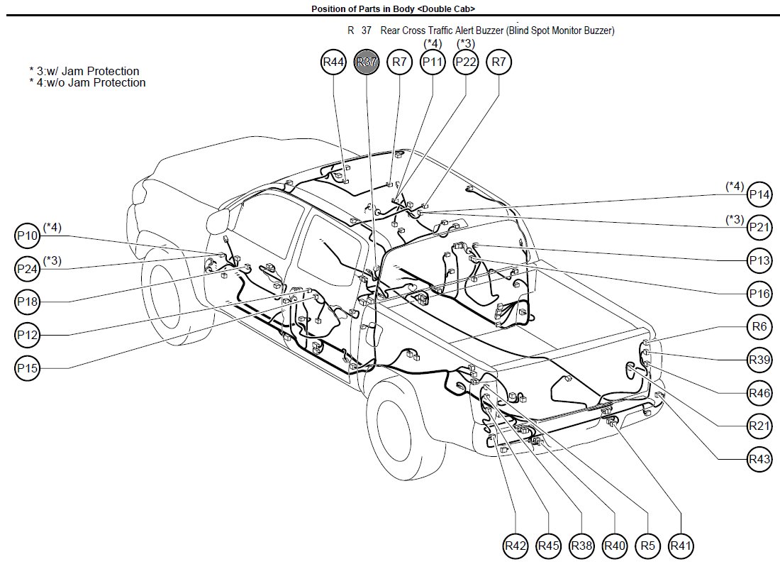

    The Blind Spot Monitor System does not have a relay in the harness anywhere in the Cab.
    It does have a buzzer:

    What would cause that to click/make noise? Sounds just like a relay clicking.

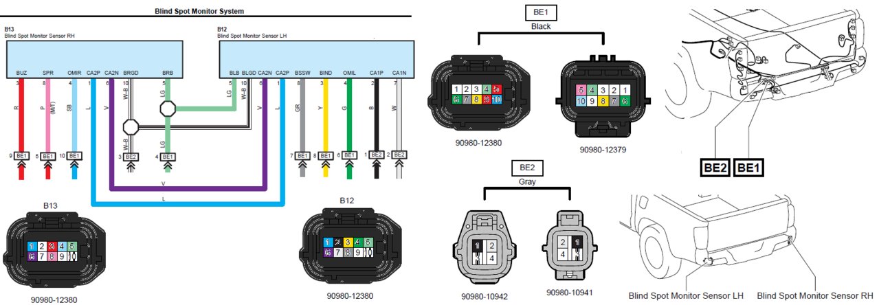

    Is there a diagram of how the harness runs where I could potentially check each connection?

    caribe makaira Well-Known Member
    Feb 13, 2011
    #51121
    11,787
    Caribbean, Puerto Rico
    05 PreRunner TRD Offroad AutoTrans
    Hood Struts, My version Fogs always ON, Map & Overhead Light Mod,
    TacoBuffet likes this.
