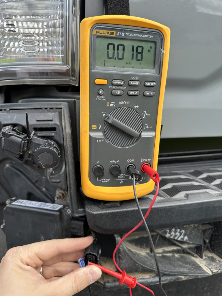

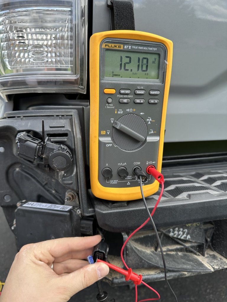

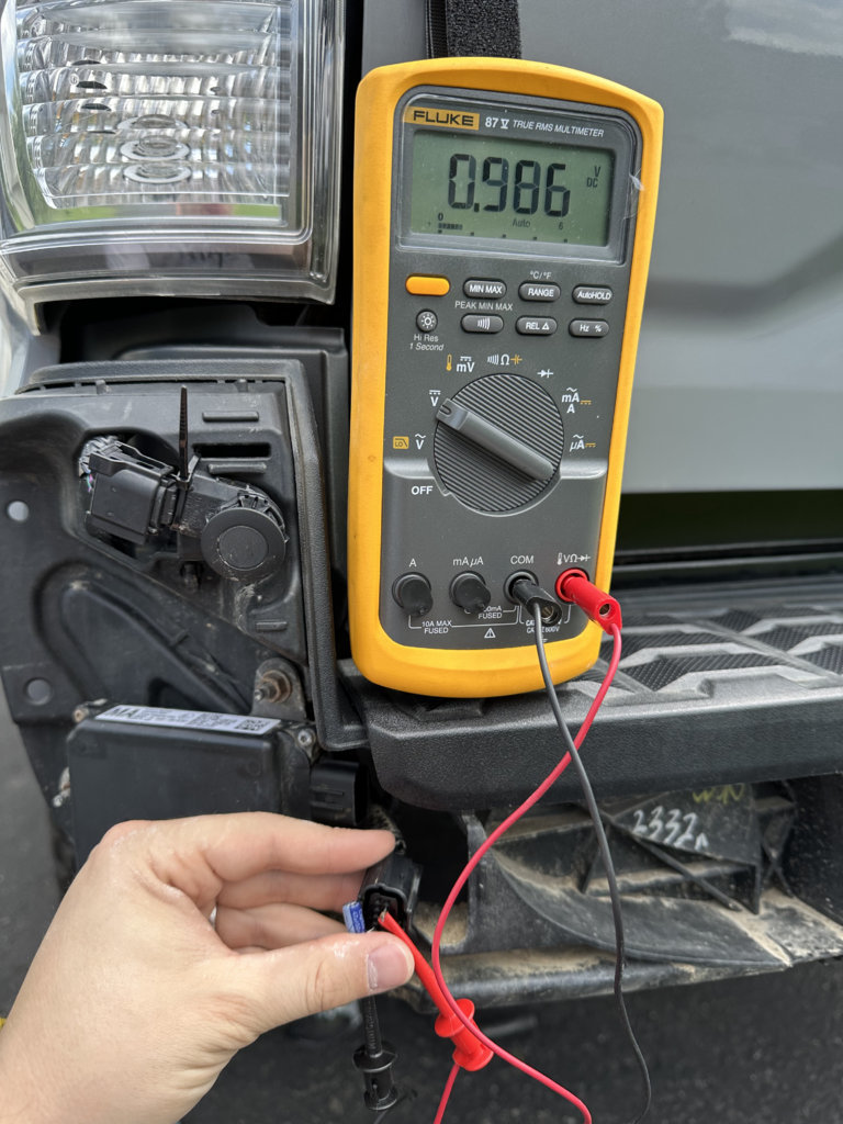

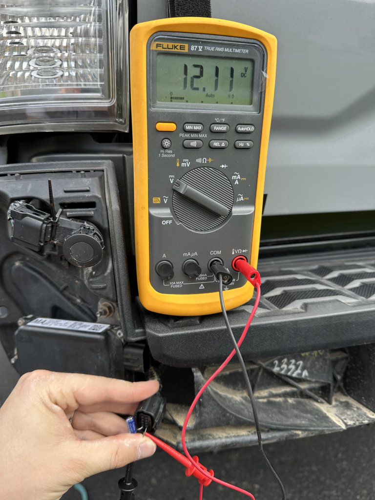

    I ran a new power wire from the connector behind the spare tire…..branched it off to both modules.
    The harness was on back order so I made a repair.
