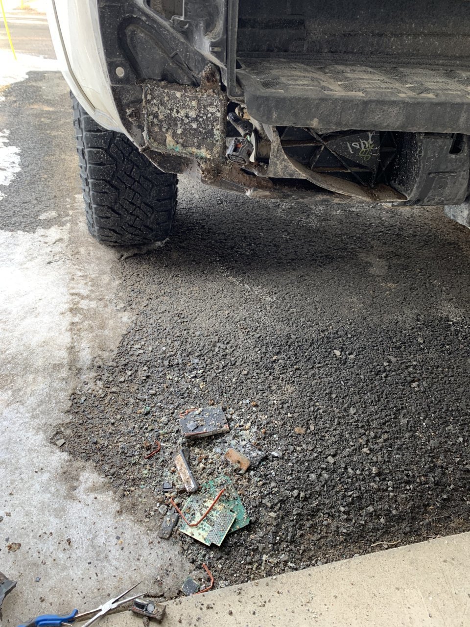

    It was definitely it… took off bumper cover to investigate and the sensor just disintegrated. If I were to cut the connector and seal the wires with electrical tape would that be better? Or do I seal the connector and hope no water finds its way in?

    Eastern Canada... We use a lot of salt on the roads in the winter out here.

    relax, truck is fine. The location of the BSM sensor is a bad design and leaves it vulnerable to debris launched from the rear tire such as mud, salt and rocks. Once mud is in there it is also hard to clean out, I only noticed once I removed the bumper cap how much gunk was in there. My assumption is that overtime the moisture from the mud rotted out the sensor to the point of disintegration. Placing sensors in bumpers is a poor design in my opinion. The quality of the sensors are questionable as well, there is a recall in the US currently on these sensors precisely because of this. I will be submitting a complaint to Toyota Canada in hopes they will extend this recall to Canada.
