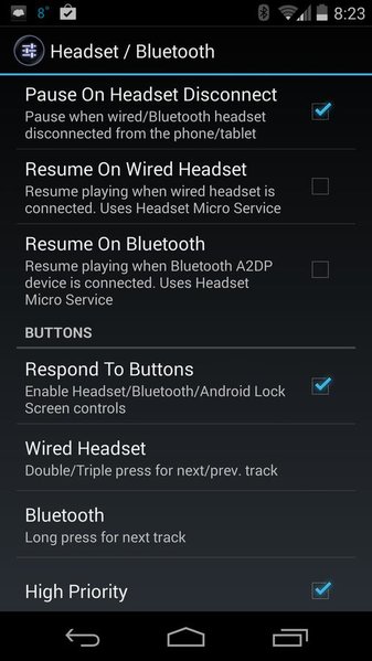

    I don't get it, you don't want your phone connecting automatically? That's a good thing in my mind. It opens and closes on its own when connected. Why would you want to have to pull your phone out of your pocket and do it manually?
    Either way poweramp on Android gives you all the settings you could need. I set it so I have to press play on the stereo manually after starting my truck
