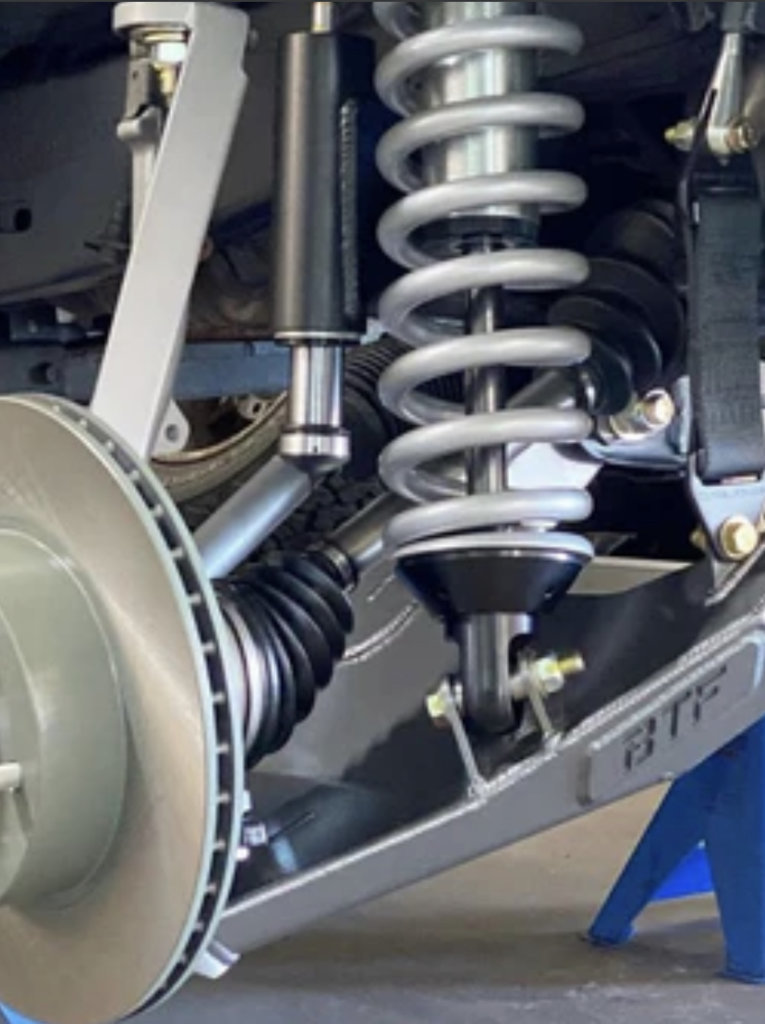

    The bump strike pad is in the pic in the back so it will be there rear bump not the front that might work with it. Remember there’s a lot more leverage on the arm than the oe length and therefore a stock bump stop location can fold an arm on a hard slam / g out.
    Limit straps ensure your spindle and upper arm aren’t your limit straps. Shocks don’t limit travel like mid travel setups.

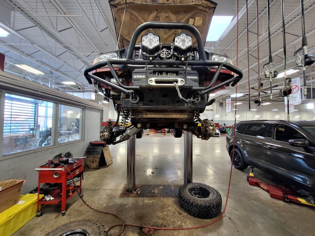

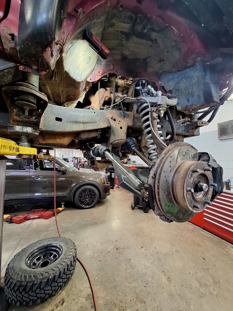

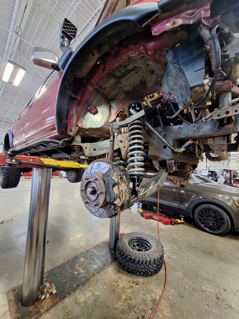

  16. Jan 4, 2025 at 3:35 PM
    #16
    tacoman2001$
    tacoman2001$ [OP] Well-Known Member
    Sep 23, 2022
    #406478
    767
    Well I got one side done ish. Still need to do bumps and limit straps so if anyone has brand reccomendedations. Also found out the front diff is blown up so that was a bummer.

  17. Jan 4, 2025 at 5:07 PM
    #17
    Jon64l
    Jon64l Well-Known Member
    Jan 12, 2016
    #174799
    1,628
    Jon
    2000 4runner, 1996 Tacoma
    Looks like a Tc uniball conversion snuck in there too.
