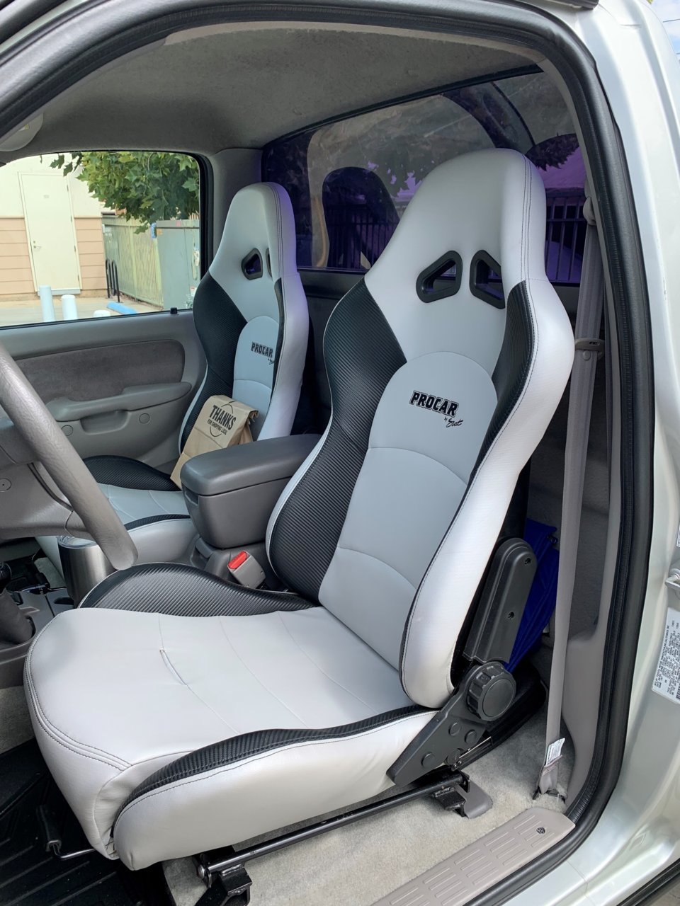

    Here is a pic of mine...

    ^^ Purchase seats and brackets, remove existing seats (disconnect electric plug under DS), install both inner seat belt attachments to the bracket, mount brackets to the floor, mount seats to the brackets.
    I used stainless button heads hardware to attach the seats to the brackets. Waste of time... use the included hardware, it'll save you time.
