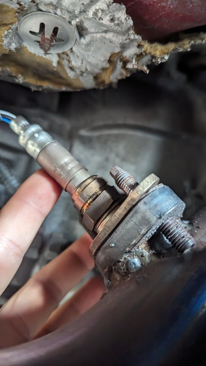

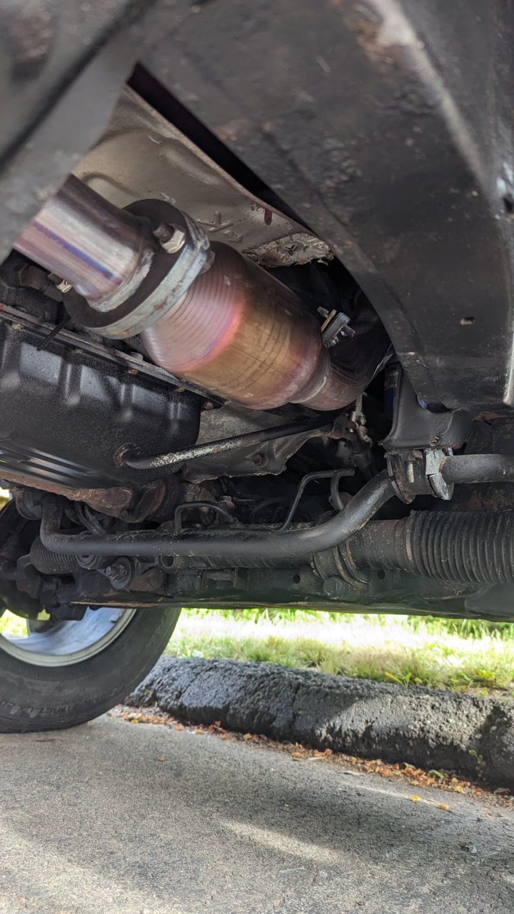

    So just to give a reference for what I'm looking at, both cats appear to be new as well as the O2 sensor (afr sensor whatever you want to call it) one bolt on the upstream O2 sensor is partially stripped from whoever installed it. And the sensor appears to have no brand markings on it.PXL_20230627_214906599.jpg PXL_20230627_214921978.jpg

    Yeah your exhaust is definitely leaking, if there’s only one stud that’s torqued down on that sensor. That bubble gum weld looks sketchy too.
    The AFR sensor is probably reading lean as hell due to the leak, and the ECU is adding unnecessary fuel to compensate.

    You should be able to double nut that and still get a bite...
    get the high temp thread lock and lock the two nuts together...
    You could also back that stud out a little.
    Then I'd clean that weld up with some jb weld.
    And yep....toyota ecm's like all the sensors to be toyota oem, so worth the extra investment....for sure.

    I think your right, I was able to get the stud with the striped bolt off and flip it around and resecure it that way until I can replace it. But I'm now thinking I may have other exhaust leaks around these shady welds.

    So I went to the auto parts store and dished out a good chunk of change for a denso o2 sensor. Disconnected the negative battery terminal and removed the old one which was not torqued down all the way. Installed the new one properly and hooked the battery back up.

    Your exhaust looks almost new....and you dont have the dreaded cast iron headers.

    The entire exhaust is new, I was mainly referring to the weld points as they look suspect.

    Ya. Came back to say even a small pinhole can throw that sensor off.
    Likewise a bad mounting.
    Get someone on the throttle and you should hear any leaks.

    So just to update Incase anyone else is trying to diagnose a similar issue, replacing the upstream O2 sensor (air to fuel ratio sensor) has so far fixed the "bucking when accelerating" issue. Air to fuel ratio is now sitting right around 14.7 as it should and fuel trims look more normal. Yes I now have a bunch of other issues but I think I'll address that separately in another thread.
