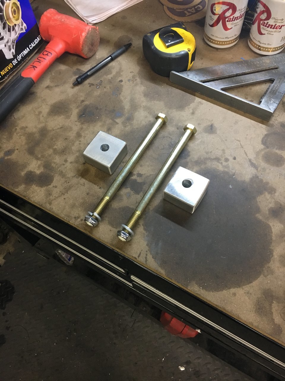

    Front diff drop made and installed finally. Cvs look a lot happier now.

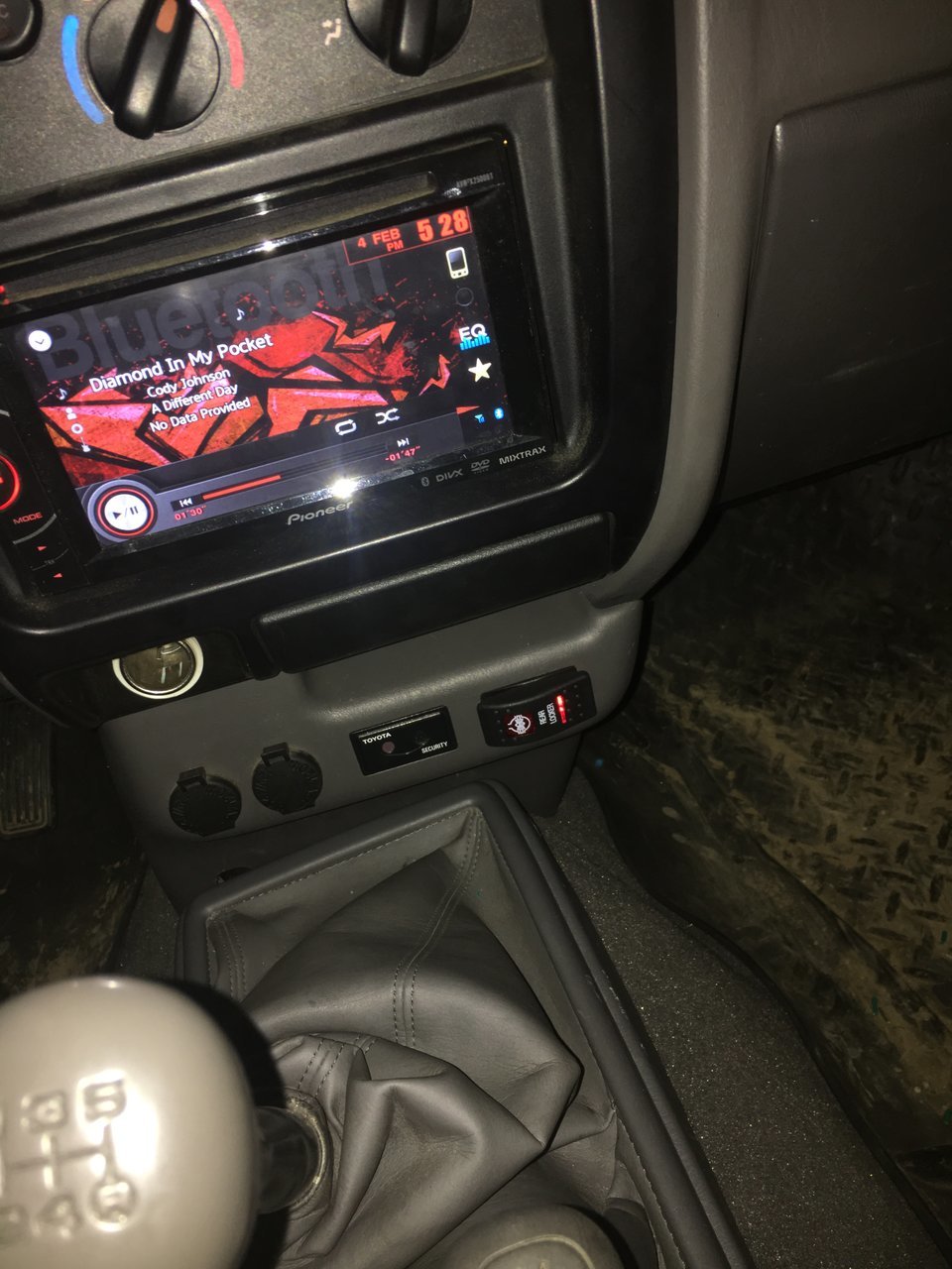

    Elocker switch all wired up today. Just need to get a axle now and it will all be plug and play. Also ran all the wire for my backup camera since I was in there.

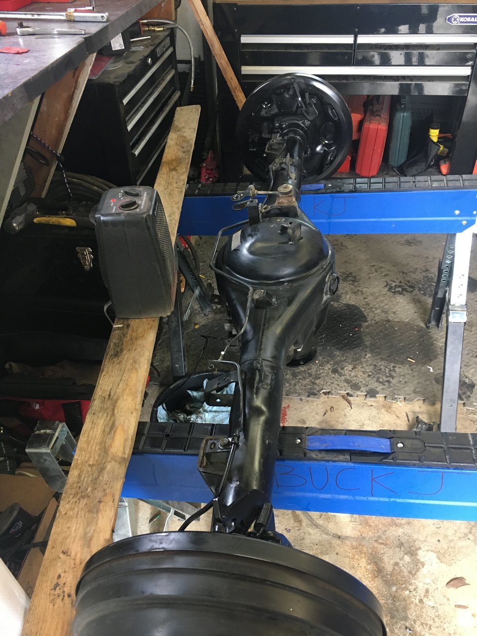

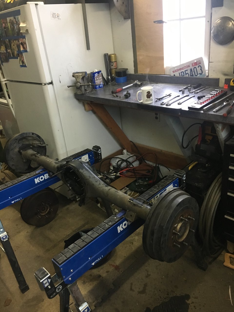

  12. Feb 11, 2018 at 4:19 PM
    #32
    buckmaster243
    buckmaster243 [OP] I don’t know what to do with my hands
    Sep 21, 2014
    #138821
    1,818
    Buck
    Washington
    2013 DCLB, 2023 4runner

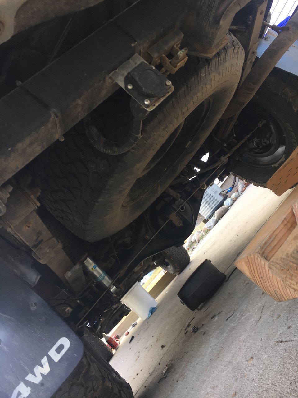

    Finished up the elocker axle swap today. Went to Taco Bell to test it out and everything worked good! Also changed tranny/tcase fluid.
    139,xxx
    Rear diff 85/140
    Tcase 80/90
    Transmission 80/90
    Elocker axle came out of a 03 @ 144k
    5D82191A-55D1-4193-ABBB-5492513A93C3.jpg B37BC355-BE31-49E3-9F5F-20D4E4C2CB23.jpg 1D123433-9103-407F-8398-9F208878B6CD.jpg CA1FE52A-811B-49ED-8098-99A1C3723295.jpg
    Next time I think I’ll wait till it’s above 25 degrees out.

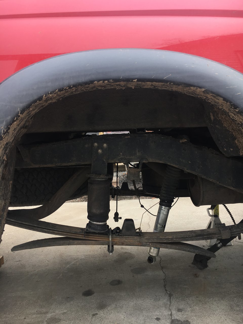

    cool resto, are you changing out the rear leafs at all or are they holding up?
    buckmaster243[OP] likes this.
  14. Feb 12, 2018 at 3:56 PM
    #34
    buckmaster243
    Sep 21, 2014
    #138821
    1,818
    Buck
    Washington
    They are holding up well enough for now. I’ve got air bags so with about 5 psi in them they stay pretty much positive arch. I’d like to go heavier duty ones at some point but I don’t really want to gain any height. Once I wear these tires out I will be going with a 265/70/17 instead of a 275/70/17 and dropping my bilsteins back to the lowest setting.
