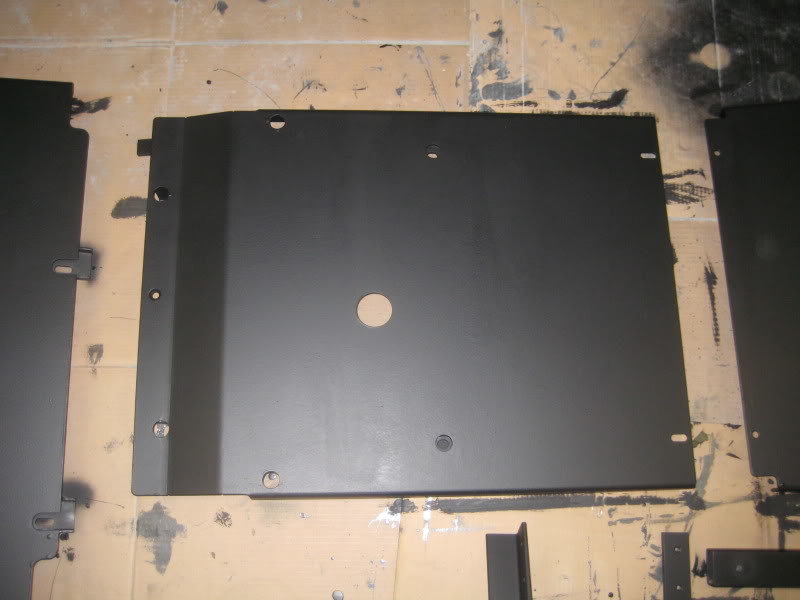

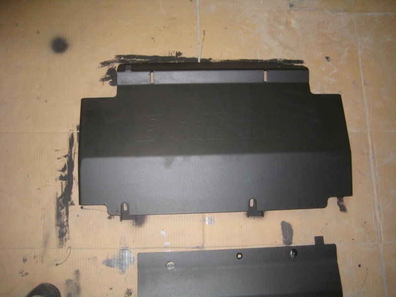

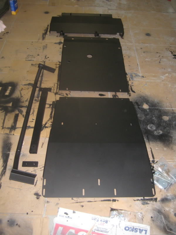

    First things first, some paint. Because these are skids and I intend to use them as such, I chose standard old flat black rustolium. This is very easy to touch up after scraping the hell out of them on a rocky trip (this is what all my armor is painted with). The skids come VERY clean, I didn’t get a picture, but honesty, it looked like they polished them…they were sexy. Standard paint procedures here though, scuff them up with some sand paper or scotch pad, clean with acetone, and pile on the layers of paint.

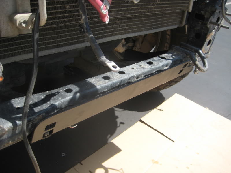

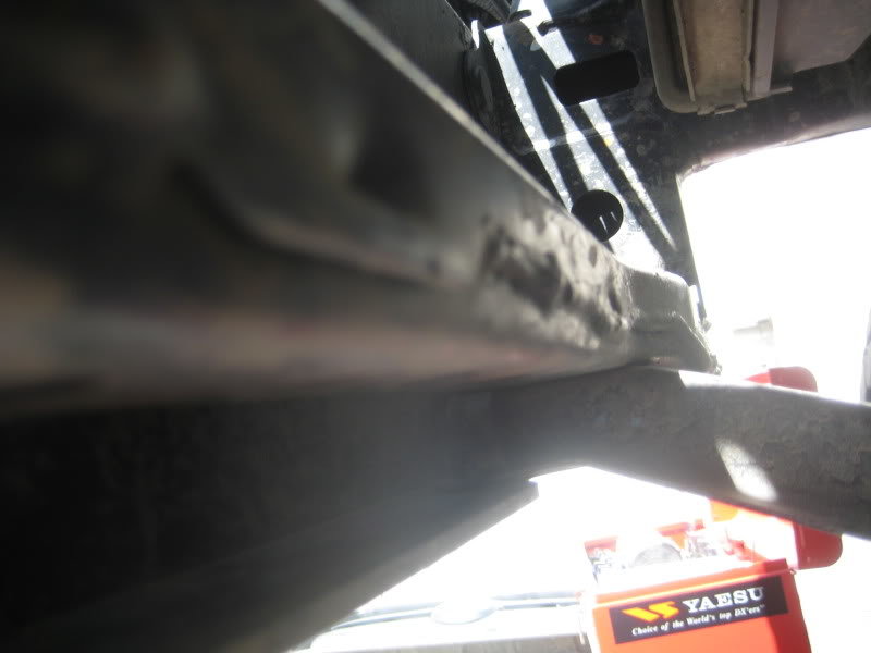

    Once they are painted, its time to get to work. Start with the forward skid, this is where you will run into issues with the all-pro bumper. The skid utilizes the stock skid supports. Unfortunately, when my allpro bumper is mounted in the correct position, it is tight against the bottom of these supports; therefore there is no clearance for the skid to mount (this is also why a stock skid will not work with the allpro bumper:
    (Sorry for the horrible picture):

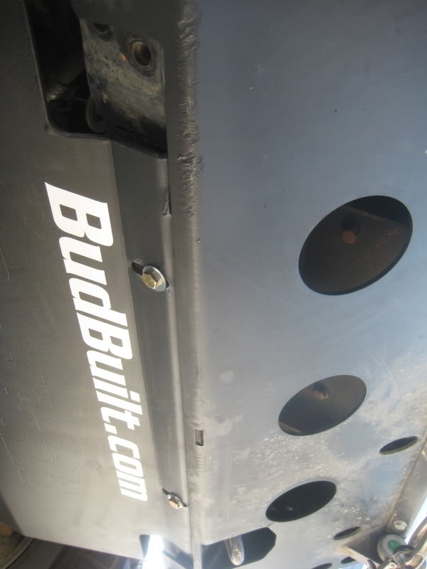

    Luckily, the allpro bumpers bottom two bolts are located on the outside of where the skid mounts, so it is possible to trim the bottom lip off the bumper, but still use the lower two bolts. A quick pass with a plasma, and you are good to go (you can see what I mean below):
    Now, this allows for the proper clearance between the bottom of the bumper and the skids, however, the skid itself still needs to be modified. When the skit is mounted, you can see that the front lip is not bent at a 90 deg (does not go up vertically) but instead sticks out forward a bit:
    Because the allpro bumper has a vertical support right at this location, the front lip must be trimmed to allow the bumper to mount properly. Once again, a quick pass with a plasma and you are good:

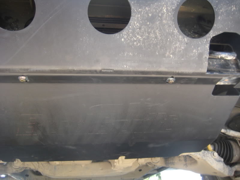

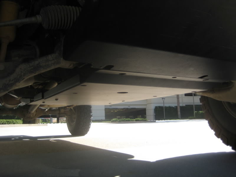

    Once this is complete, the bumper and skids bolt right up as they should. The rest of the install on the skids is very strait forward, and once again, because everything is manufactured so well, everything lines up perfectly making it very hassle free. Budbuilt already has a very good write-up on installing the skids so I will not get into all that.

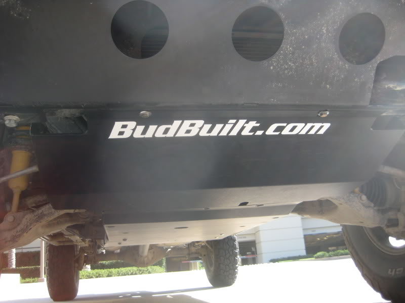

    Once they are all bolted up, here is the final product:
    How much I cut off:
    Well on the bumper, you are limited to how much you can trim becuase there is a reinforment behind the bumper that welds to the bottom lip (right at the bend) and you do not want to cut the welds. Essentially, you need to cut as much as you can without messing up the rest of the bumper. I went out and measured mine, and it is dead nuts at 2.5" that I trimmed off. Use this as a base though, as all bumpers might be a bit different.
    For the skid iself, basically I trimmed as much of the front as I could while still leavign teh front bend. This means that the bend itself has a radius on the front lip. I allwed the radius to end, and cut it right there. I beleive it was about 2" off, but again, just try to leave the front radius and trim the rest.
