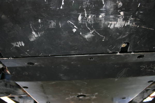

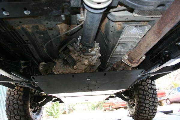

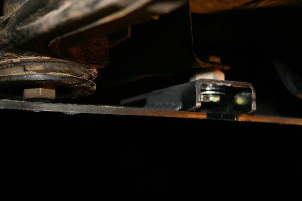

    So I wrasseled them bitches on:D. still not happy with the front but oh well.

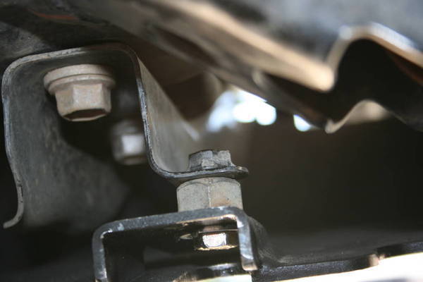

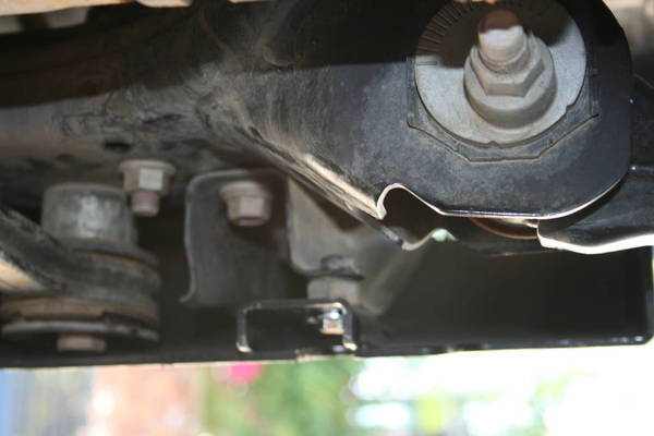

    here is a pic of the problem area.
    I had to use that nut as a spacer
    without the spacer the skids will rub on that thing to the left.
    this is the other side. same story without the nut the skids tighten down on those things in the photos.
    By using the spacers it made the mid not sit as deep as it should of so I needed longer bolts.

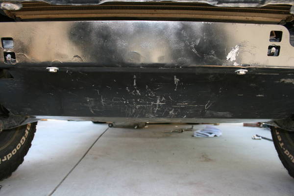

    Here are some photos of the finished product.
    plenty of room :rolleyes:

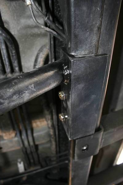

    What does that crossmember bolt too?

    it bolts to a small metal plate that claps down on the frame when you tighten the bolts
