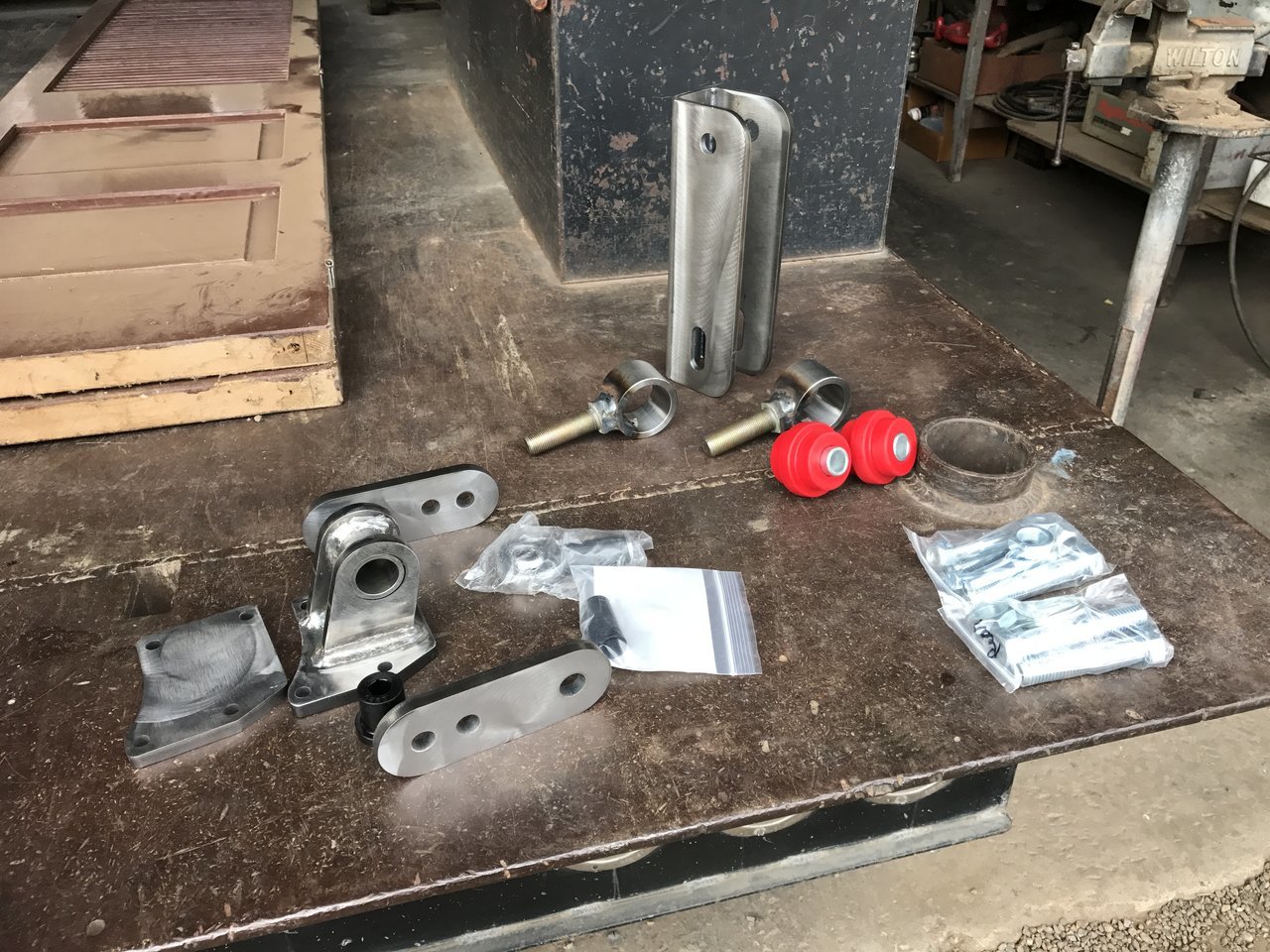

    043RZ,
    I just received this weld-on kit from BudBuilt. There are no instructions in the package which one really won't need but there is a measurement I'd like if possible:
    In relation to the bottom of the axle tube, what is the bottom height of the bracket?
    Also, does the elongated hole mount up or down.
    Lastly, the bushings I received don't appear to be correct for this kit. Your thoughts?
    Thanks.

    61,256
    rock raisin
    Those bushings look correct to me, they may have been shipped weirdly but flip the 2 halves and they look like they will fit nicely in the eyes

    I tried as that's what I though too.
    They do not come apart from what I can see. I can always pull the sleeve and cut them in half on a band saw if needed.

    Congrats on pulling the trigger on this purchase. It's honestly one of the best mods if done, along with the steering shaft weld and gear swap. You will be happy once installed.
    Ok so those bushings are correct. They shipped them together like that. Grab the bushings and pull them apart and you will have two halves that will slip in both sides of the eyes on the adjustment bars.
    As far as the bracket that welds to the axle housing. The oblong hole mounts up. This kit is completely universal and you can weld this bracket in as low or high as you want. However my suggestion is to find a happy medium. You don't want the bracket too low past the axle housing as it will snag on things when off road. I chose to mount it as high as I could while still leaving enough material to weld to. Those holes on the backside of the bracket (the side that mounts to the axle housing) are ment to be filled in with welding on to the axle. Then you weld both sides of the bracket to the housing. Now look at the first photo I posted and zoom in to the left of the bracket... look at the axle housing... do you see a horizontal weld? This weld is on both sides of the axle housing and is put there from factory. Take the bracket and try to mount is flush to the axle housing. You will see that this weld I'm talking about is preventing the bracket to sit flush on the axle housing. My solution.... once you decide where you want to mount the bracket, take a metal cut off wheel and notch the bracket so that this axle housing weld will sit in flush to the bracket. Do not grind the weld on the axle housing flush.
    If you have any question pm me. Or call bud from BudBuilt. He was very helpful.
