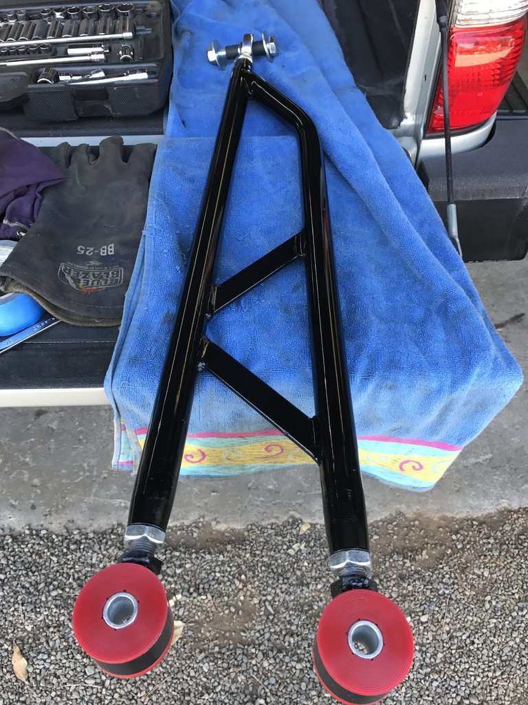

    So I worked on the trac bar on Sunday.
    I did get the bushings apart... snug little bastards which were stuck on the crush sleeves.
    I cleaned up all of the welds and had to cut 10" out of the track bar as it was too long. As for the axle bracket, I had to further elongate the elongated hole down 1/2" to accept the upper arm of the bar. I'll get everything painted this weekend.
    The install will happen after I rework my exhaust. My muffler is in the way now.

  8. Sep 18, 2017 at 6:01 AM
    #48
    Ritchie
    Ritchie Well-Known Member
    Dec 24, 2012
    #93649
    1,931
    San Diego (North County)
    RC Step side Pre-runner
    2.7 w/auto, 4WU 3 link, F & R Diamonds, ARB's F/R w/ Yukon 5.29's, Inchworm 4.7 Lefty, Deavers, ARB OBA, Schrockworks up front.
    Here is a pic of the 10" shorter trac bar. All parts are cleaned & painted. I'm hoping to get the exhaust re-worked sometime this week.
    At this point, the install will be quick.

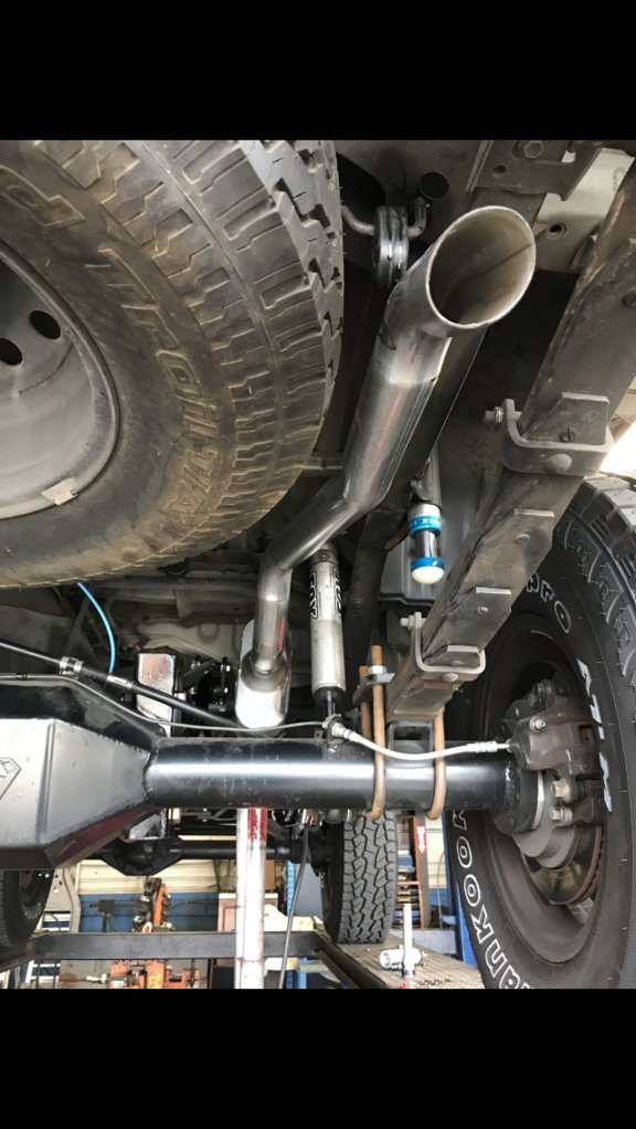

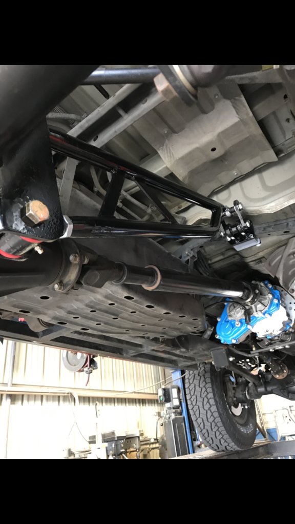

  9. Sep 22, 2017 at 5:53 AM
    #49
    Ritchie
    Dec 24, 2012
    #93649
    1,931
    So I installed the trac bar along with new exhaust. Went with a Flow Master 50 Series Delta. Much quieter than my previous rusted Magna Flow.
    Trac bar is amazing.
