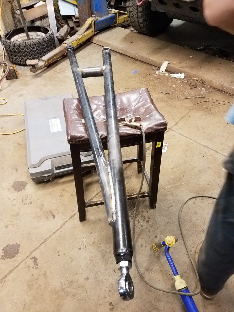

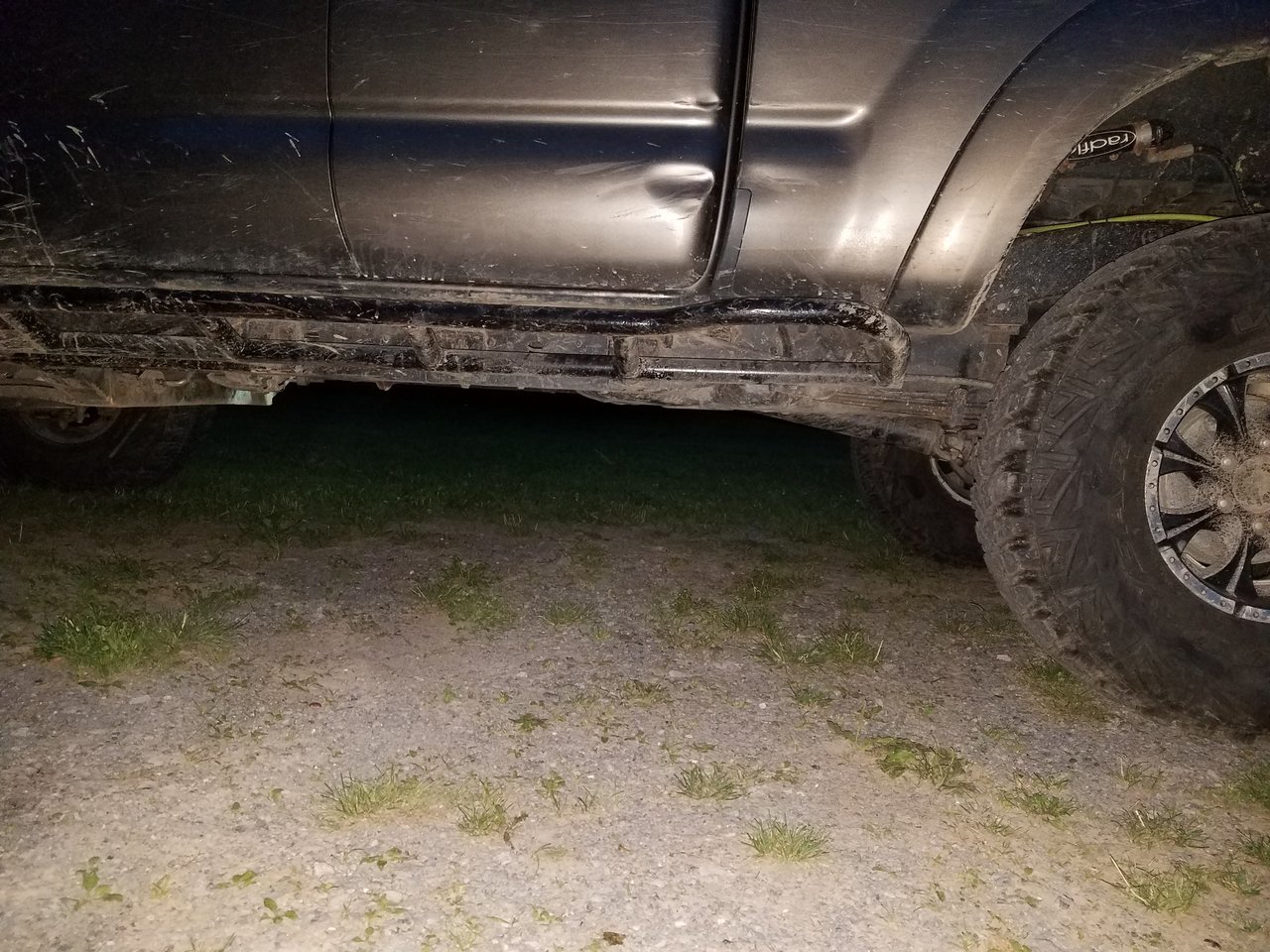

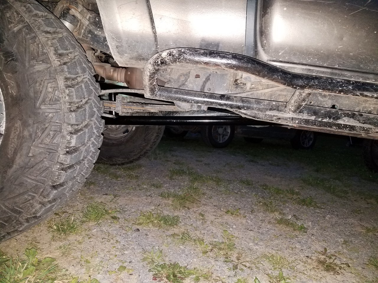

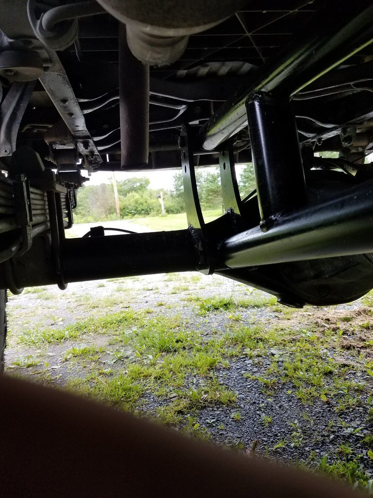

    This one. I went with 5ft lower, 4ft upper and baby shackle. Mounted the front to the carrier bearing cross member, then braced the cross member from the front. I have and access cab and don't believe the 4ft lower version would work for that front mounting surface. My angles are almost perfect with the lower arm matching the drive shaft angle and the upper arm being rather parallel to the ground.
  7. Jul 19, 2017 at 3:01 PM
    mightytacoman
    mightytacoman Mighty-known Member
    Apr 3, 2013
    #101270
    2,408
    Kel
    4.5L 1grfe
    Brian Crower stroker kit, Carrillo pistons moly/ceramic coated, BC sportsman rods, arp s2000 head bolts, Darton M.I.D sleeves, Kelford race cams, Magnusson supercharger, hp tuner tuned, 650cc flow matched fuel injectors, CSF radiator, Walbro 255 fuel pump. pulleyboys quick change pulley with 2.3", fpr mod, NST crank, water and alternator pullies, 160° mishimoto thermostat. Puma On-board air, Radflo CDC ext coilovers with 14" 700# springs, extended length rear Radflo shocks with CDC, Dakar leak pack, Brute Force Fab front bumper galvanized and powder coated, DTRL mod, yellow fogs, fog anytime mod, relocated rear differential breather, synthetic fluids, custom airbox, tundra sized intake. 76mm throttle body, secondary air filter removed, Airflow snorkel, 4x innovation sliders powder coated, URD equal length headers, DT y-pipe, Aero-Turbine 2525xl exhaust dumped over axle, seat belt chime disabled, Warn 8000i winch, 1- 20" slim light bar in grill, 42" curved roof light both with custom brackets. Mesh grill, Brute Force Fab rear bumper with extra reverse lights, u bolt flip kit, SS extended brake lines, hockey puck bump stop extension, AT shackle flip kit, Light Racing UCA's, 4crawler 1.5" bodylift. custom built front and mid skid plates, re-geared to 4.56s, windows tinted 25%, Sony stereo, 8" skar sub-woofer, 1000 watt mono amp, retrofit headlights with legal demon eye, Kryptek Marathon seat covers. North Star agm 27f battery, Helo 791 rims, 315/75/r16 Mt/r ARB front air locker
    Its on the truck here and barely visible
    This is how I mounted the front part, you can see the brace I added to the cross member for extra strength
    rear mount, again, I wanted to keep it high to keep all my ground clearance
    Off the truck cooling after I finished welding it. As you can see, its pretty beefy.
    the view from the other side of the truck to prove its actually there.
