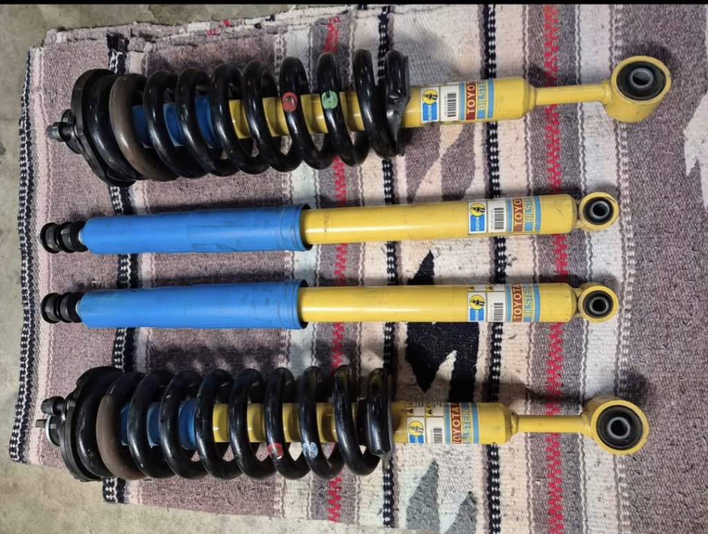

    So a guy near me has a low mileage set of front and rear take off Bilsteins from a 2020 TRD Taco that he's selling for $240. Question is will these stock 2020 bilstein trd shocks fit my 2024 SR5 with no modifications? Also, how do you think this will affect ride quality both off and on the road?
    Thanks in advance for your thoughts on this potential budget upgrade.

    For starters, the front shock mount has 4 studs on yours vs. 3 studs on 2005-2023...
    But no it won't fit. Different motion ratio, different lengths, different fastener sizes. Plus the yellow chopstick-thin OEM Bilsteins were already undersized for the 3rd gen application, so they wouldn't hold up to the 4th gen's heavier weight.

    Bilstein 4600 shocks.
    Save your $240 and put it towards some shocks built for your truck that are an actual upgrade.

    Pretty sure that 3rd Gen suspension parts are not compatible with the 4th gen. Just wait for someone with a 4th Gen OR to upgrade their suspension & buy their takeoffs. I believe a poster in here has already done this & liked the results...

    as stated, its a no go...

    Yep, now looking for someone with 2024 OR take-offs, preferably not to far away from ATL/my area so's I can go pick them up rather than pay too much for shipping.
