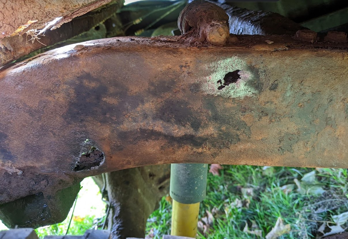

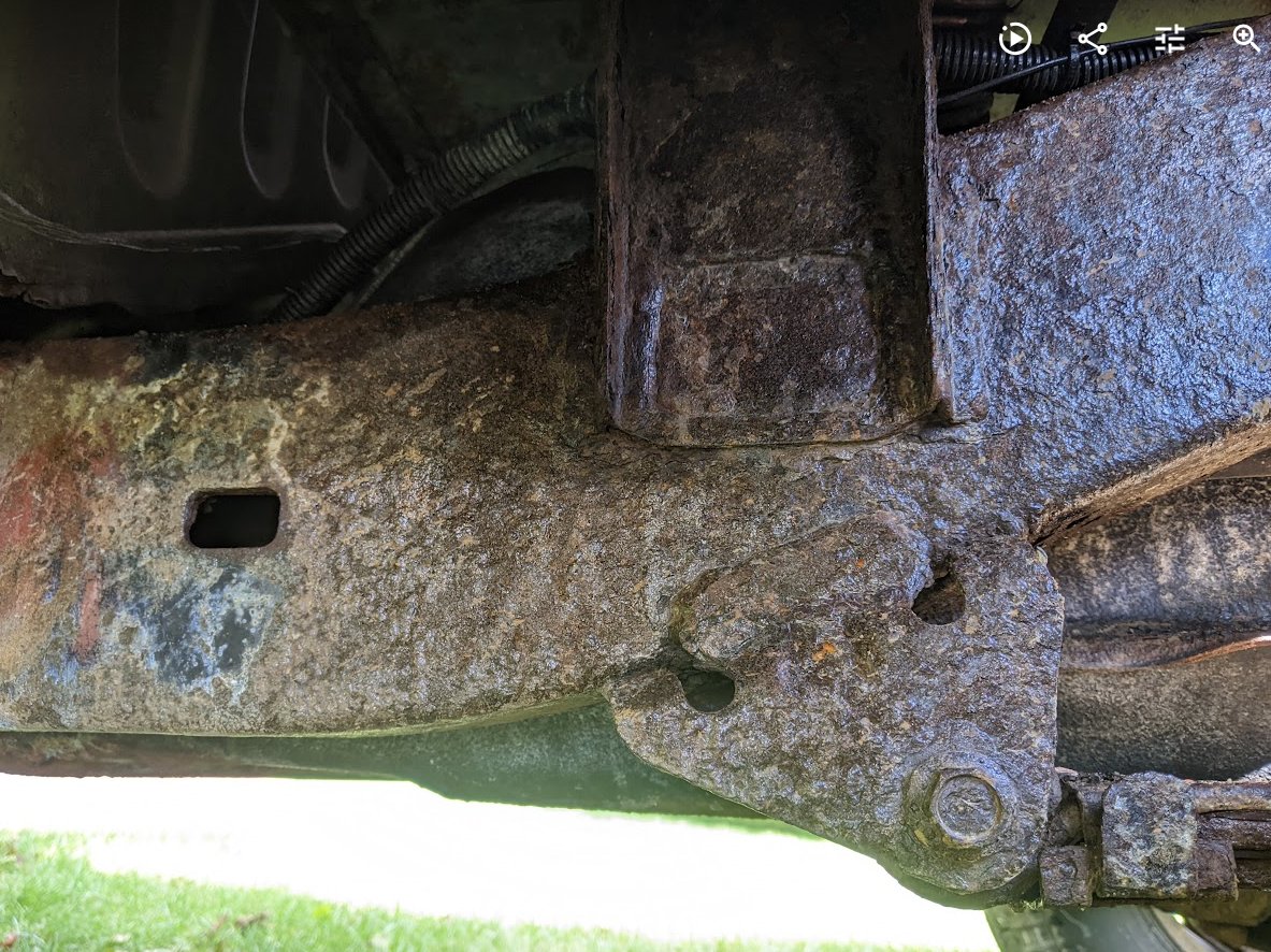

    Decided to stop letting the "perfect" be the enemy of the "good" and to make some progress. I've been struggling with getting the bed bolts to loosen up, so with limited time and energy I decided to attack as much of the visible rust as I can now until I can get the bed off. The major areas that need attention are predictably the drivers side frame and leaf shackle area. I beat it with a hammer to get as much loose crud off, then hit it with a wire wheel to get as much surface rust off as I could.

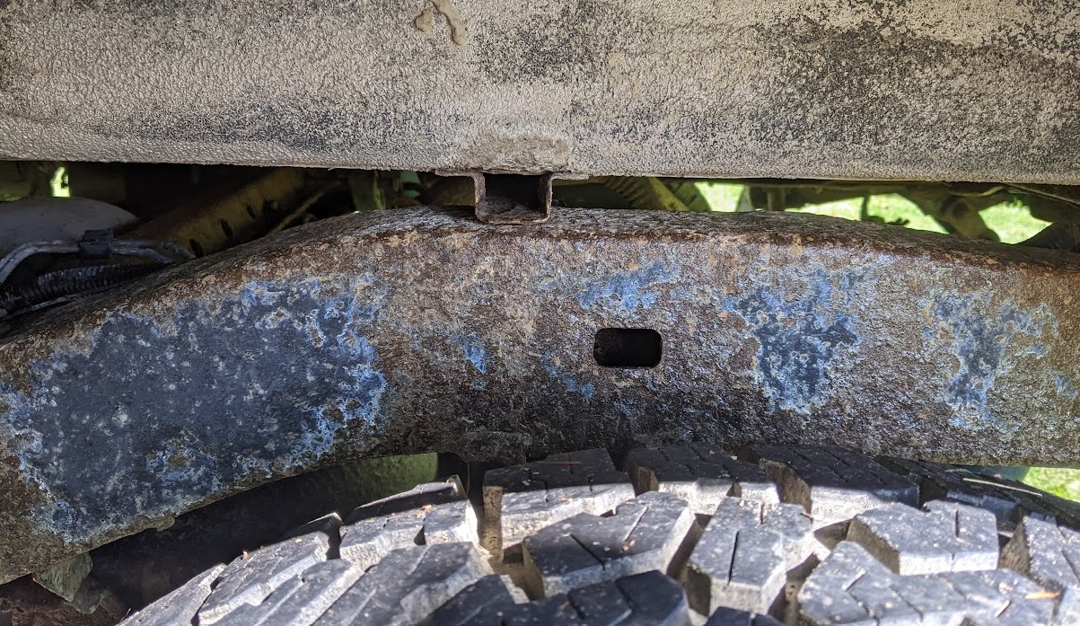

    CLeaned up

    Good news is I didnt see any rot thru, I think Im catching it in time to save the frame. The factory undercoating has held up pretty well on the forward part of the frame, just the rear is gettin rusty. I referred to these reviews to choose my rust converting spray/paint, he seemed to do thorough testing and unbiased reviews.
    https://www.youtube.com/watch?v=tu1n1POMg98&t=589s

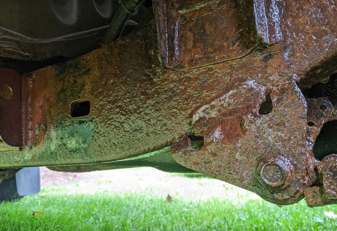

    I went with the Rust Kutter to convert exisitng surface rust:
    Applying it:
  7. Sep 11, 2023 at 10:29 AM

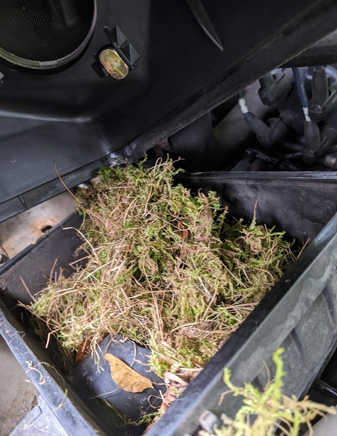

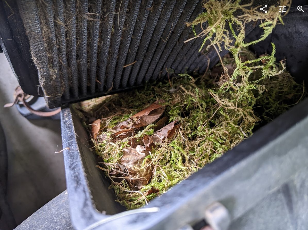

    Decided to check my airbox for the hell of it and.... This might be the filter mod that actually DOES net me +5 hp!!

    haha holy shit. nice project! love a budget build

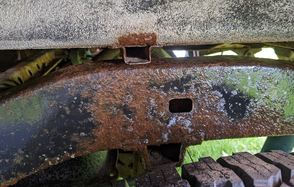

    ONce the Rust Kutter dried:

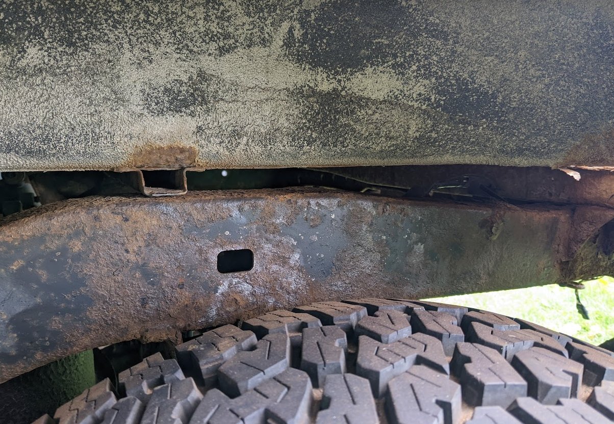

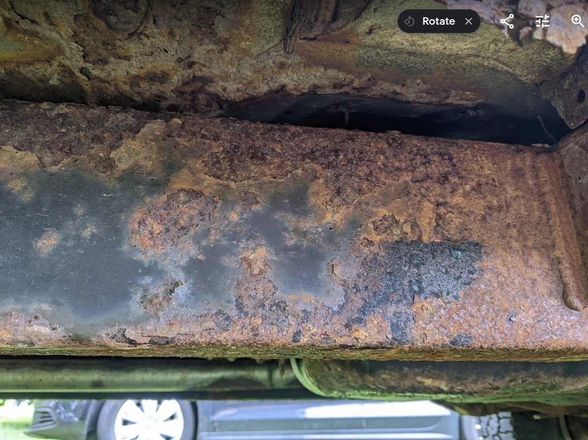

    STarted poking around on the passenger side and... NOOOOOO
    Only two small spots luckily, I was thinking I would escape unscathed. I'll have to weld some patches around these

    You should probably remove the cab and bed from the frame, man. That frame is a little crusty. If you’re going to do the job, maybe go all of the way.

    Want to get the bed off at a minimum. Cab... maybe, idk if thats a bridge too far. I dont have a dedciated garage space for this, I'm mostly working on it in my lawn haha. I PB blastered the bed bolts again this AM , will see if I can get them broke free.
