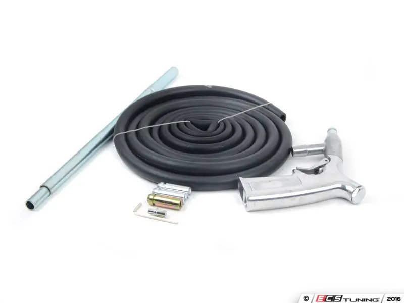

    BTW, the "blast out of a bucket" siphon sandblasters as below are just slightly better than completely useless. :rant:
    I suppose you could say they do work - imagine building a house using a plastic hammer...
    If the goal is to run up both your electric bill & blood pressure they are a smashing success. :frusty:
