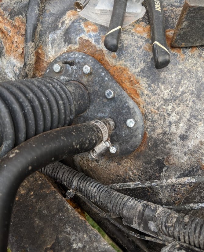

    I

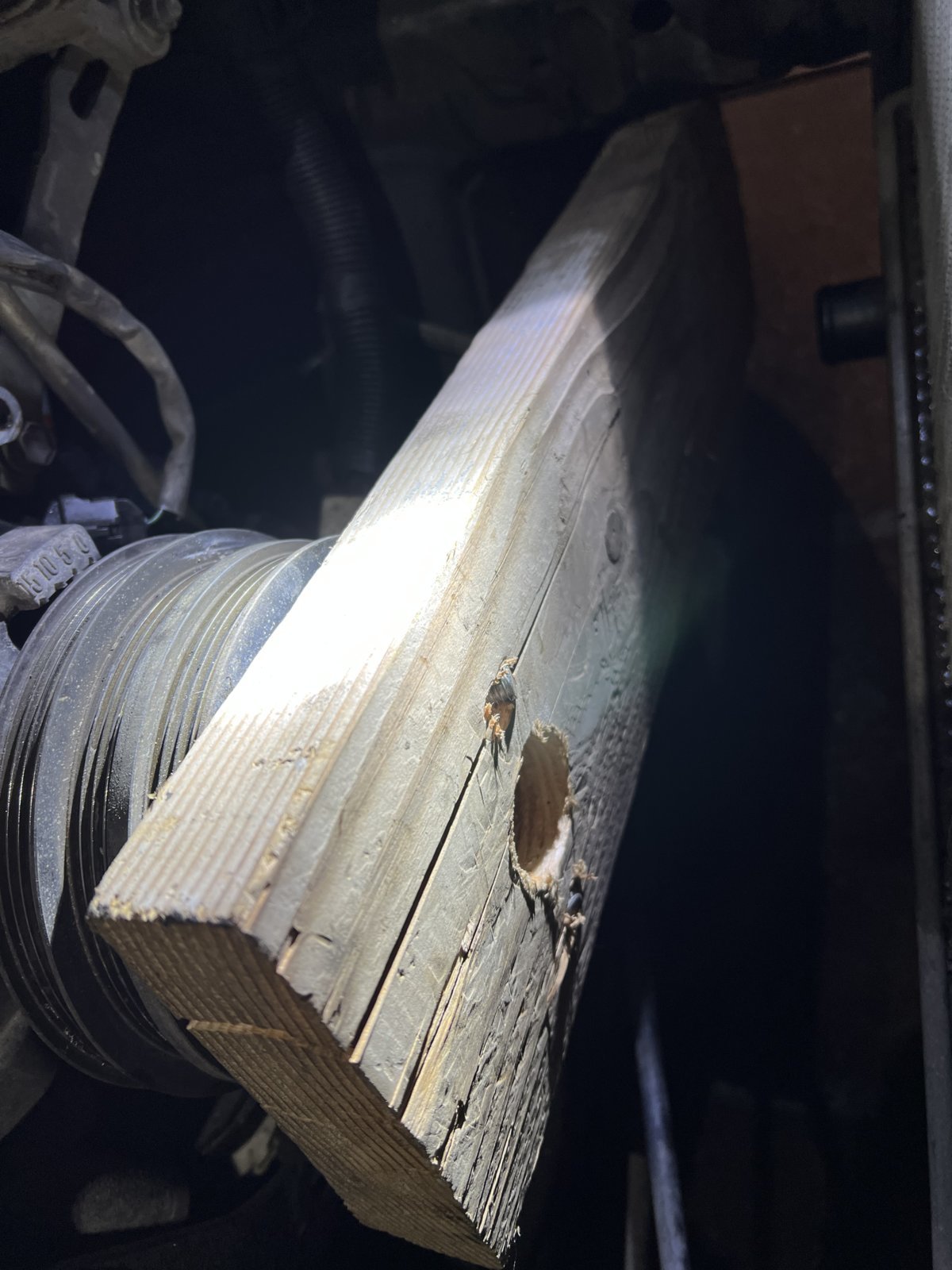

    I tried to find the tool I needed, I ordered 3 different types online and went to a bunch of auto parts stores in my area and couldn’t find the right tool for my pulley… so I had to figure out a solution because it had been a week the truck was just parked… the right tool was going to take 2-3 weeks to arrive and I didn’t want to wait. Worked great and I also found another way to do it. 2x4 wood with a 2” hole in the center and 2 3/8” holes lines up with the pulley holes and 3/8 bolts threw those holes to hold it in place. The 2x4 needs to be just long enough to sit on the frame so it doesn’t allow the pulley to move.

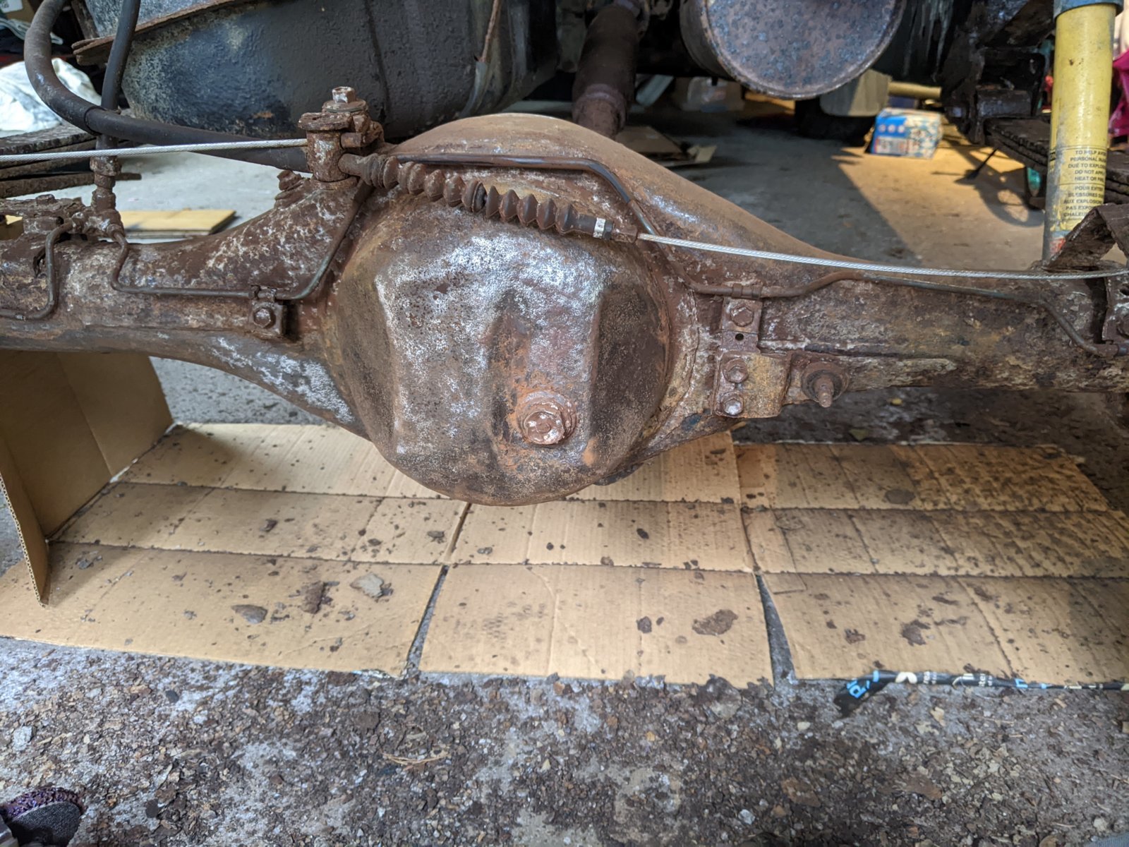

    Got some rust stripping pads for my angle grinder, this probably works the best of anything I've tried so far. Only downside is you can't get into the real tight spaces
    PXL_20231006_214509252.jpg PXL_20231006_214509252.jpg CH]
    Diff cover is starting to look like a diff cover again

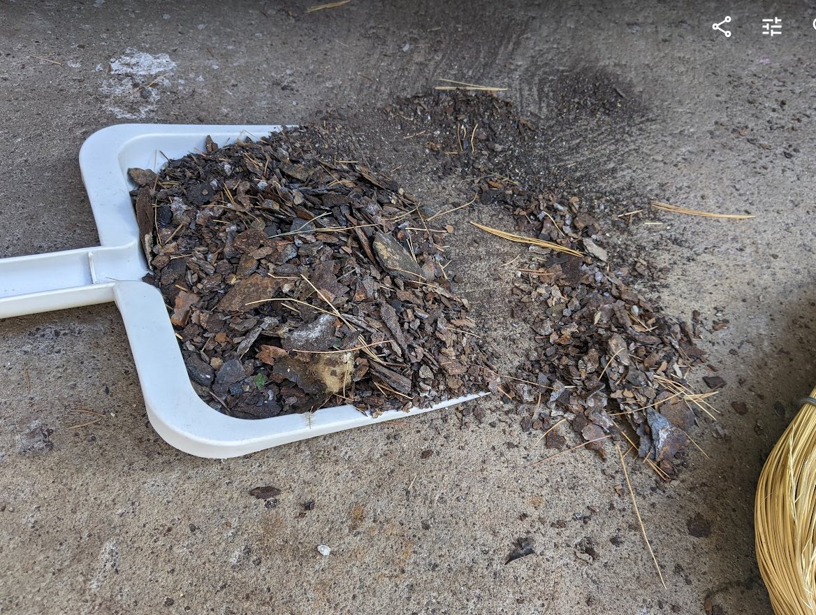

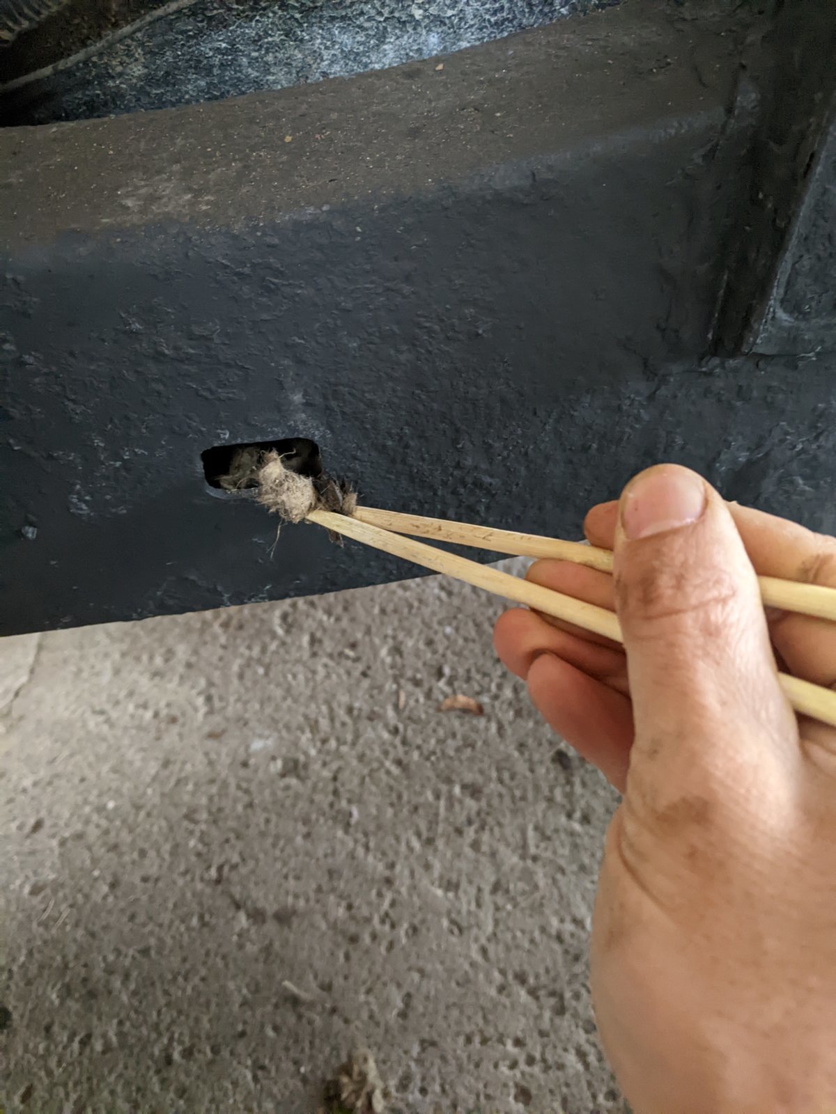

    Using the chopsticks method to remove more mouse nests and rust chunks from hard to reach areas. I also duct taped a section of garden hose to a shop vac and jammed it into the frame, that was really effective

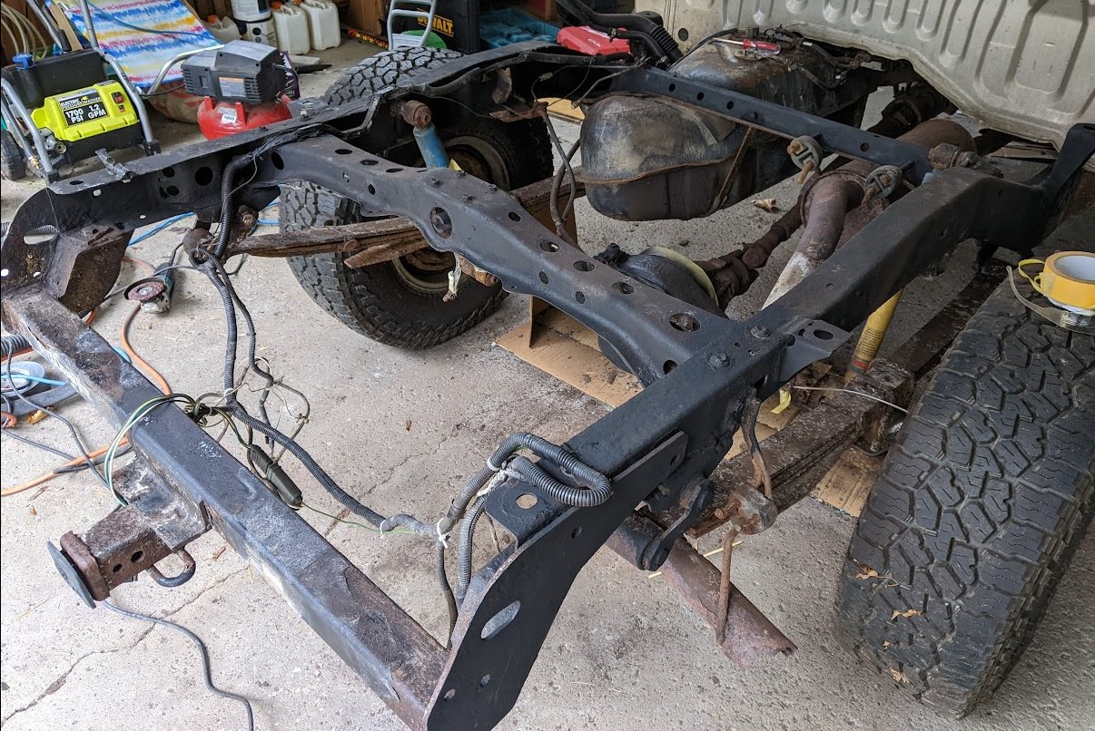

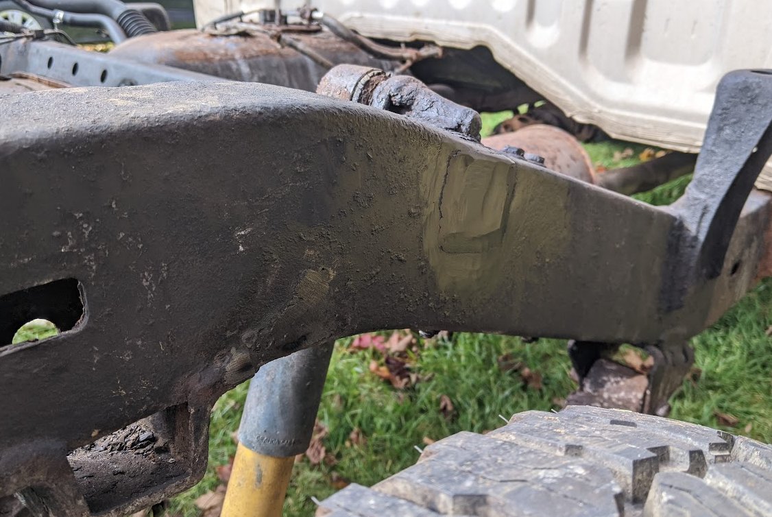

    A not insiginificant amt of rust...
    Cant get the last 2 bolts off the hitch to remove itm which is pretty annoying. Think I might need a torch to remove it. Got most of the rest of the frame cleaned up and a coat of paint, Im gonna hit it again on the udnerside and give evrything else another coat. This is the stuff I used, maybe not the best but its what was available in town
    SOme progress being made
    Debating what to do with the leaf springs, clean them up and paint them, or just leave em be and budget for new ones down the road, theyre pretty crusty and new ones arent too expensive

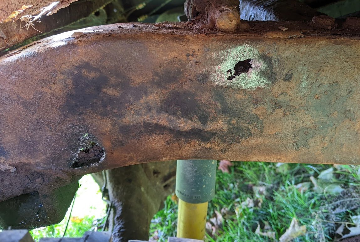

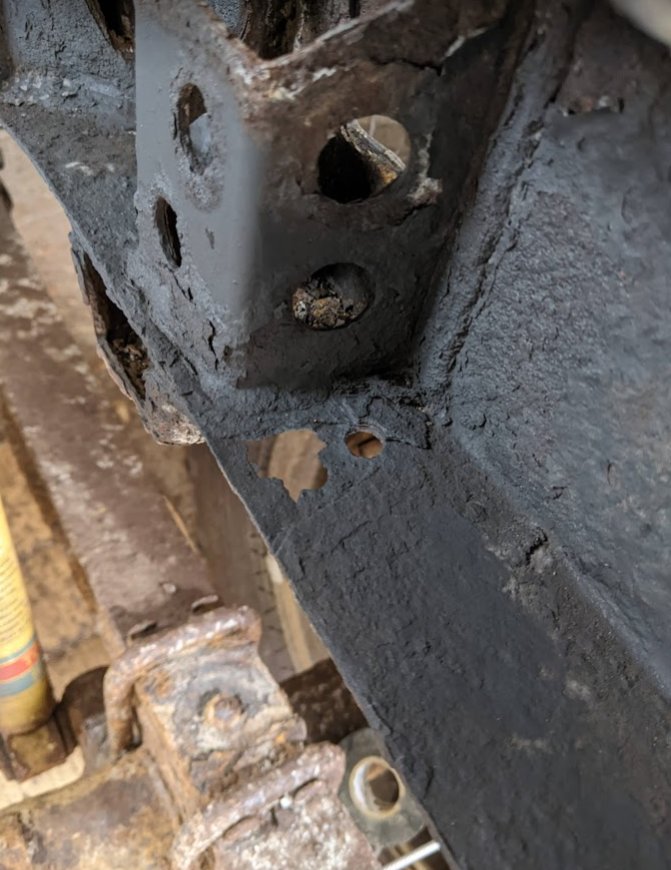

    1996 Tacoma Xtracab MT 4WD 2.7L

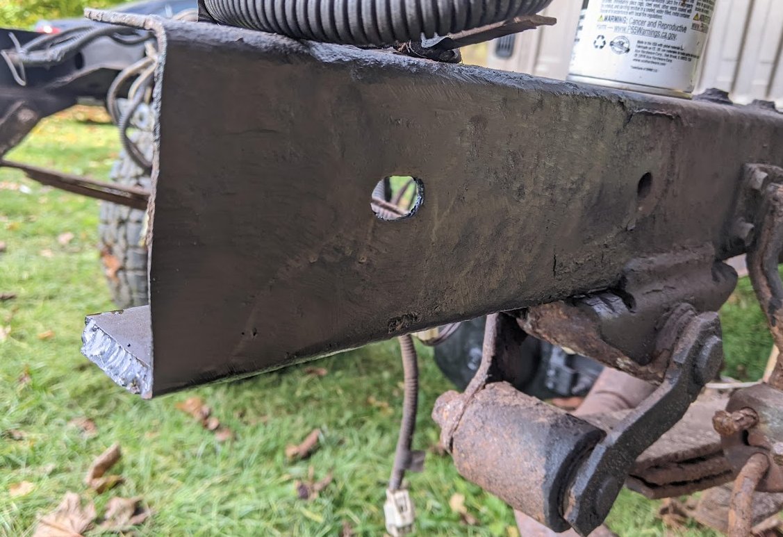

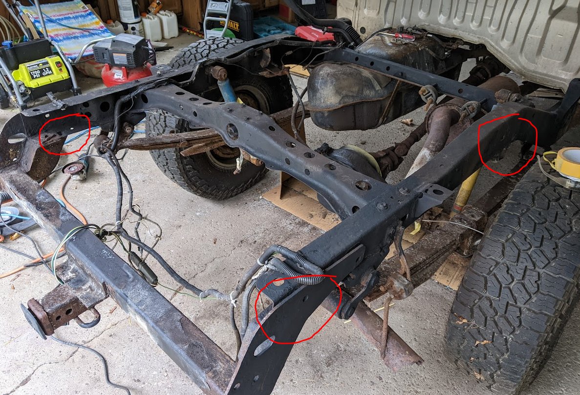

    These are the remaining weak spots on the frame, both back near where the hitch mounts up. I think I'd like to get a plate weled on that entire section to bolster it (a spot where a hitch mounts seems like it outta be pretty strong) and maybe even box it in just towards the back. Thoughts?

    replacement is fine, i would vote against boxing in the frame at this point, given the stock nature of the truck.
    boxing any part of a frame will make that section stiffer. initially this sounds good, but any open c-channel frame is designed with a certain amount of flexibility to it. by boxing in such a frame, you're removing the flexibility of that section, and forcing a different section to flex twice as much, which can rapidly accelerate metal fatigue.

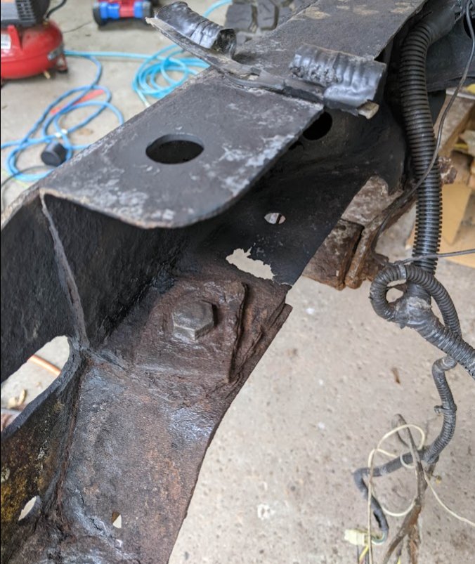

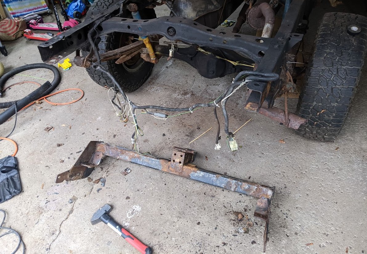

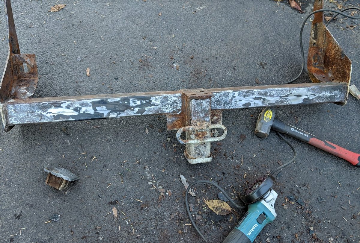

    Getting my frame welded up tonight so had to get the hitch off to address the weak spots at the rear of the frame. After some more cursing at those last two bolts, I grabbed the grinder and.... it magically fell off! BOlts are cheap right?

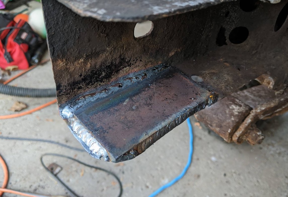

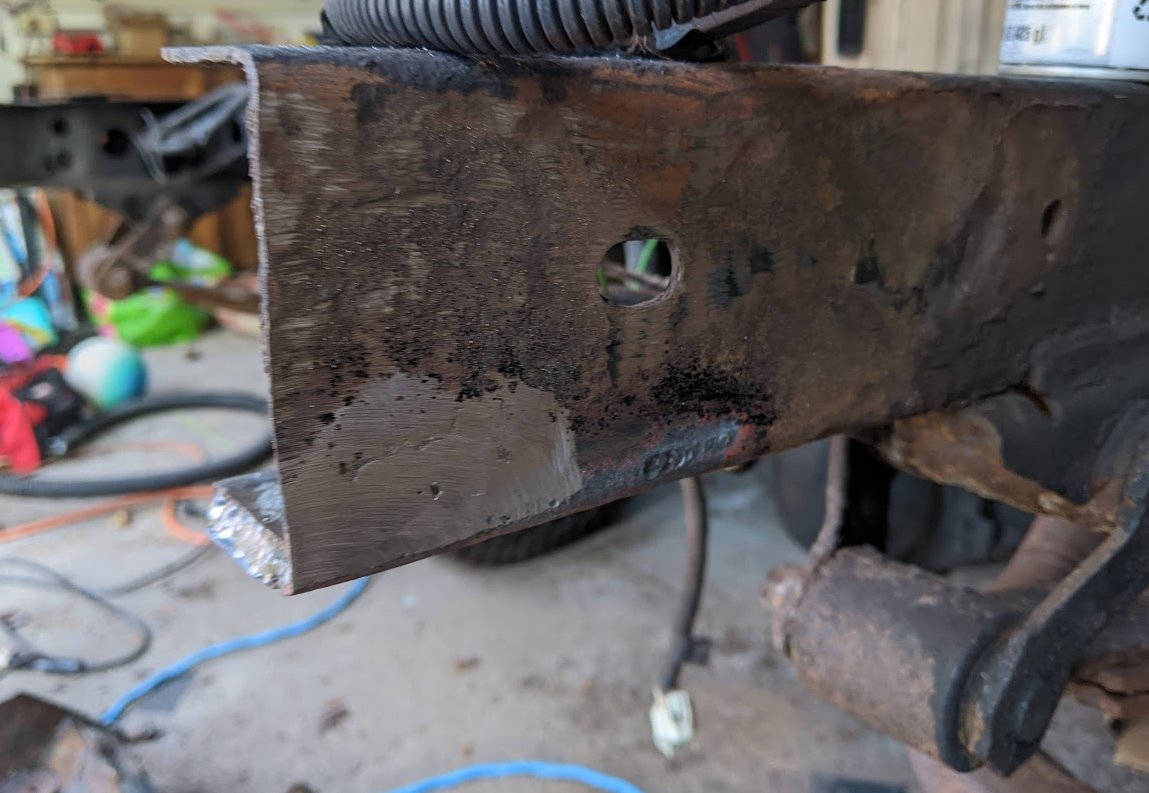

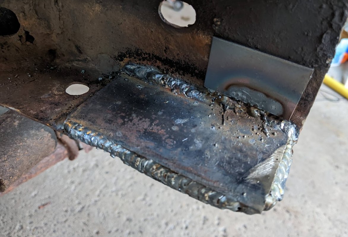

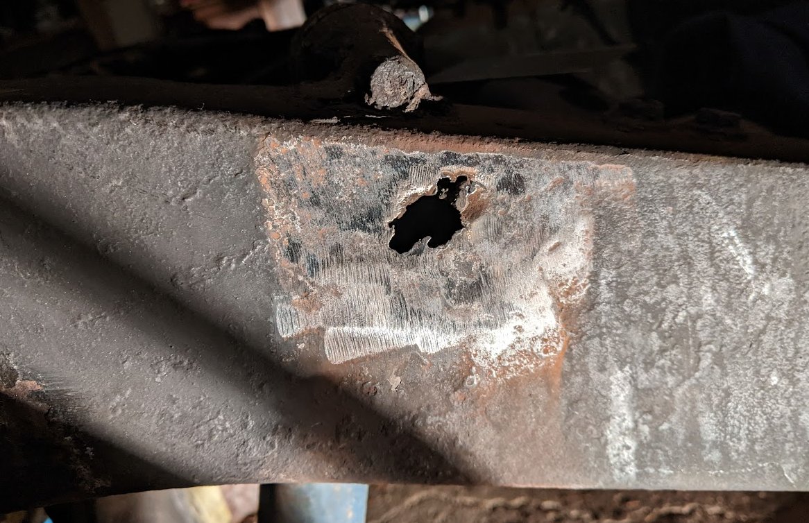

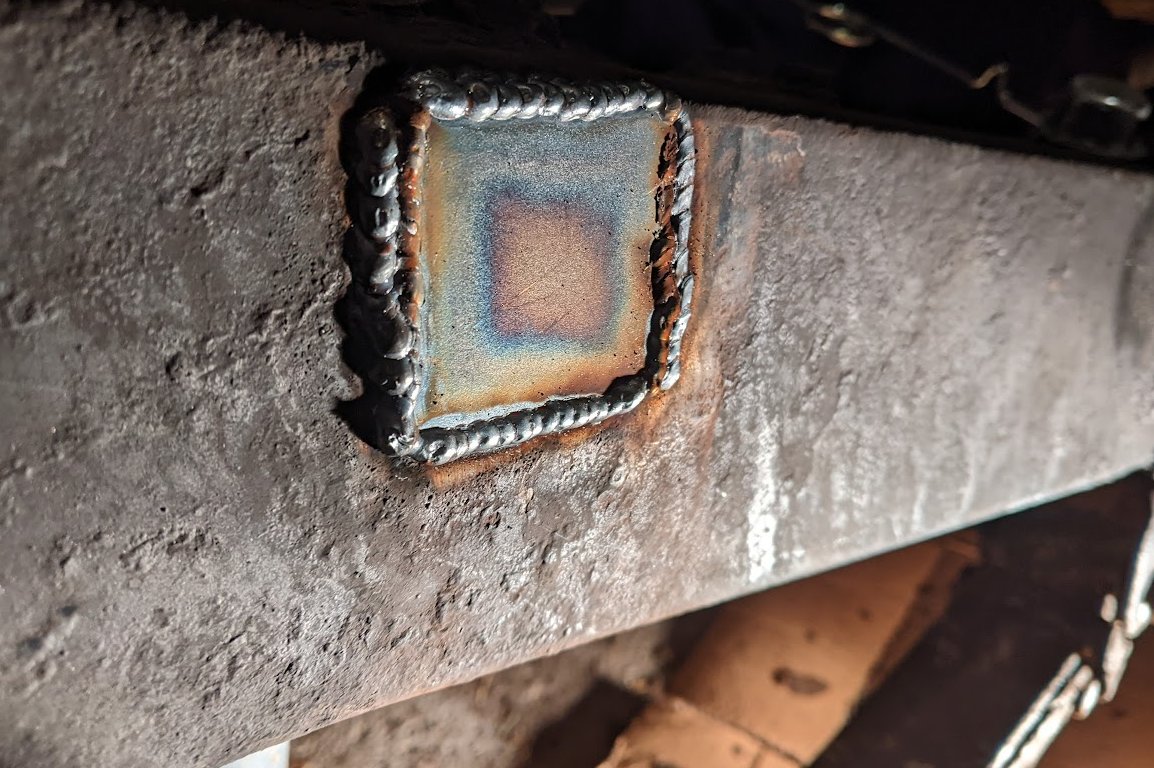

    Got my buddy to assist with some welds. Time to fix up this frame!
    WOrking on the rear where the hitch mounts:
    Welded some steel in to reinforce the lower part of the C channel. I'll get a metal bit shortly and punch a hole through this so it can accept a bolt
    Other side
    Filled in the hole to the smaller plate on the inside and ground it down
    And painted
    RustyGreen likes this.

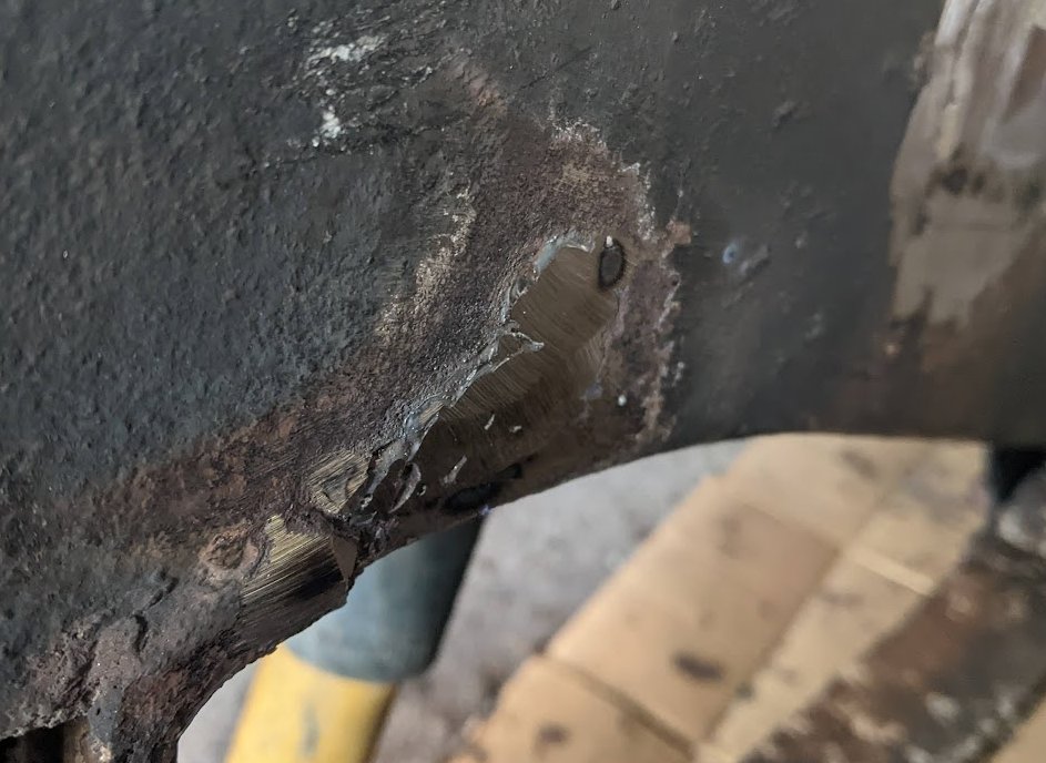

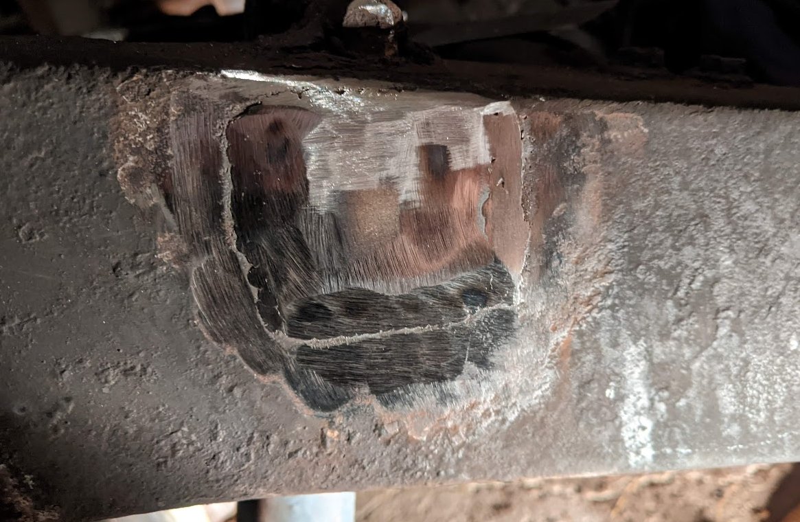

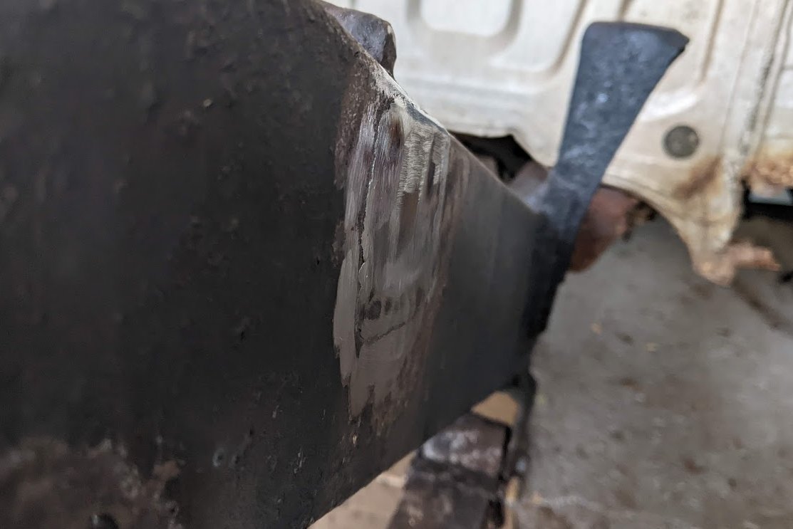

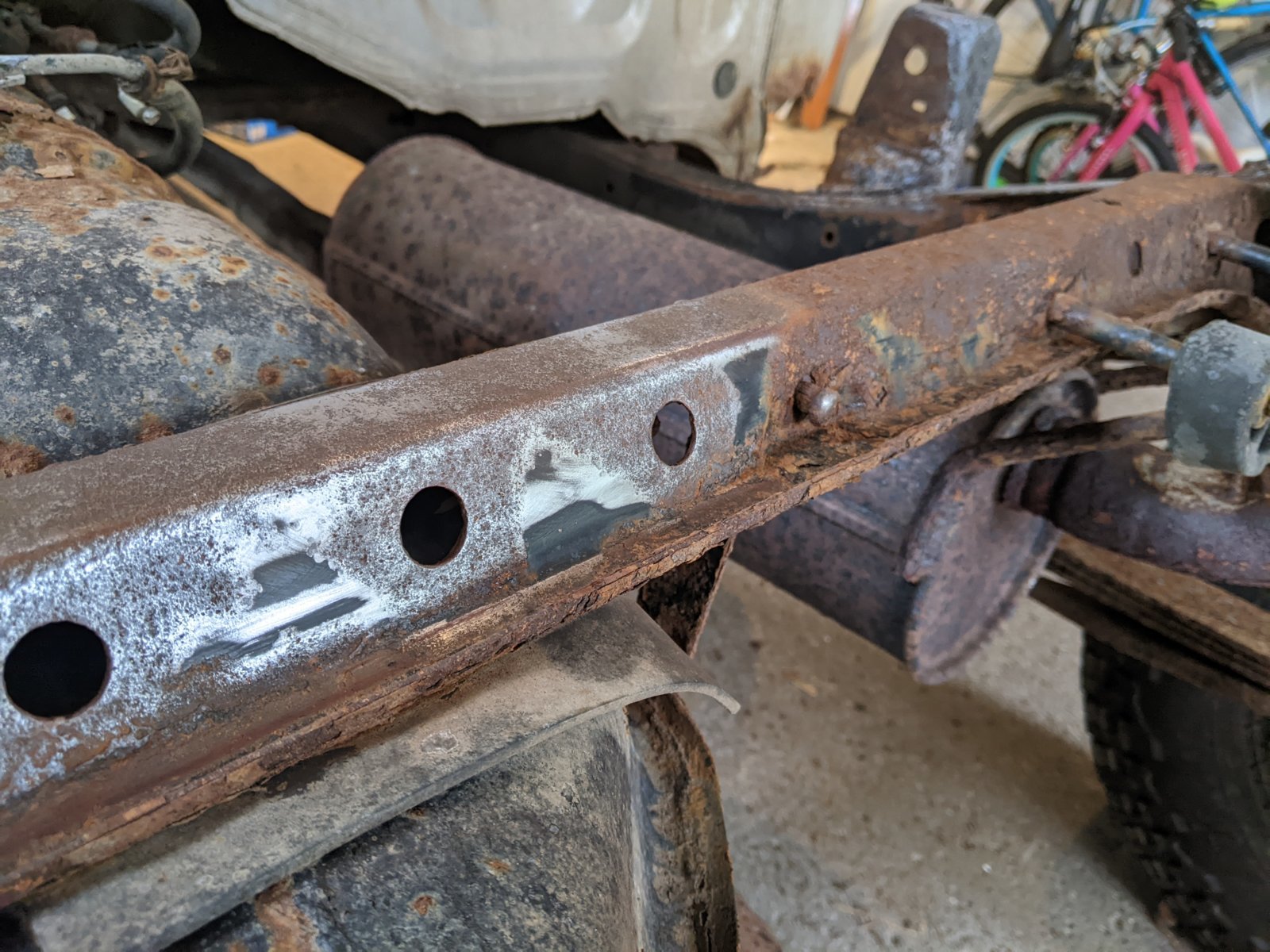

    The before:
    Cleaning up and welding a patch on the outside. We couldnt get to this from the inside bc there was a brace blocking access to it so this was the best we could do without dumping a ton of time and energy into it.
    Patched. He left big beads so it could be smoothed down and blended into the rest of the frame
    SMoothed
    The smaller hole
    Painted

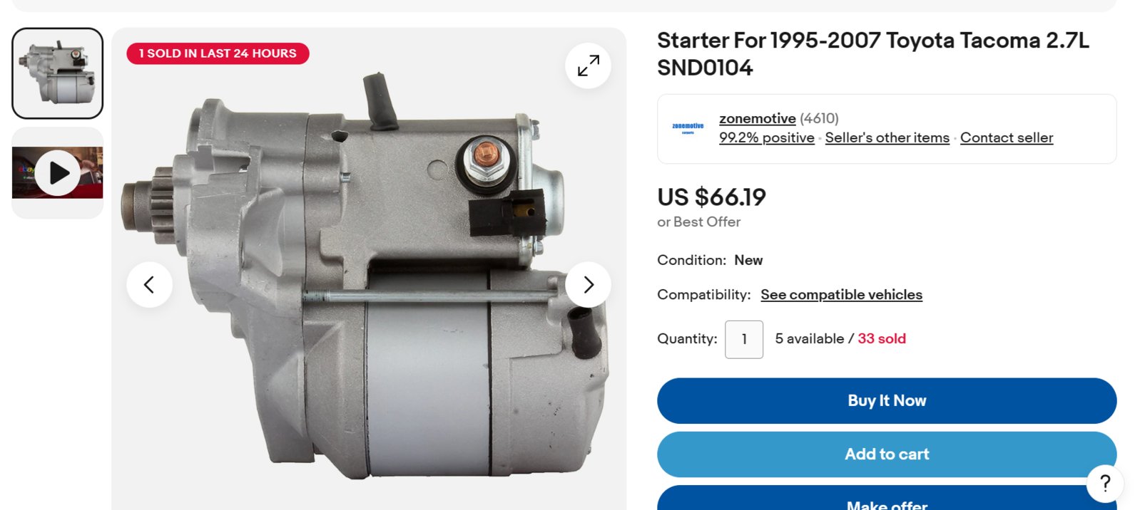

    Back from the dead. QUick update, got the filler neck bolts replaced, cleaned up the hitched and painted it and got the bed and hitch back on, everything was looking good! Then I believe my starter crapped out :mad::mad::mad::mad: Went out to start her up one day and just nothing. Even got a new battery and threw it in there and still dead. New starter motor is next on the to do list. COuple random pics
    Black97v6MT and RustyGreen like this.
  20. Mar 18, 2024 at 6:56 AM
    #100
    sid_vicious
    sid_vicious [OP] Well-Known Member
    Dec 9, 2022
    #412639
    91
    Related, anybody have any luck with these eBay cheap starter motors? Name brand is $150+, they sell these no name ones for around $60-70
