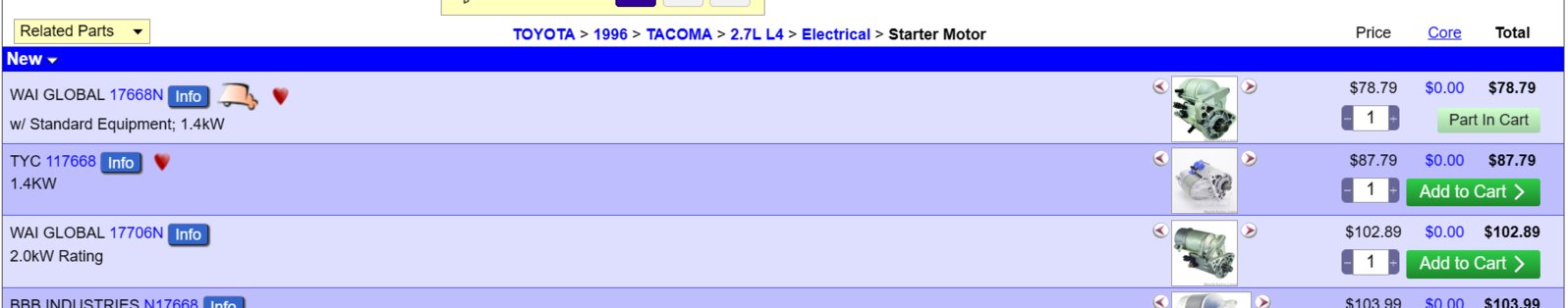

    Looks like a few bucks more at Rock auto for the same no name brand + shipping, comes out to ~$92 for cheapest option

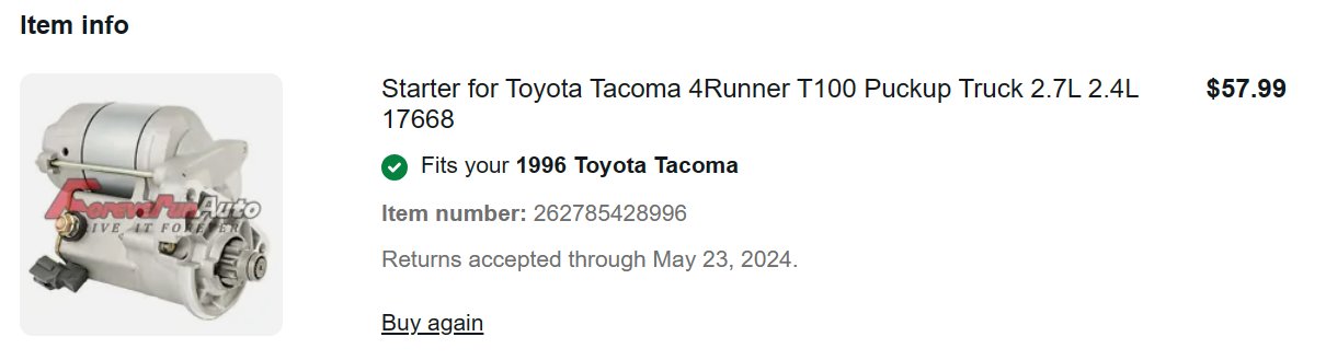

    Bought a cheap one off eBay. We'll see how it goes, I find it hard to justify spending almost 2x that price for an equally dubious item, and a name brand one is $150.

    my co-worker just did the same thing on his new body style camaro. the starter went out in early spring, dealer and most parts stores wanted almost $450. ebay wanted $110. so far, it's gotten him to work every day since.

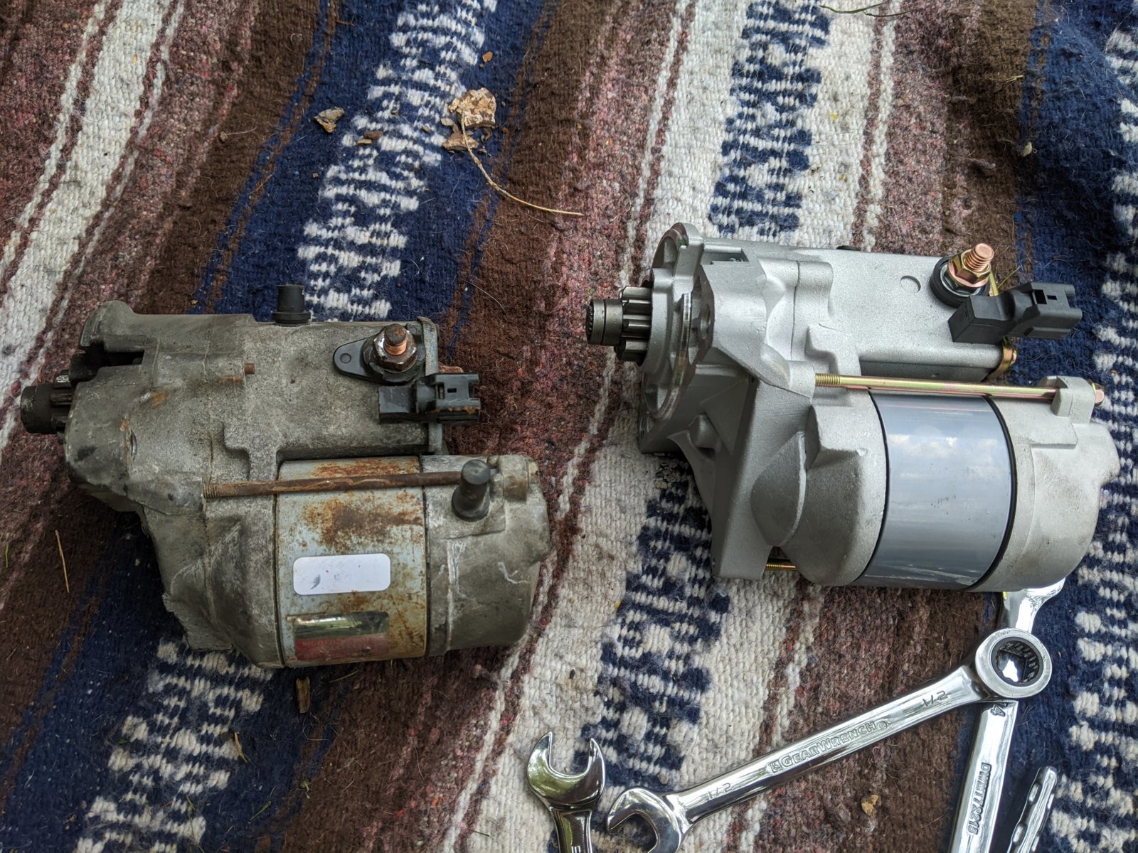

    Old starter is out!

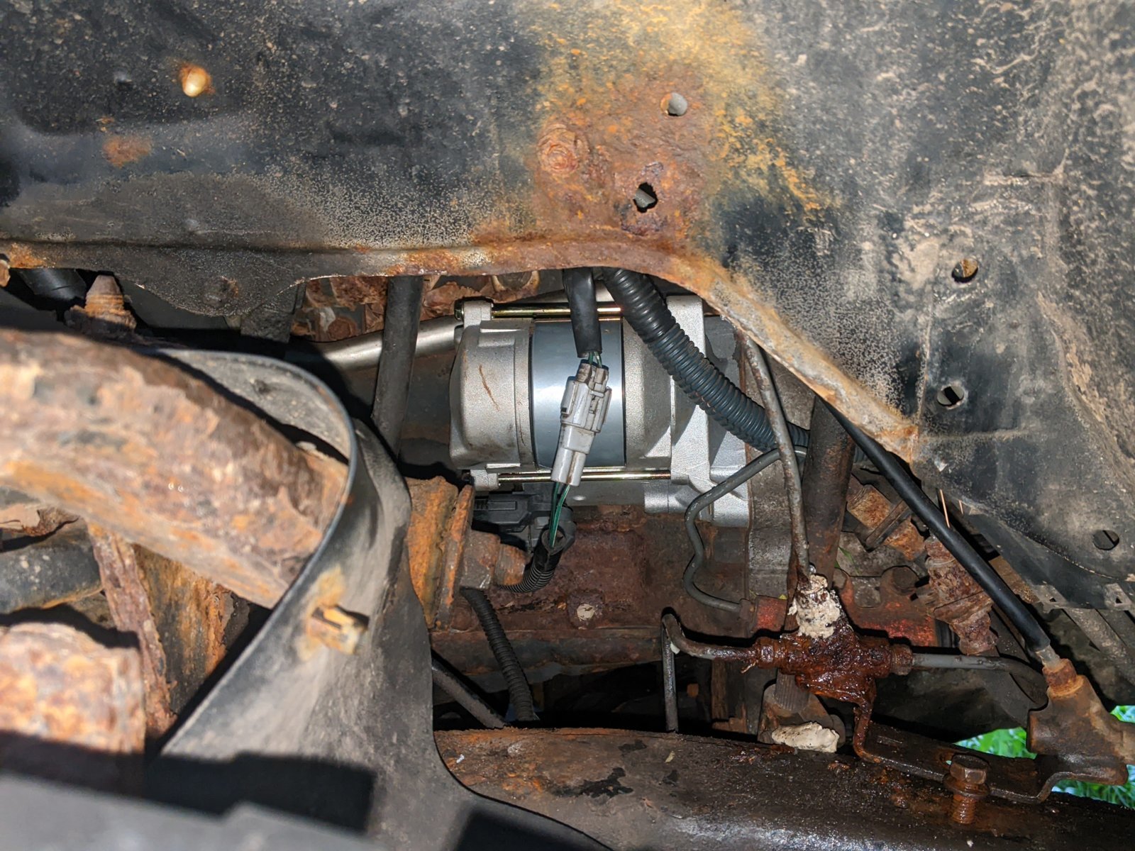

    New starter is in!

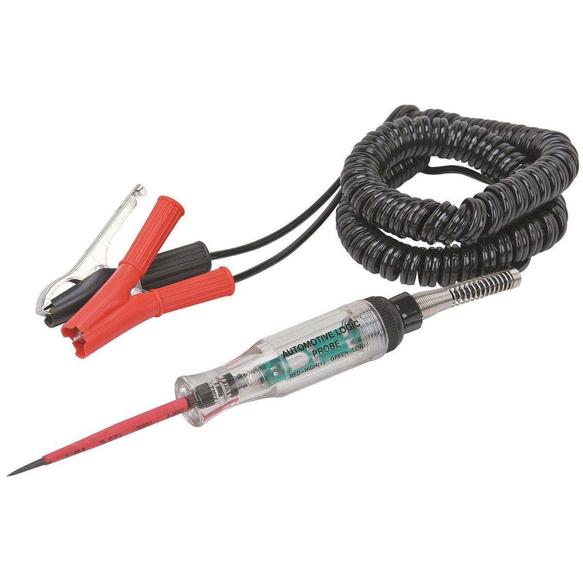

    I just got this neat logic probe from HF, it lights red for power & green for ground.
    Only $10 too.

    Bought one. My battery cable is pretty cooked, that def could be the issue, will have to see if I can jerry rig it to work or just buy a new one.

    ALso managed to create new headaches for myself in the form of breaking a rusted brake line while swapping the starter :frusty:

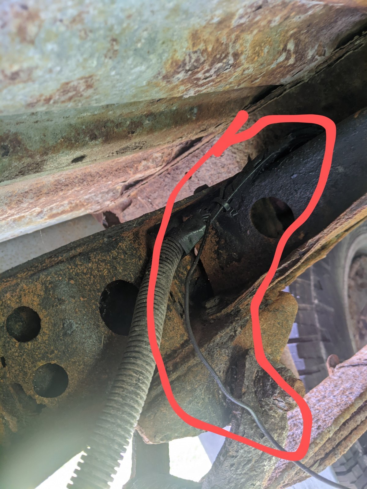

    Any idea what this mystery wire is? Looks like it's zipties to the writing harness, not currently connected to anything, I don't see a likely place it should go to
