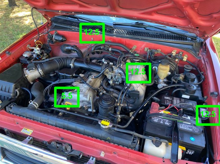

    Noticed my (new)battery voltage was dropping down to about 12 so I fully charged it last night, threw it back in this AM. Tested voltage in different spots in the engine bay, this is the results (not my engine bay fyi):
    Is it fair to assume I have a bad battery cable grounded to the engine block given I'm only seeing 5.5V on a fully charged brand new battery? I am still getting no interior lights, no radio, no dash lights, no crank.

    If you know the model engine that you have you can do a Google search including the engine model number, the year and your search terms like, "engine ground points" and that should give you all the various ground points to verify that you have all of them.
    Edit: You may also want to check interior ground points as well.

    Right, heres what I found. the EF ground is probably what I'm most confused about, I dont see a ground there

    There is a 1st generation Tacoma thread here on TW. I would post in that thread asking for pictures of that ground point from someone who has a not rusted, in decent shape, somewhat original Tacoma. That way you can compare notes with other 1st Gen owners. Plus it would not be the first time that published information was wrong. Better to get confirmation that the ground point actually exists then to chase your tail finding a ground point that never existed.

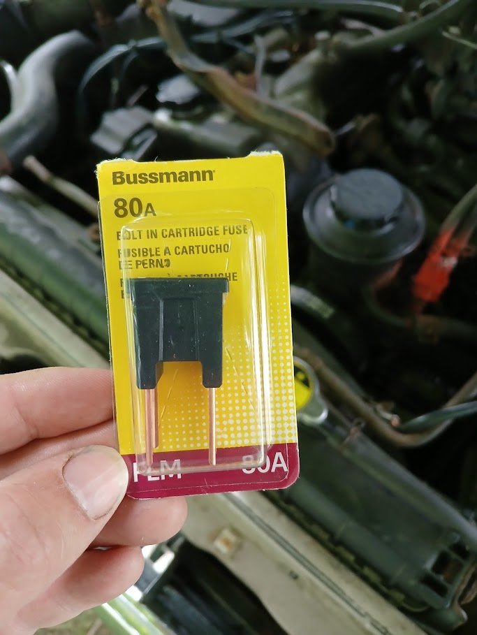

    Well the good news is I got it running. Bad news is I'm an idiot. I went and double checked all my fuses again and lo and behold, my main 80a fuse was indeed blown. No idea how I missed that earlier, I thought I had checked everyhting. I jumped that and it started right up. :frusty::frusty::frusty: Ton of aggravation and money spent it was a $5 fuse in the end. I guess the silver lining is I have a new battery and starter which were both gonna need to be replaced eventually.

    New 80a fuse acquired and installed. Starts right up now, no issues. Blew some mouse nests out the exhaust and it sounds like I picked up a new hole in there somewhere, its a little louder than I remember

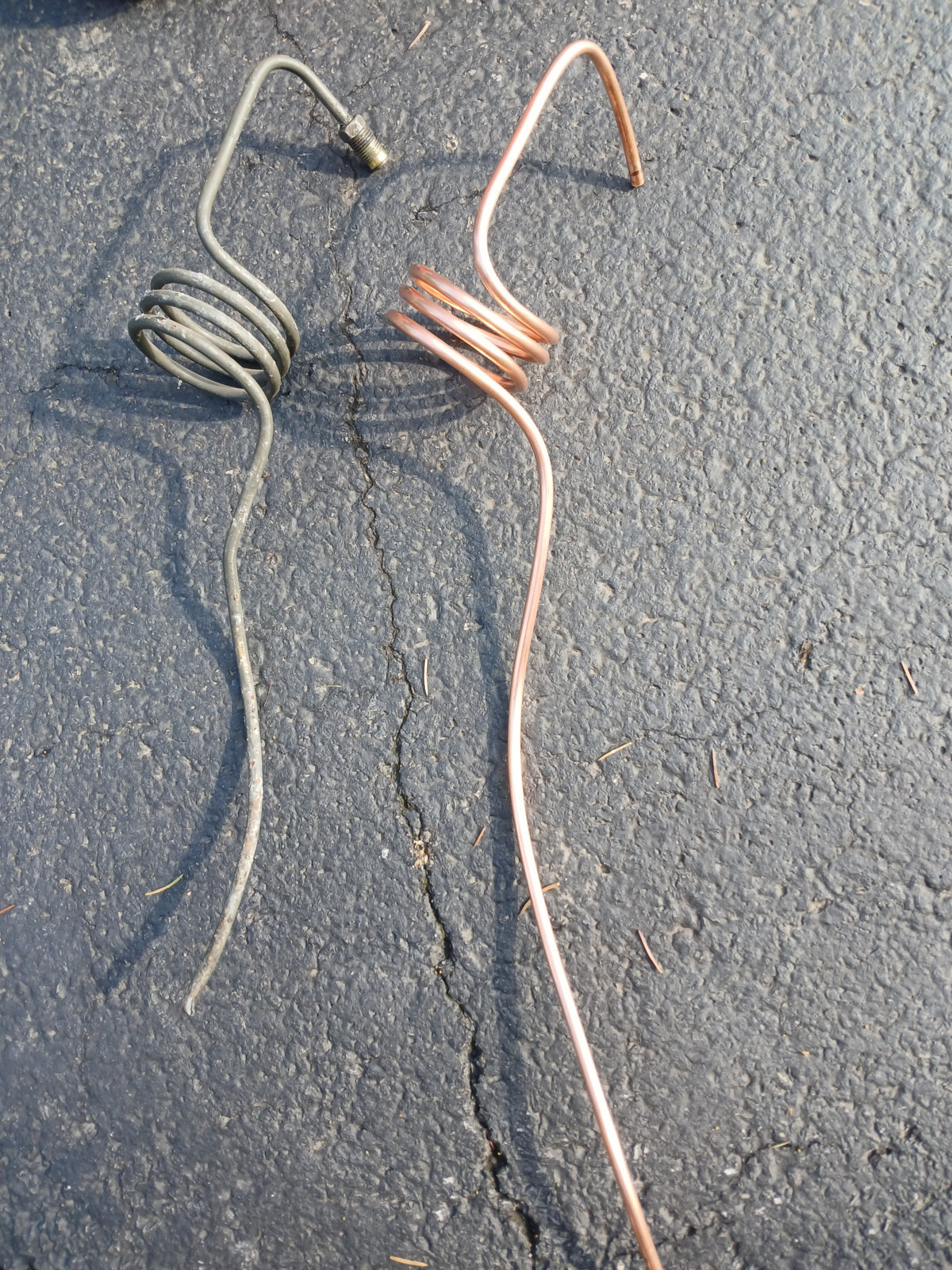

    Absolute miracle I got this fitting out. Got the new brake line twisted up, just need to get some new fittings bc the ones I have aren't long enough20240606_151129.jpg 20240606_165001.jpg
