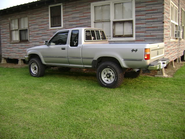

    Whew, I tried this a few months back. Having so much trouble with my 90 toyota truck I quit for a while before I break shit. I'm having engine and/or trans. trouble.

    That's a solid looking 90. 3.0 or 22re?

    Its the 3.slow.

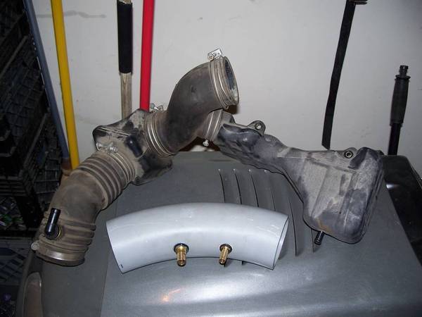

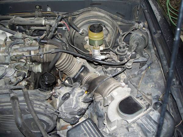

    Did the ISR mod today. For those that aren't in the know, that's the Intake Silencer Removal mod. Cost was around $25-$30 if you had to go out and buy all the pieces. I had some of them laying around the garage.
    Here is the stock intake...
    Here is the intake tubes and silencer removed. Below that is what I replaced it with(gray pipe). It allows the air a bit more of a direct approach to the throttle body.

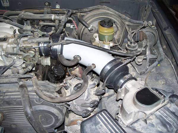

    Here is the end result.
    I like how it turned out. The only downside so far is that it blocks the oil and transmission dipsticks a little. I can still get to them, but it's a PITA. I may yank it out at some point and paint it, but I'm not too worried about it right now.
