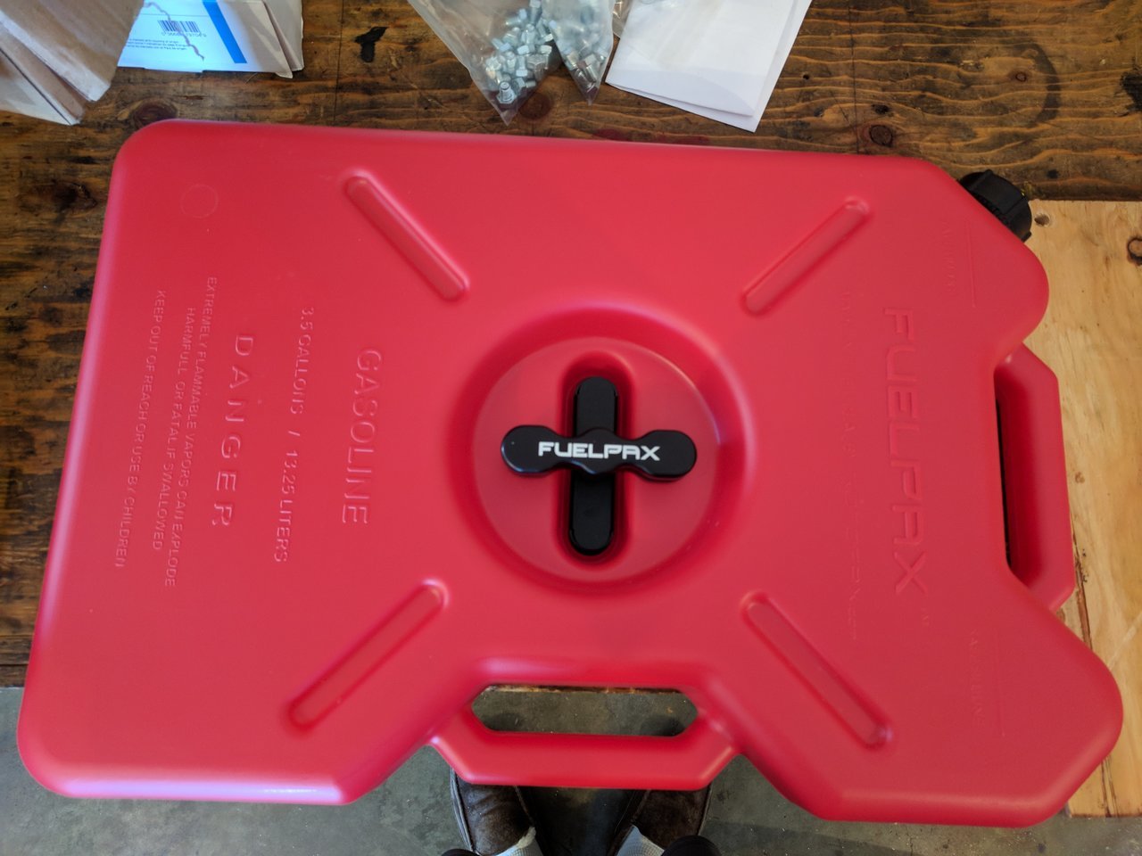

    Well I was browsing Rotopax's site the other day, and saw these, FuelPax line from them: https://rotopax.com/fuelpax/. The warranty isn't as good (1 year vs 3), and they aren't as modular as the Rotopax stuff, but neither of that mattered for my needs. Plus, they have a 3.5 gallon can, with "introductory" pricing at $50. Still expensive for a simple gas can you can get a generic version of for $15, but closer to impluse price. That with the Pack Mount for another $30, and I'm in for $80. Better than the $100 for a 3 gallon RotoPax, and another $33 for the mount, and another $30 for the 3 gallon container extension you apparently need. So I'm in for $80 where it would have been $163. So far so good.
    Not bad for $80.... I guess??

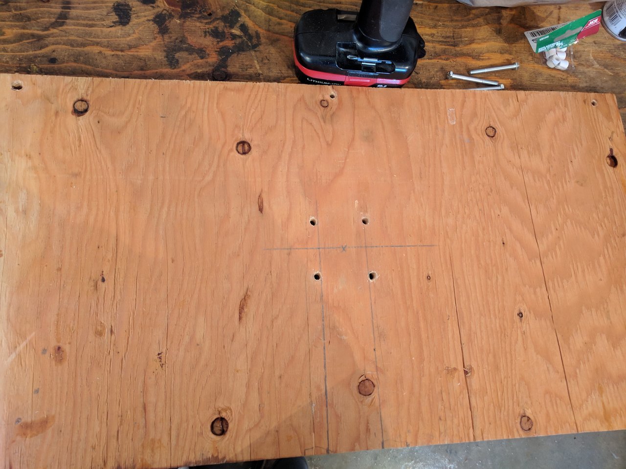

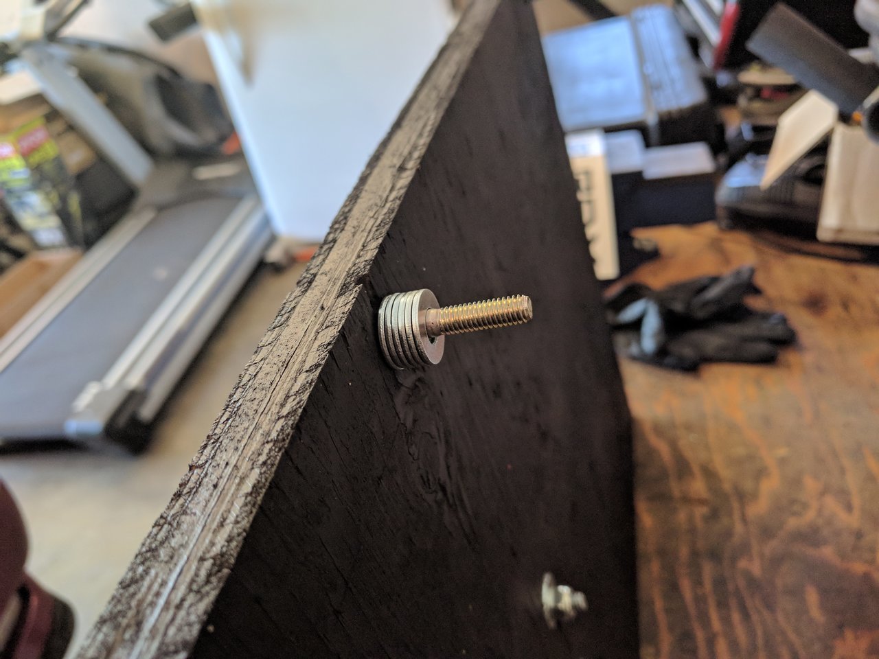

    Had a piece of 5/8 plywood laying around that happened to be a just about perfect width. Here it is marked up and drilled.

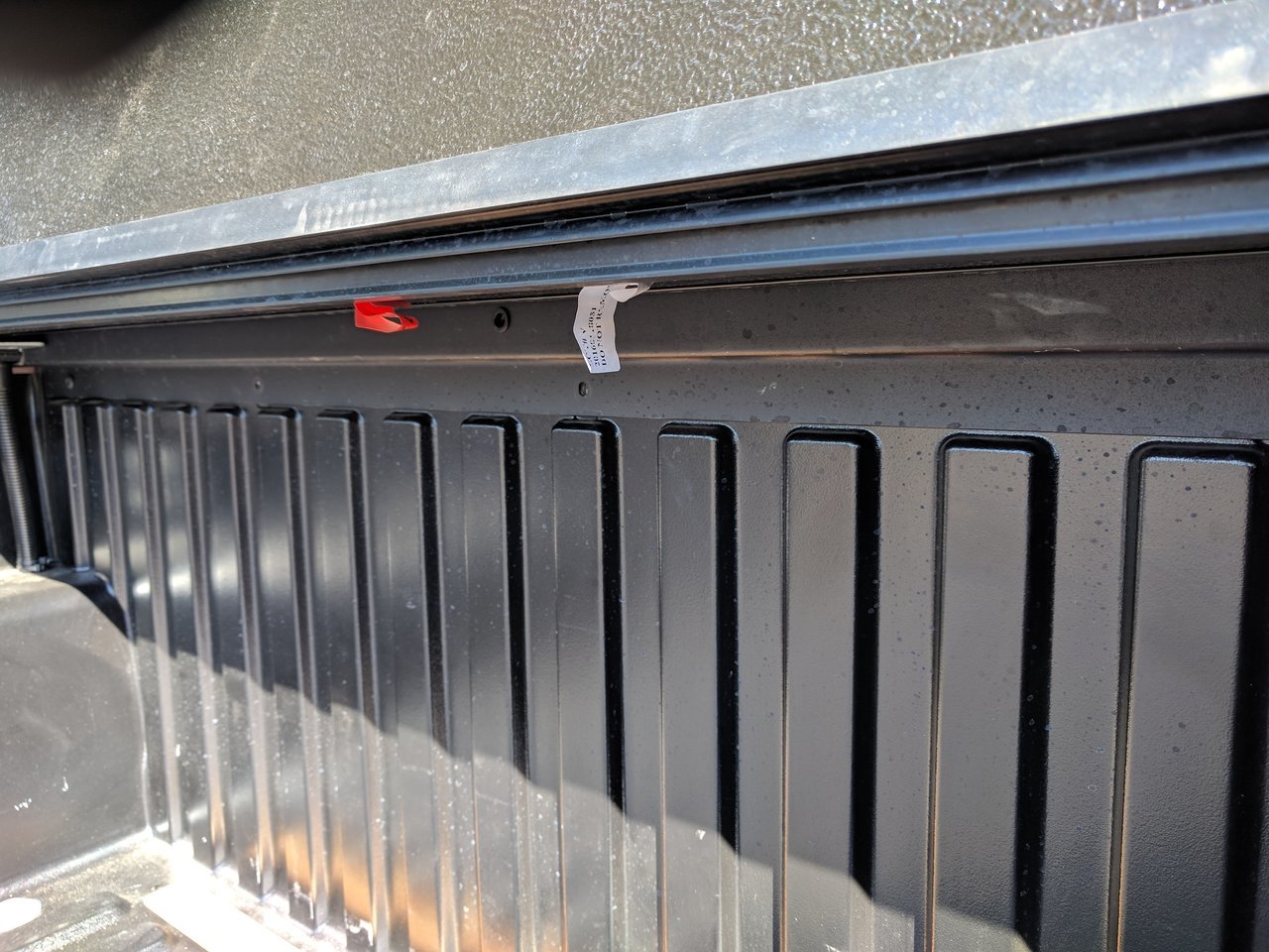

    Measured out these 3 holes here at the top of the bed (where the rail would normally mount):

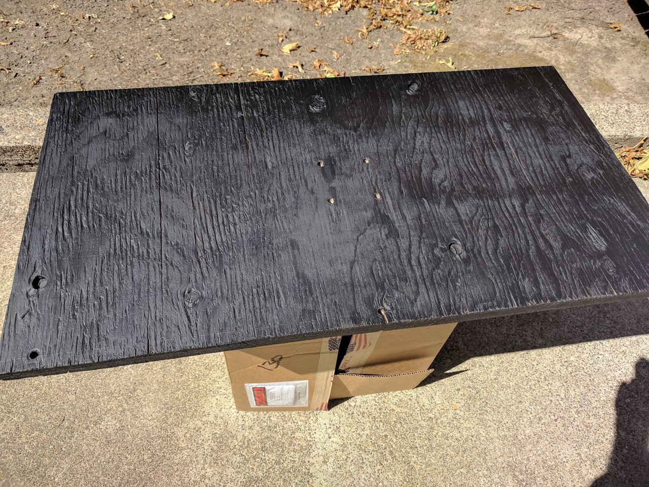

    Cut the plywood to length to sit across those 3 bolt holes, drilled out for the Pack Mount, and painted it black.
    got some metric hardware from the hardware store, and some washers. It is M6x1.0 bolts, I got 50mm long. Because of the ridges of the bed, I need to shim out, used some washers for that.

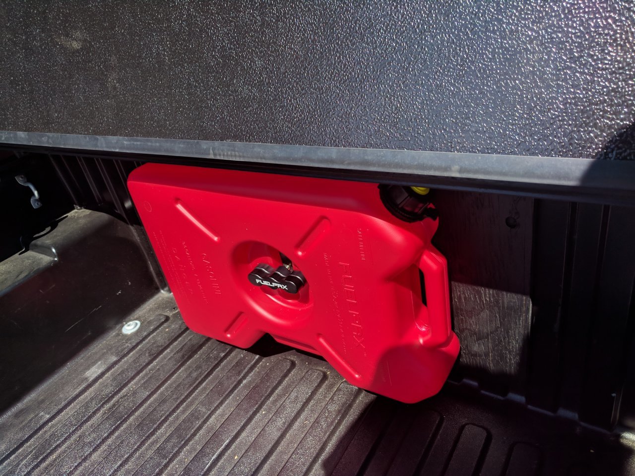

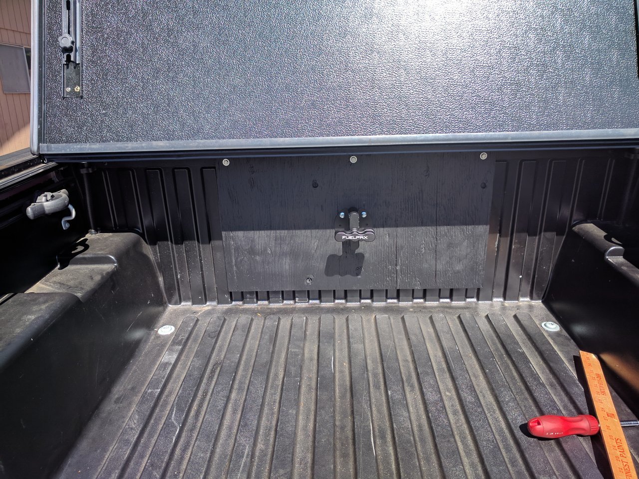

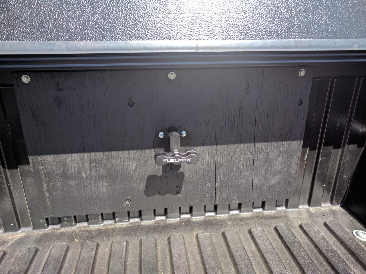

    Here it is mounted up. Seems plenty sturdy. Biggest concern is it might rattle against the bedside and make annoying noises... we'll see if that happens and address it if need be.

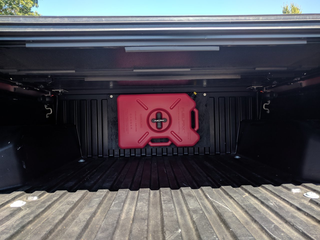

    Here's the fuel pack mounted up. It doesn't protrude past the final piece of my Bakflip VP, so it's tucked up nice and out of the way. If you are curious, yes, it is "supposed" to mount rotated 90 degrees from how I have it, but for obvious reasons doesn't fit that way. But when filled to the fill line on the container, the spout is still well above the fuel line even how I have it mounted. Should not have any problems with leaking!
    Looks good stashed in there, waiting for the day I need it!
    I put some fuel stabilizer in there so I don't have to worry about it too much... but I'll probably rotate it out every 3 or so months, as I think about it.

    LOL... it does indeed rattle when going into reverse. Just a bit. Doesn't seem to going forward. We'll see how annoying it is... might put a rubber door stop or something similar on the bottom.
