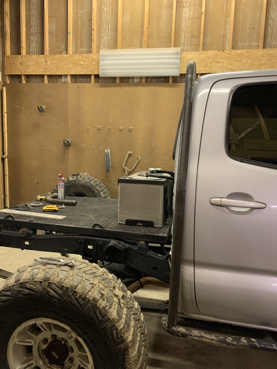

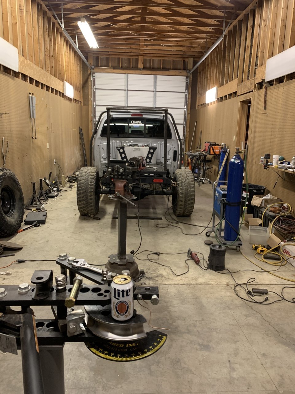

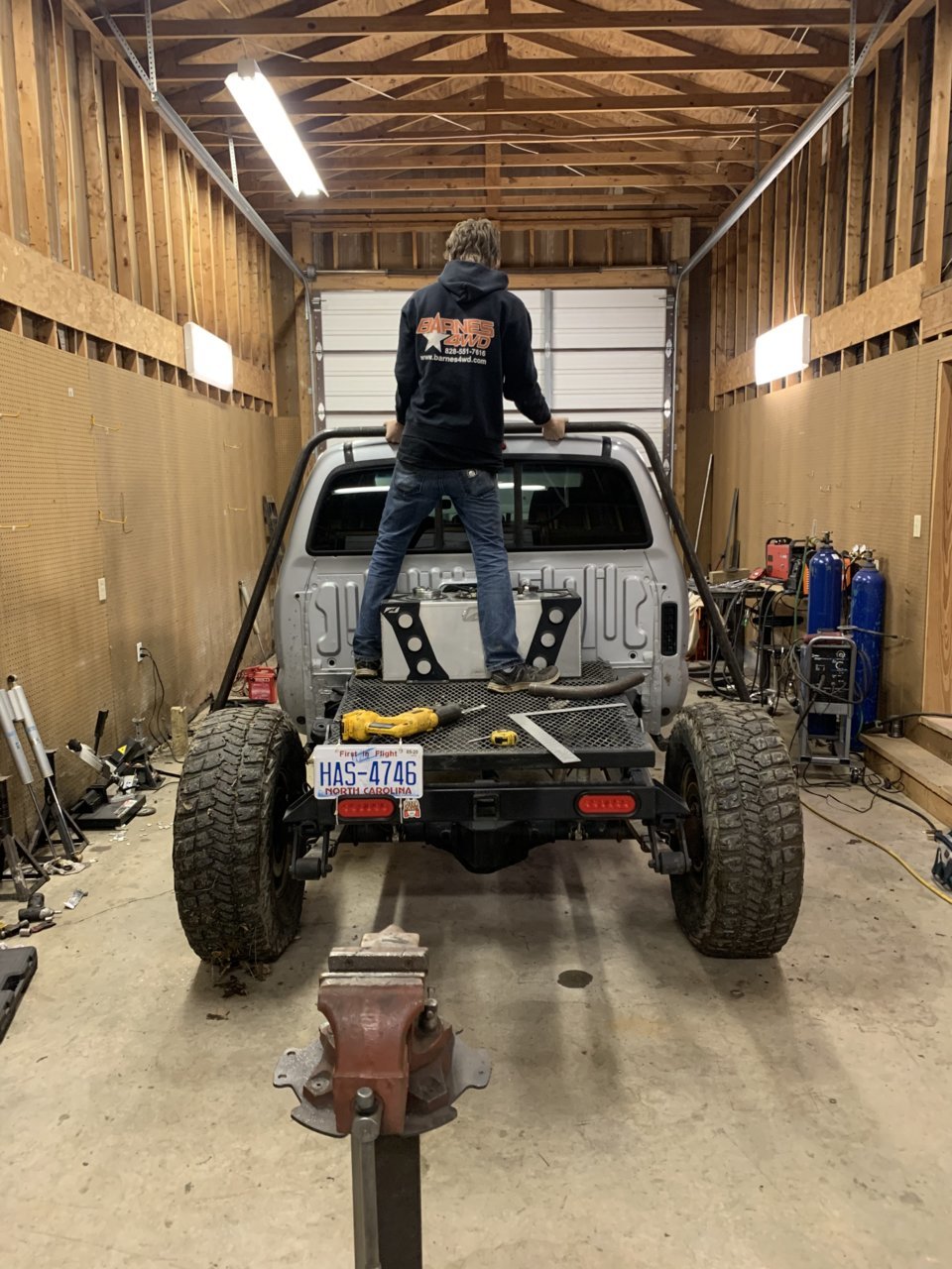

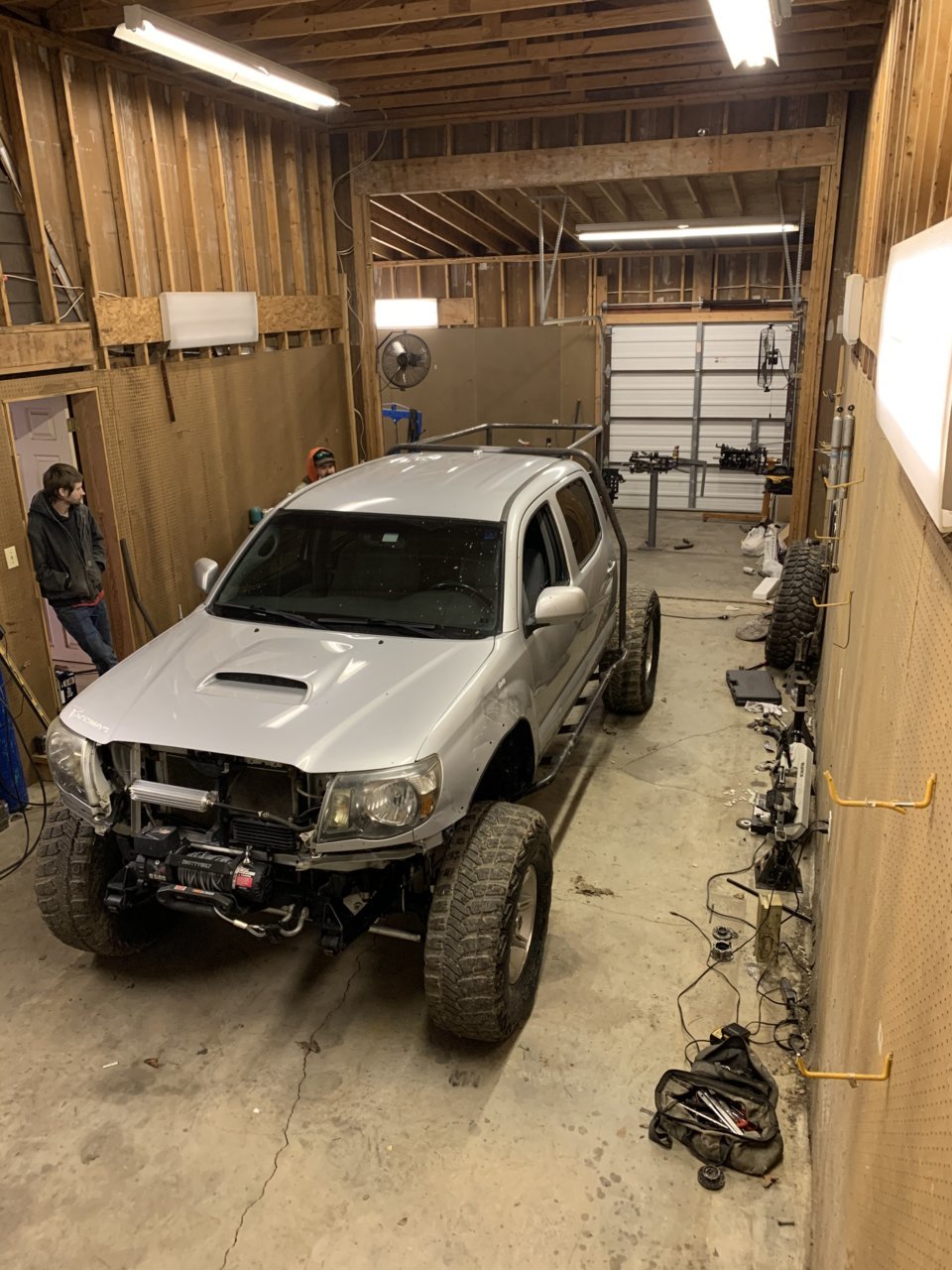

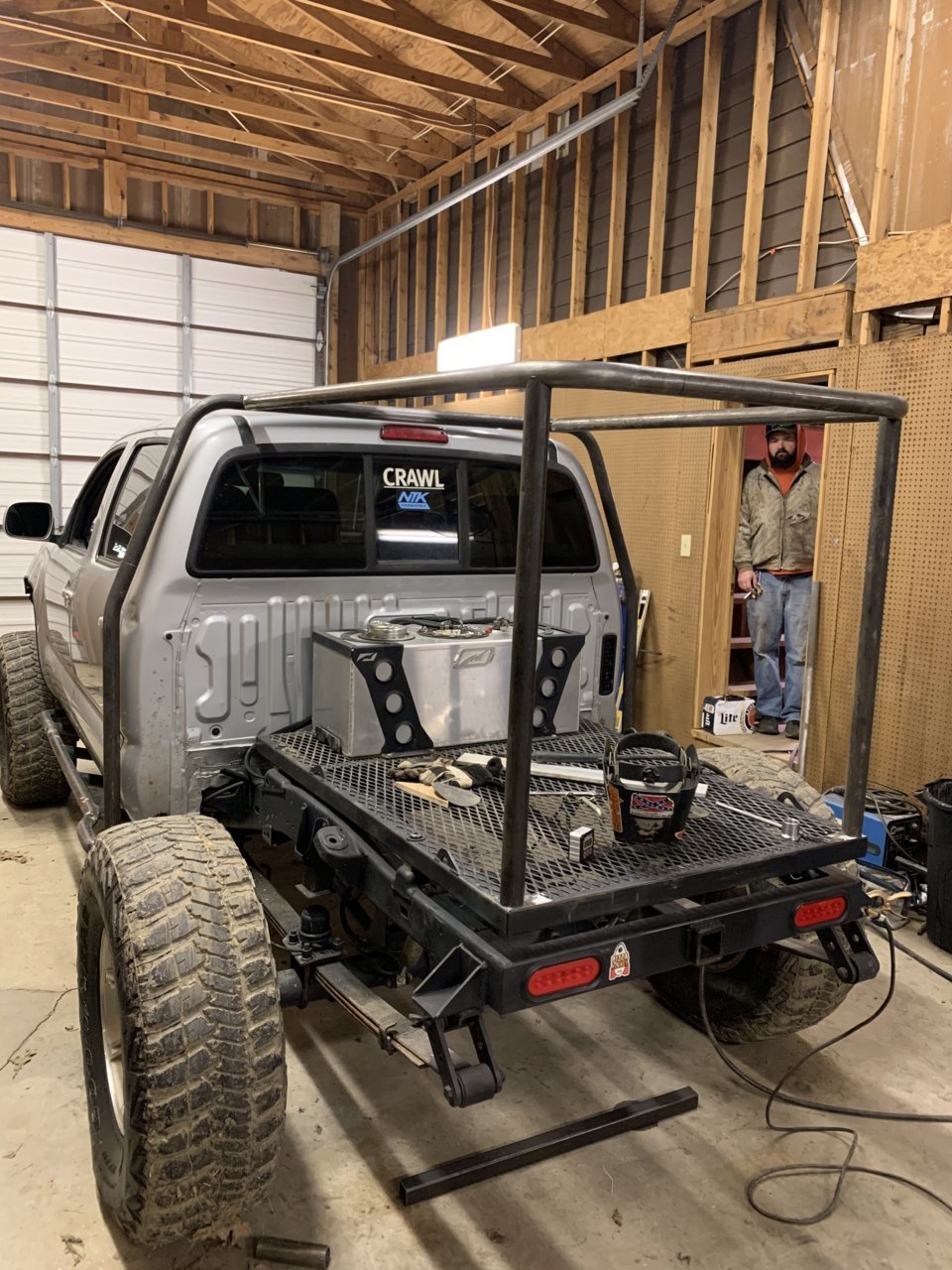

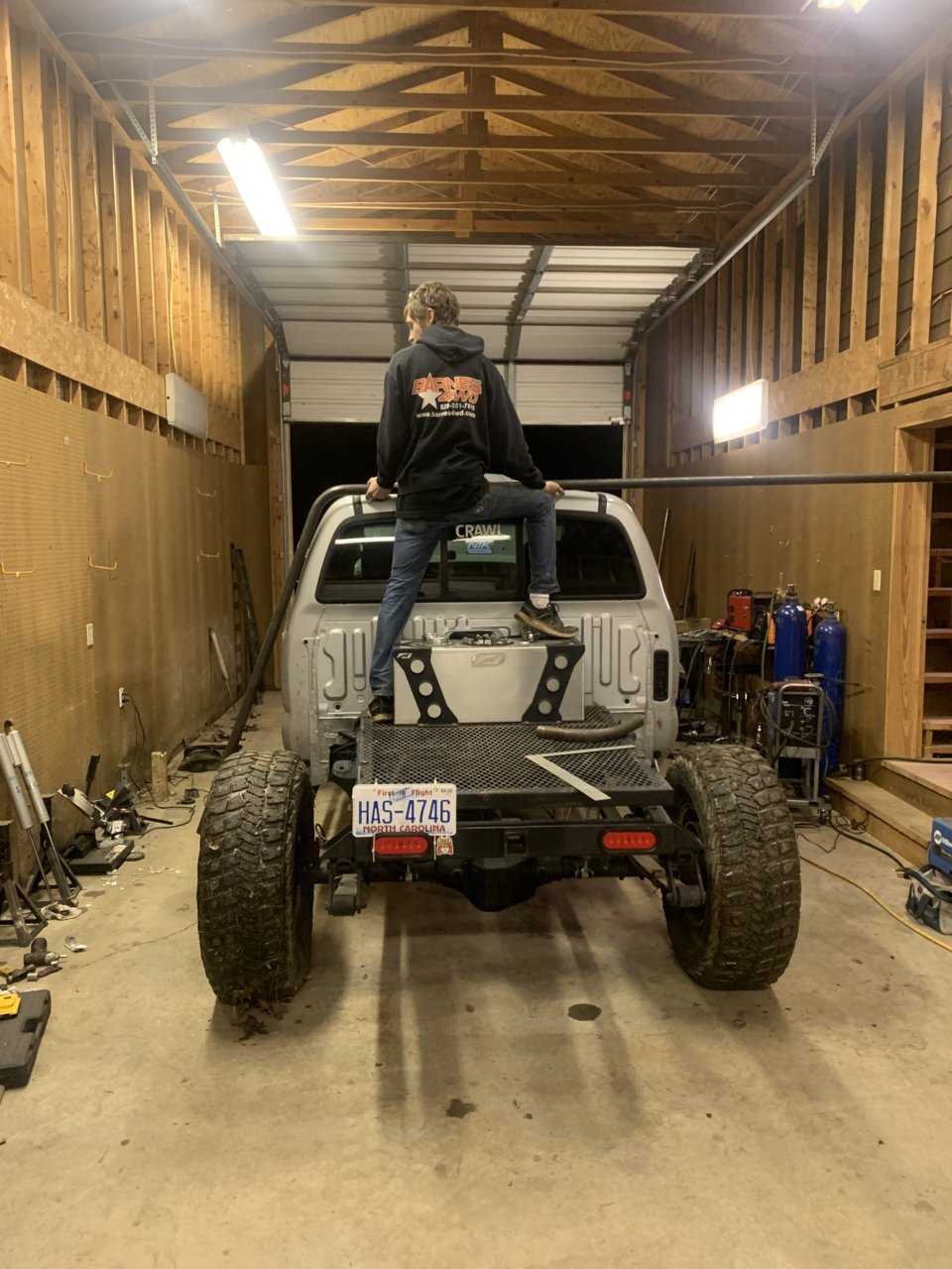

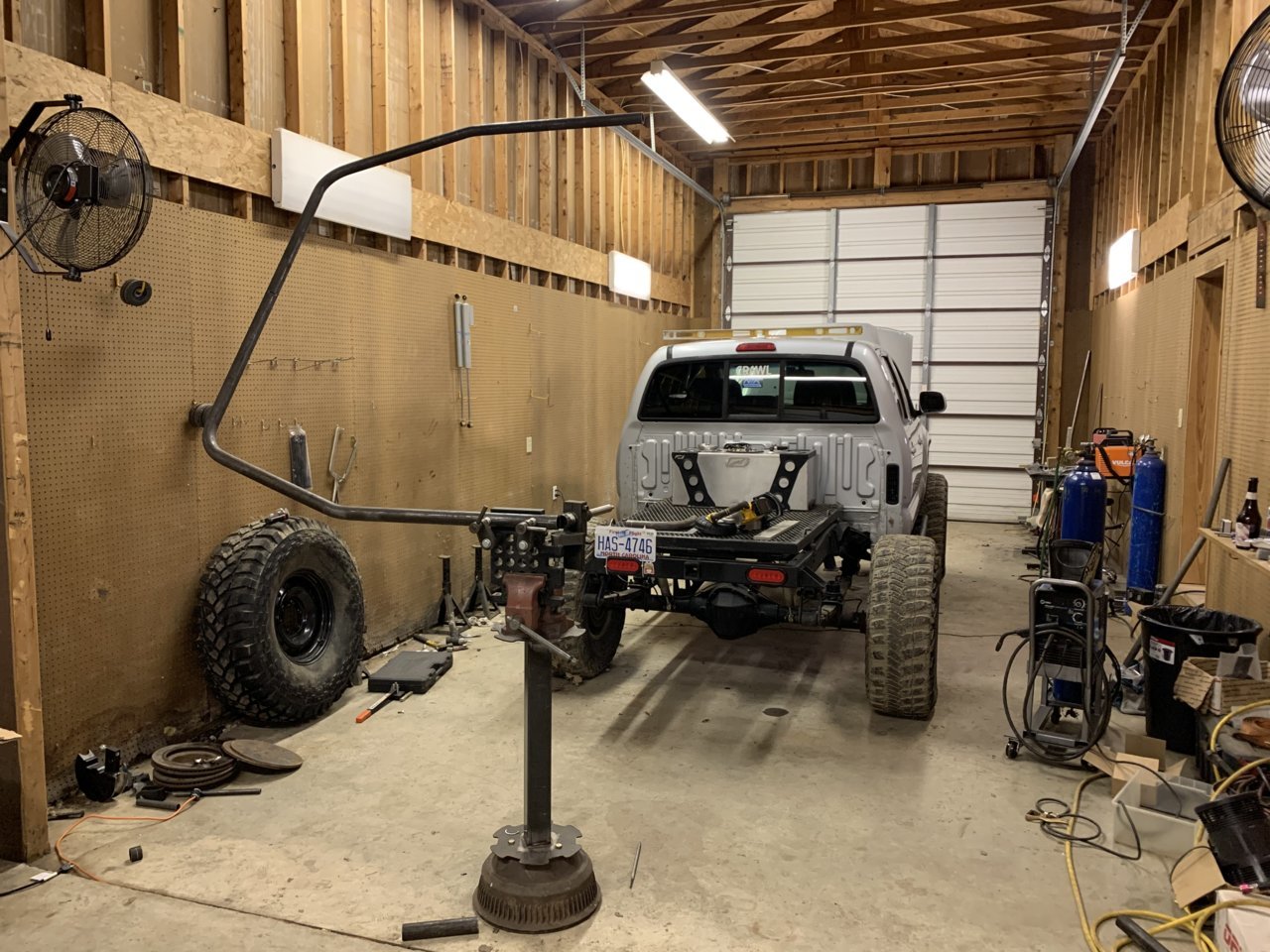

    Been busy working on the house. Renovations for the wife and what not.
    Found bit of time tonight to work on my roll bar/cage. Main hoop is bent up. Gonna do a ladder rack style with some X braces for side impacts.
    C915E444-FB10-4403-80D0-02E414B7D6FF.jpg 5C2BAFBD-F9BB-4609-9148-EBB6F9A8FEFE.jpg 62B5D1CB-1904-442D-BD33-F22E953919E2.jpg C96CB1FD-7BFD-4837-A502-094CA7E6B8DC.jpg A52D1C2B-9993-46CD-8A1C-E5217826FEDC.jpg

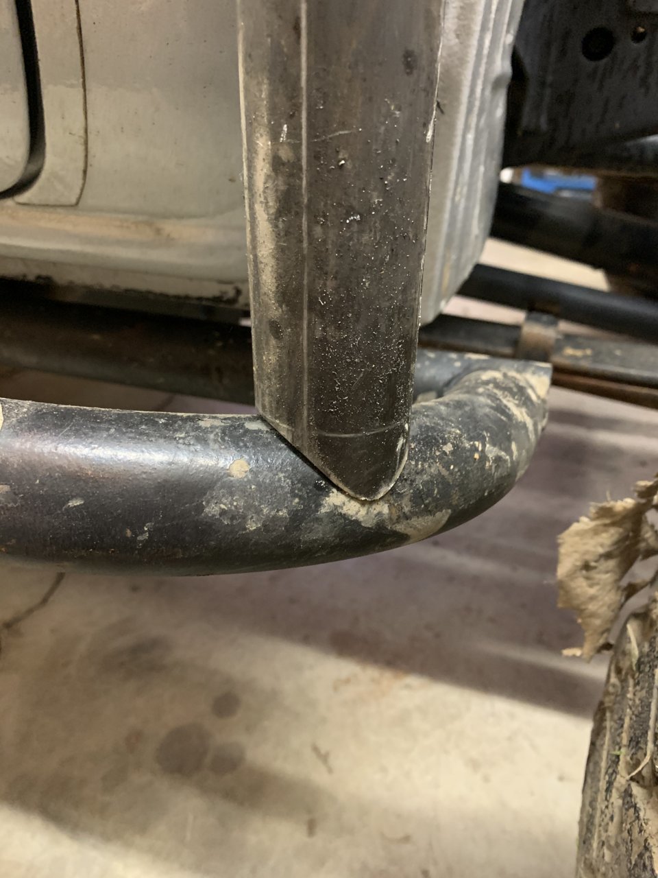

    angles were tough to figure out for the notches, but turned out perfect.
    CA18A17F-E468-483F-8F1B-D0FDB3A8BFDA.jpg 4EE9870D-DFB1-4C96-AE3D-786351957B29.jpg

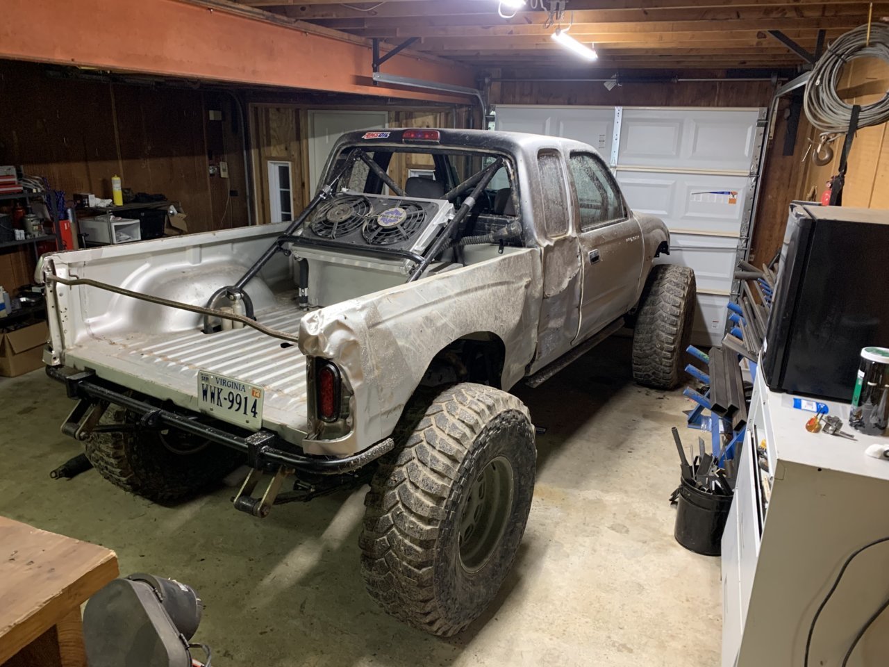

    A buddy of mine and I split the notcher and bender a few months back. We’re still figuring it out so there’s a slow learning curve.
    Here’s his tacoma we 3 linked a few months ago.
    whatstcp, 05Taco4x4, RCRcer and 2 others like this.

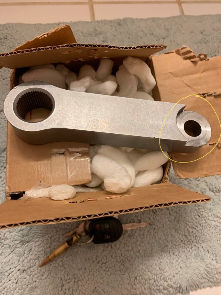

    Planet: EARTH
    You bought the pit from sky pre-notched, circled in yellow?

    Dana 60 F&R
    Yep. It didn’t show it on the website but I was pretty happy when it showed up that way.
    Probably has to be that way so a TRE will fit through.
    I bet a hole for heims wouldn’t have that notched out.

    Too many to list
    I bought the sky pitman arm bored for a 3/4 bolt so I could use my heim joints. It came notched like that, let's the bolt head sit flush so I could hug tje frame even closer with the arm.

    Dana 60 F&R

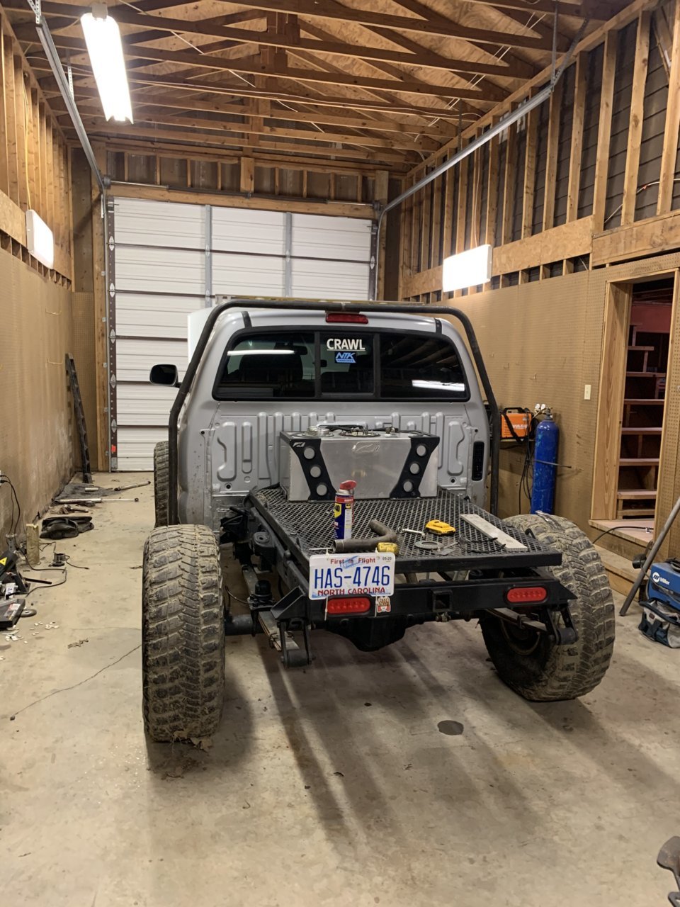

    Alright, I need some opinions. Here’s what I have tacked together. Need to pull it out of the shop to get a better view of what’s going on.
    What should I add to this main frame or change before burning it in?
    I plan to add an “X” right behind the cab for side impacts. I need to brace it front to back too somehow. And I plan to add a rack just below the window above the fuel cell ran to the back for a cooler etc.

    63s, XD Machete, Beat not Babied
    Too square. Run it back then angle it down and just be vertical in the very back for like a foot or so. Unlesd you plan on doing something like WheelEveryWeekend on IG then it looks good
    Jojee117 likes this.

    Dana 60 F&R
    I wanted to keep it somewhat level up top for hauling stuff up there. Kayak, lumber, metal, whatever. I do think I could drop it a little in the rear, but I don’t want to drop it too much.
    it would probably look better lowered, but I’m more about function on this than looks.
