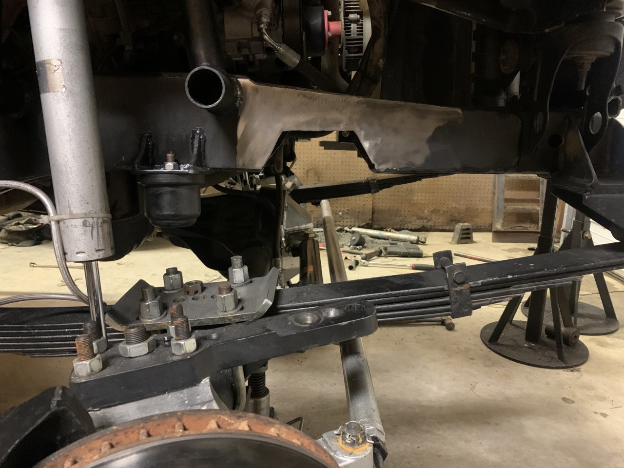

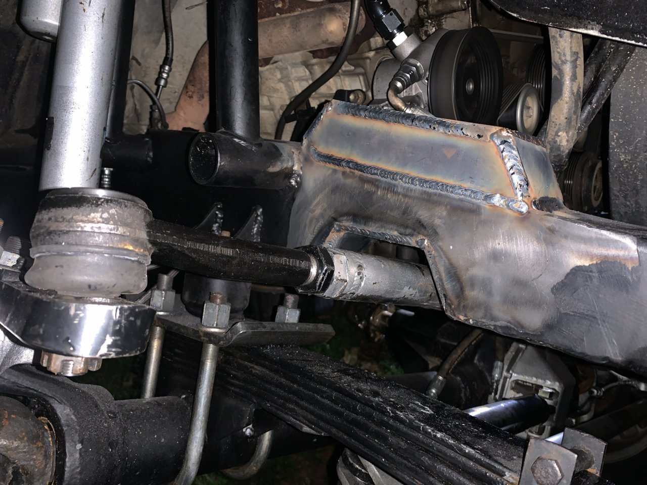

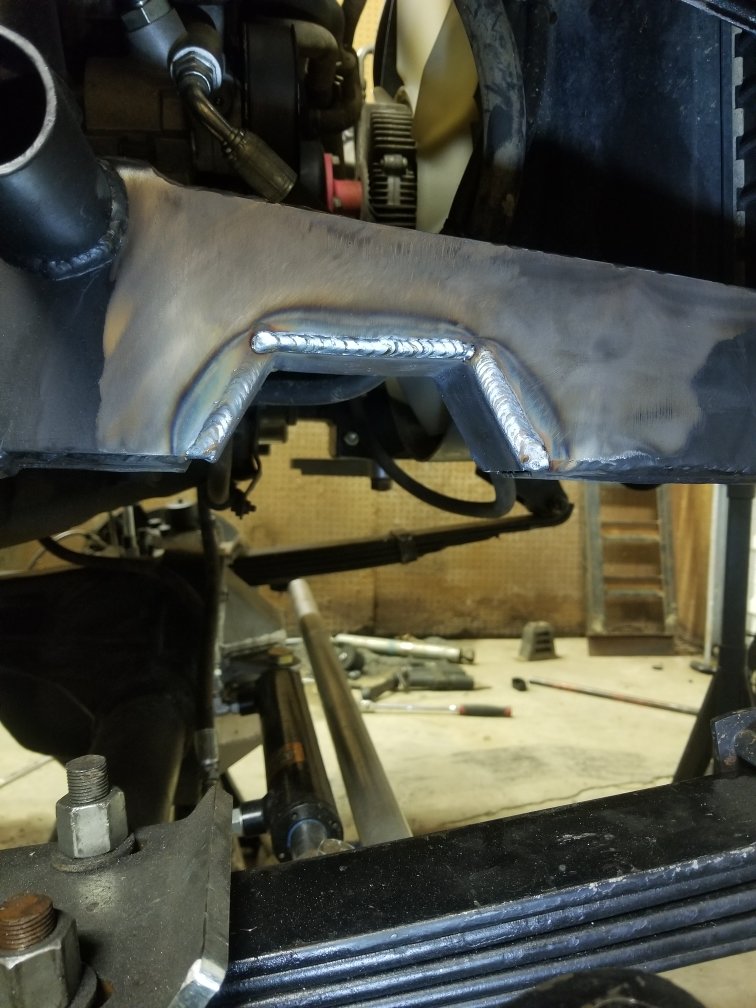

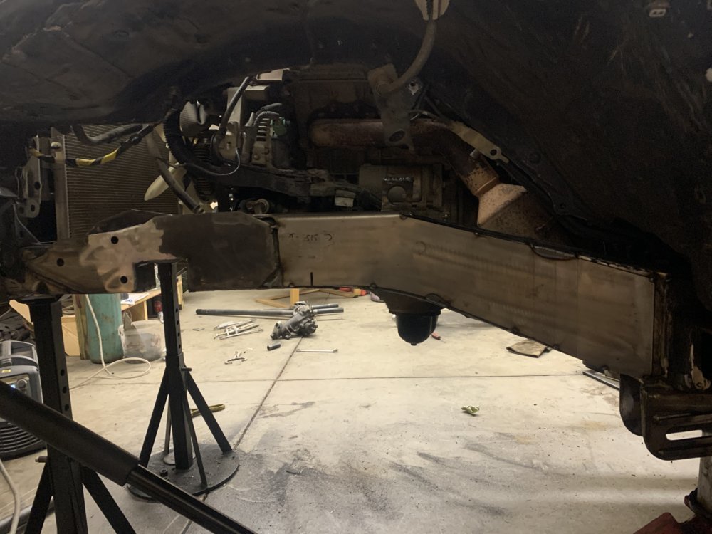

    Frame on passenger side needed some clearance for the drag link.
    Still need to add more to the top of the frame to make up for taking half of it out.
    Maybe add some tube from the shock hoop forward to help strengthen it up.

    I've got to do this to mine. I'm going back and forth between notching and moving the air bump and limit the up travel.
  8. Mar 25, 2020 at 8:55 AM

    It’s not too bad to notch it. I’d always prefer to have as much up travel as possible.

    Some of those welds are very inspiring! Nice job so far

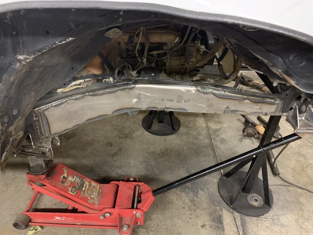

    Notch helped. Seems to clear now.
    Flexes okay for leafs. It’s on a 40 inch trep

    You see that Skip sold gulches? I'm getting pretty antsy with everything going on. This is getting pretty boring with the shut downs.

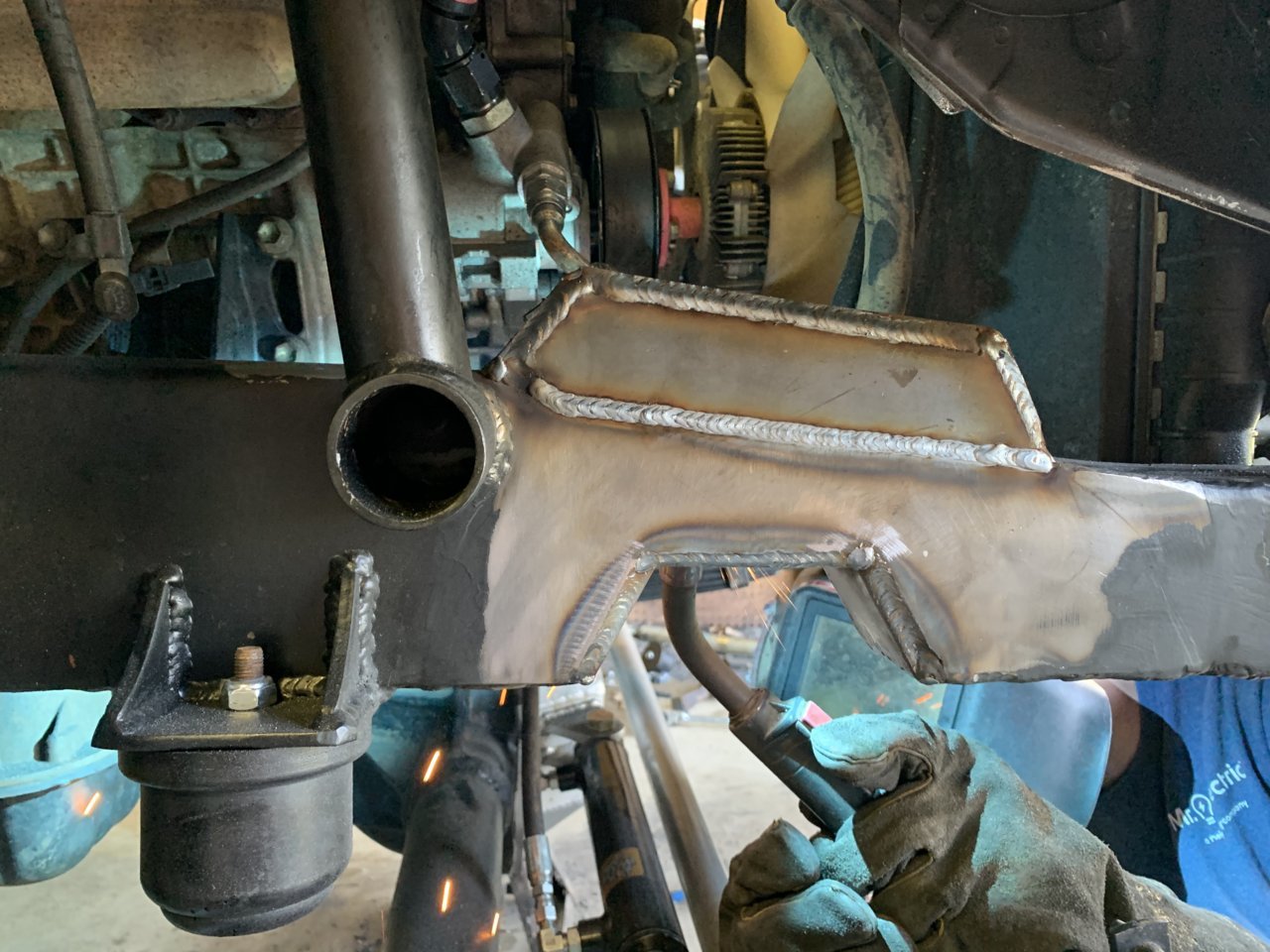

    Question why didn't you plate the frame to stiffen it up. Most guys I've seen plated the front half of the frame to add some strength especially with a steering box.

    Yeah, good for him. Hopefully he made some $ to retire with.
    New owner is supposedly upgrading a few things. (Hopefully the parking lot)
    frame is plated. Back in page 1.

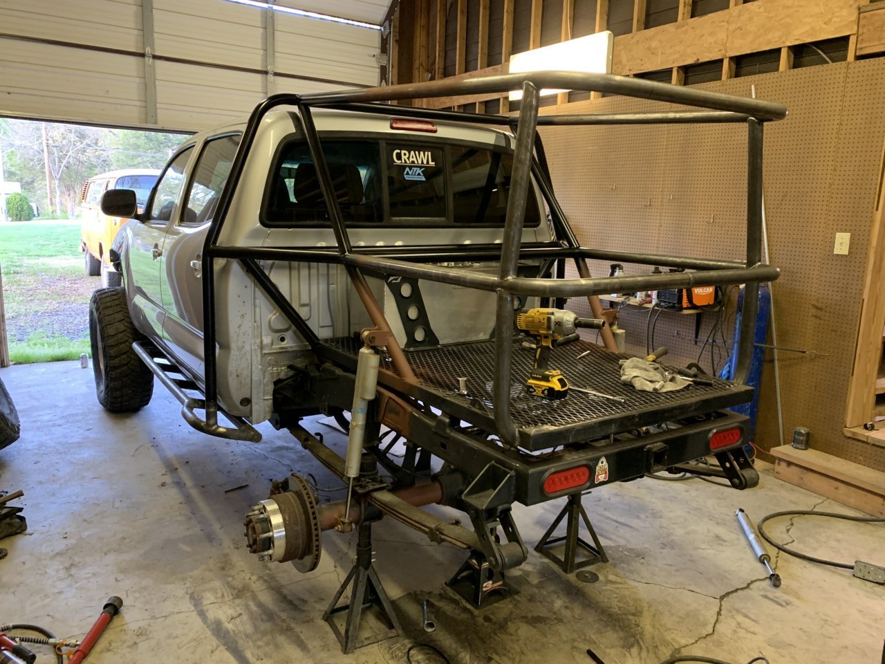

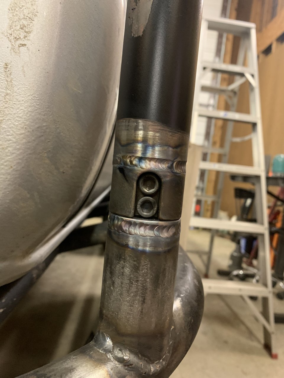

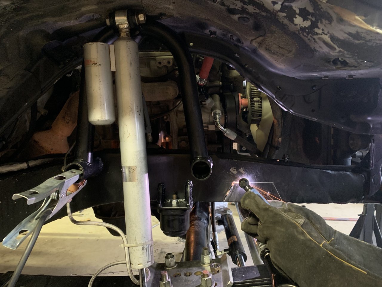

    Took the bed off to finish welding it and add a little more bracing.
    Hopefully going wheeling this weekend. Been way to long.

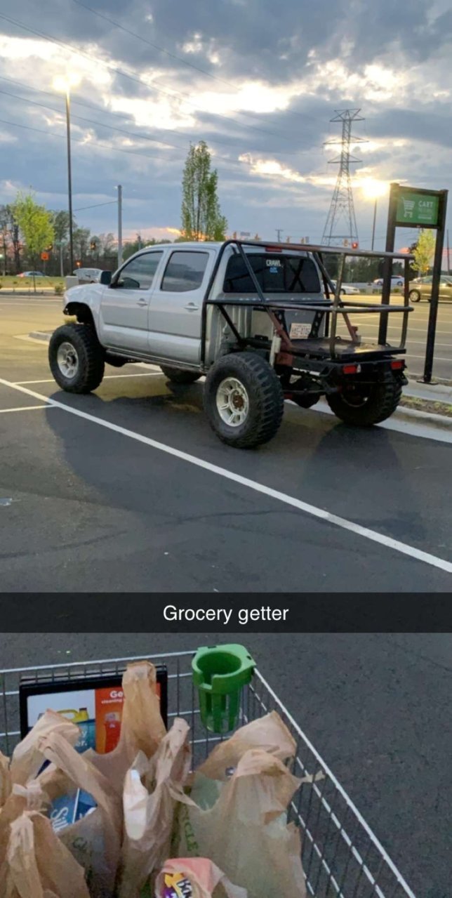

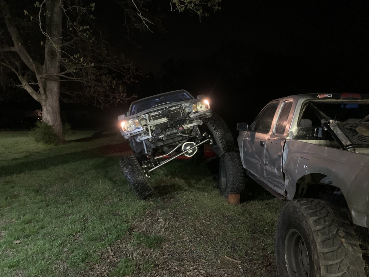

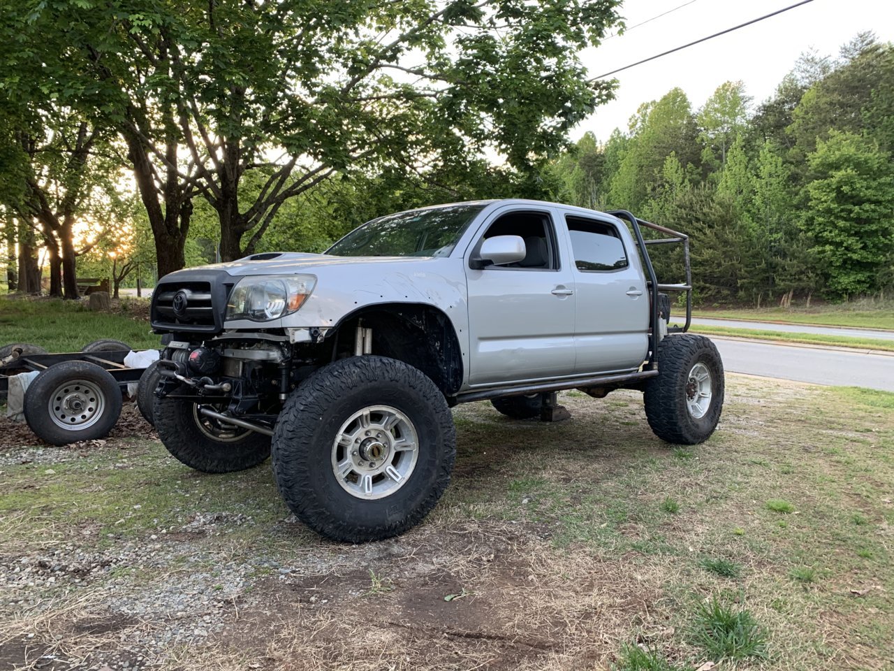

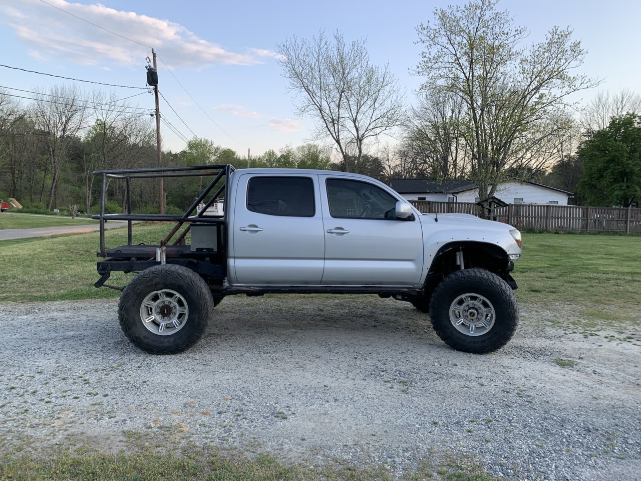

    Didn’t make it to Gulches. Tow rig decided to take a dump.
    So I relocated the shocks and I’ll just daily this for a little while.
    Also made the bed removable.

    Looks a whole lot better and lower with fender flares.
    Need to order the correct fasteners for them.

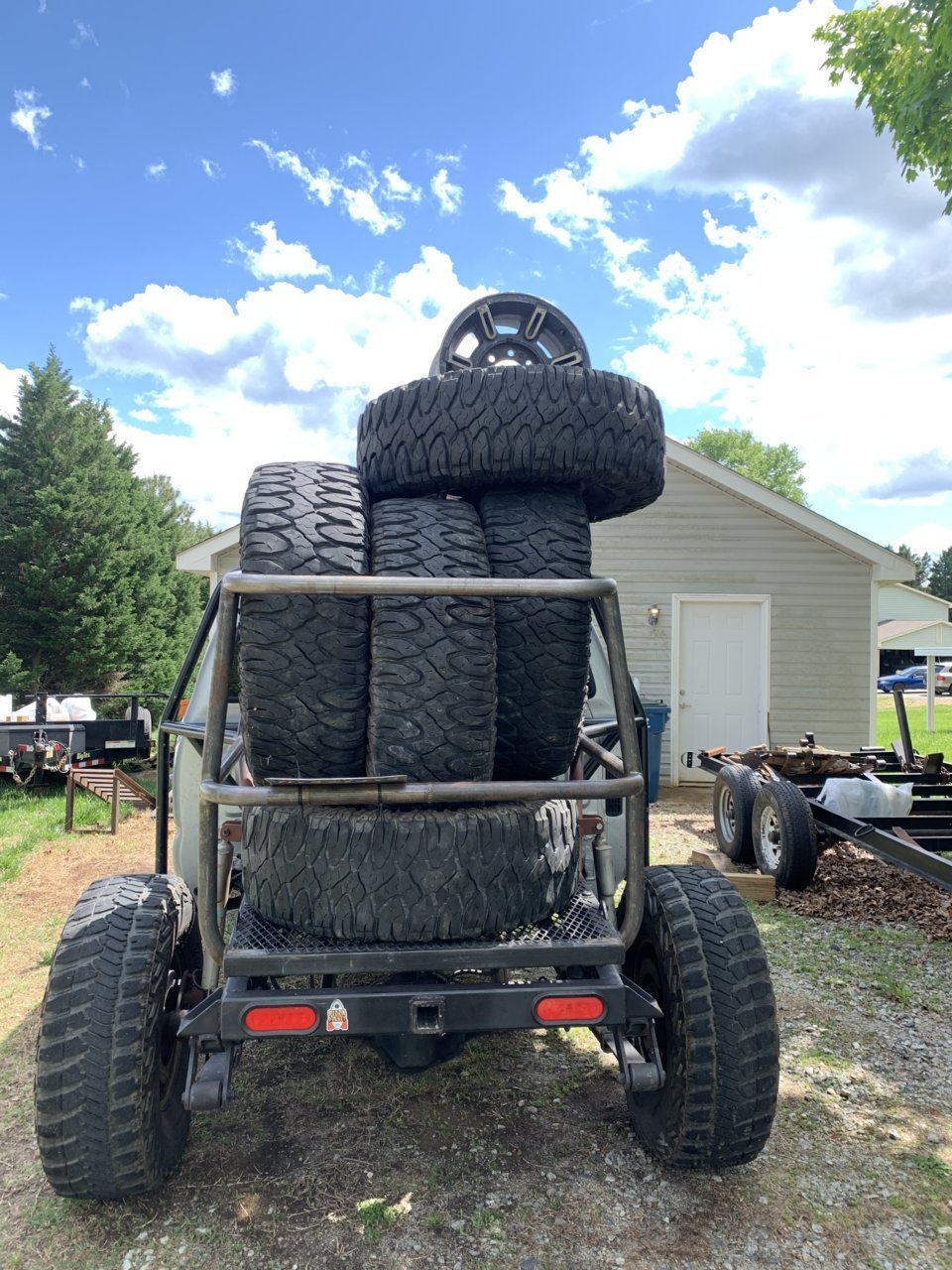

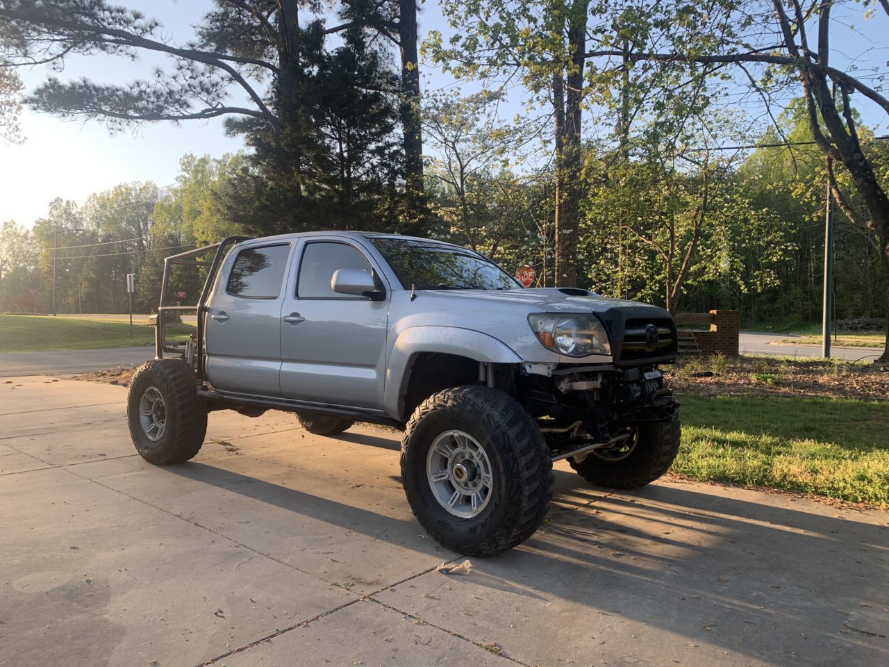

    Getting rid of the old 37’s.
    Found a set of 5 38 Patagonia’s
    Mounted them up this afternoon.
