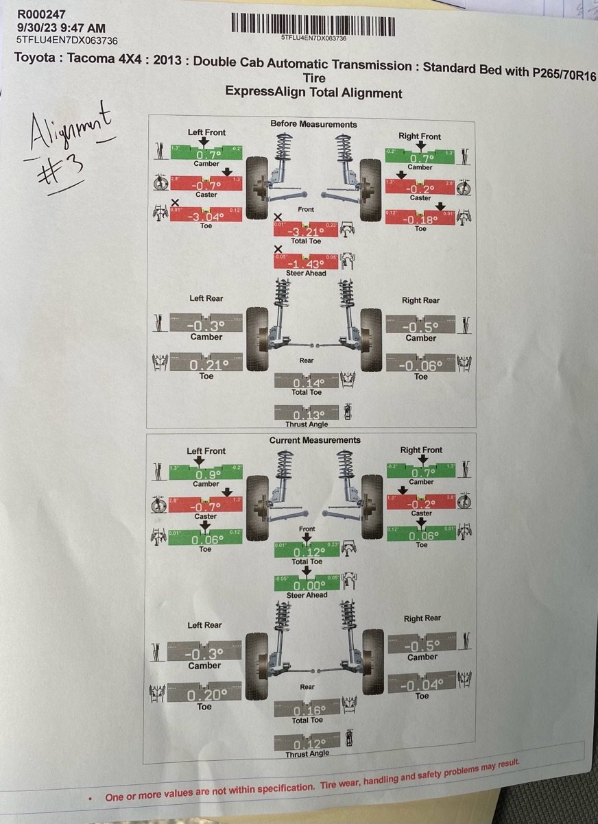

    The Issue: Les Schwab has attempted to align 3 times (They have graciously only charged me once.. god bless lol)
    -Alignment 1 - I had 1.5" pucks on regular 5100's at the 'no lift' setting... They said no way get some SPC UCAs
    -Alignment 2 - I had the 3rd gen TRD 5100s (no puck). Was at approx. 2" lift probably a tad more... They said no way we can align it you need to fix your seized control arm alignment bolt BUT you do not need new UCS...
    -Alignment 3 - TRD 5100s, new alignment bolts/bushing in LCAs, Tabs have been welded to be reinforced, ALL BOLTS TURN EASY... They say (yet again) No way you need new UCAs we can not align it properly as-is (see attached below for alignment report)

    When they say cant align correctly, you need to clarify better what that means.
    First, do you need an alignment? Does it drive straight, feel stable, and no odd tire wear?Second can they physically not align it at all or is their tech just saying computer didn't show a green light so he doesn't know what to do?
    Seized cam means physically can't align it. That will not fix itself and will prevent alignment. A good tech should be able to at least not make handling any worse until you can fix the cam by doing adjustments to remaining parts that are not seized. I doubt les schwab has put a good tech on it.

    totmacher, I've added the alignment report and more detail on my issues!

    Based on the printout, i agree you likely need uca to make it handle well and have good tire wear. Might be able to get it ok but cams would be maxed out and tech would have to be halfway good at his job.
    I personally would look for lowest maintenance option. A balljoint style and oem style bushings that you dont have to grease.
    ghardy[OP] likes this.
