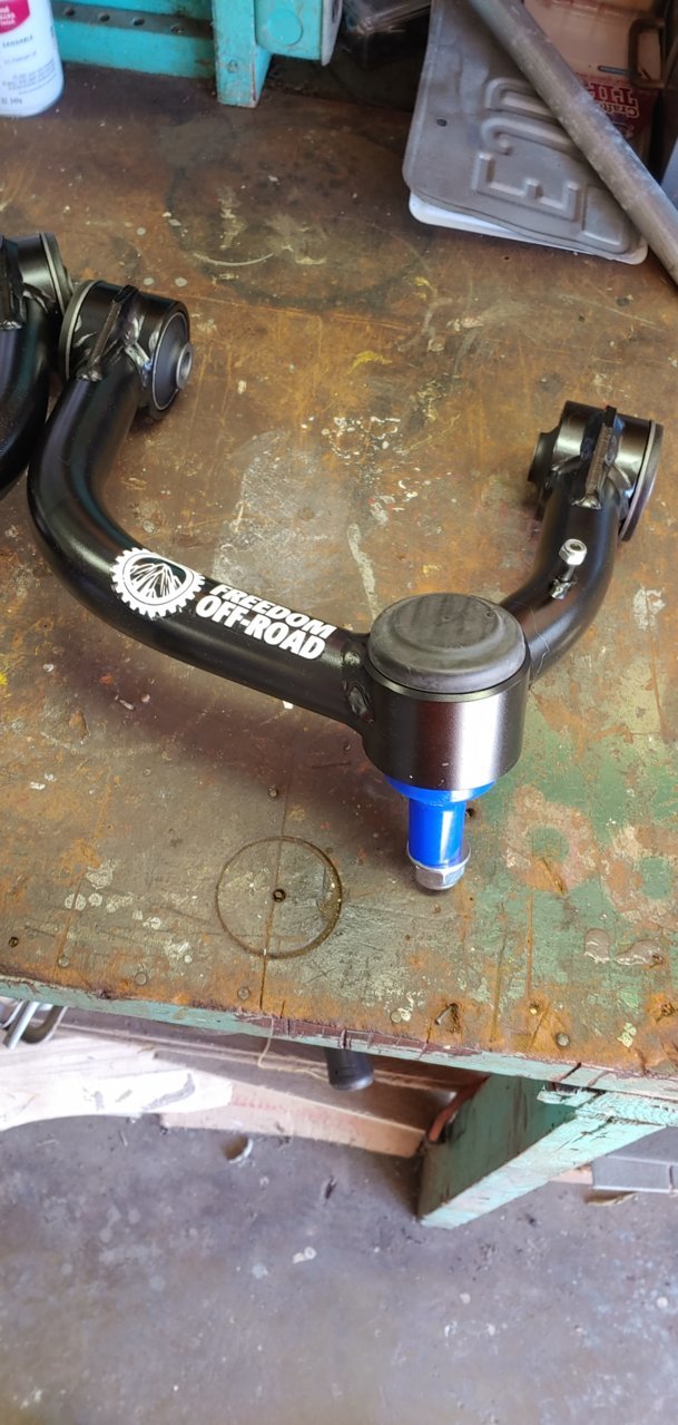

    Message_1602269817067.jpg I have Freedom Offroad UCAs and have been happy with mine. You can get a set for around $360
