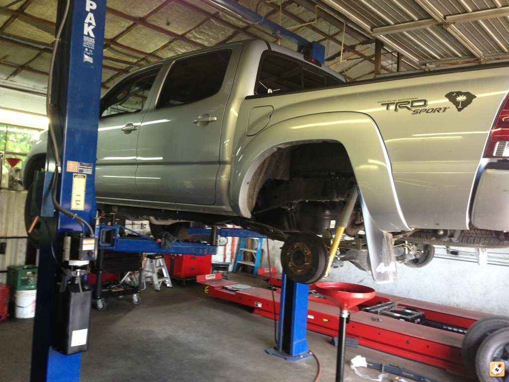

    Looks like the lift is being planned to go on Saturday night (I got the shop all to myself). Tires will have to wait. Ill post some pics! Thanks.

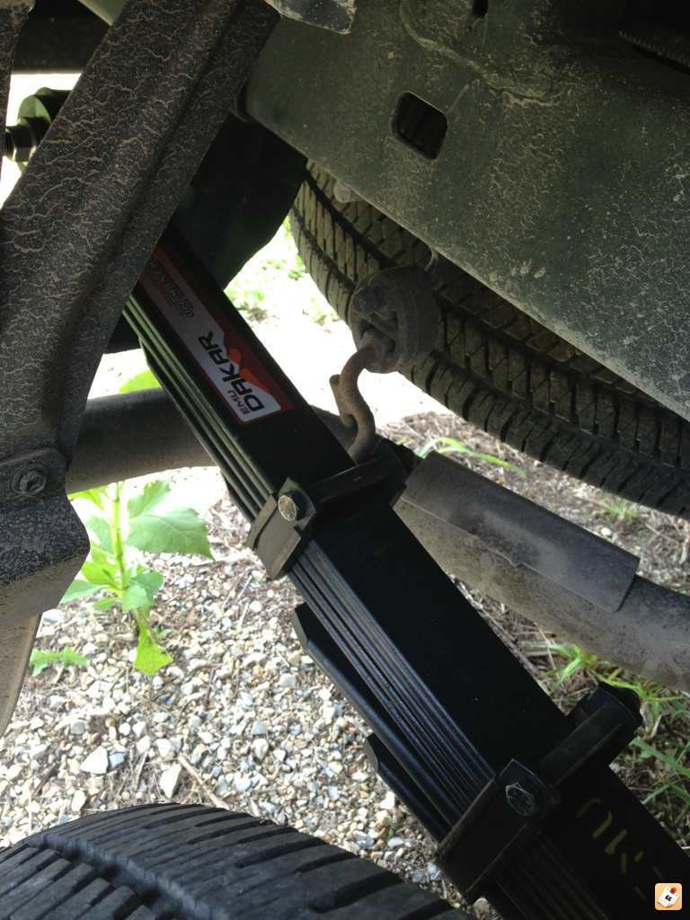

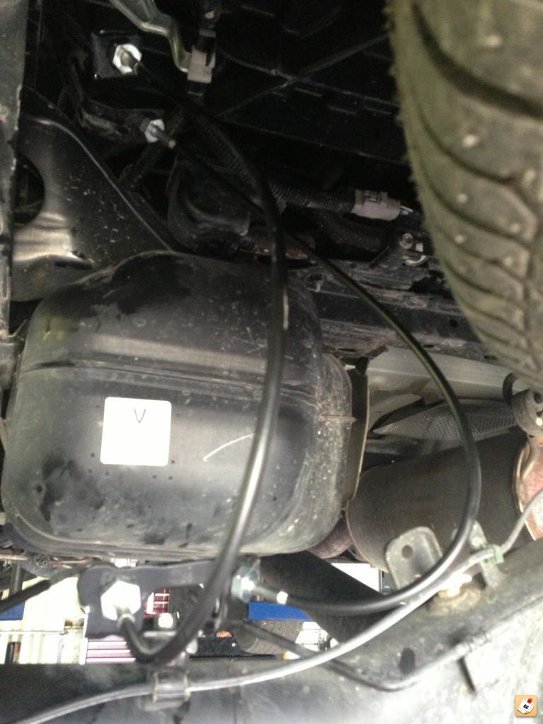

    Just finished the brake lines and installed the dakars, gotta go cut grass then back at it at 6!

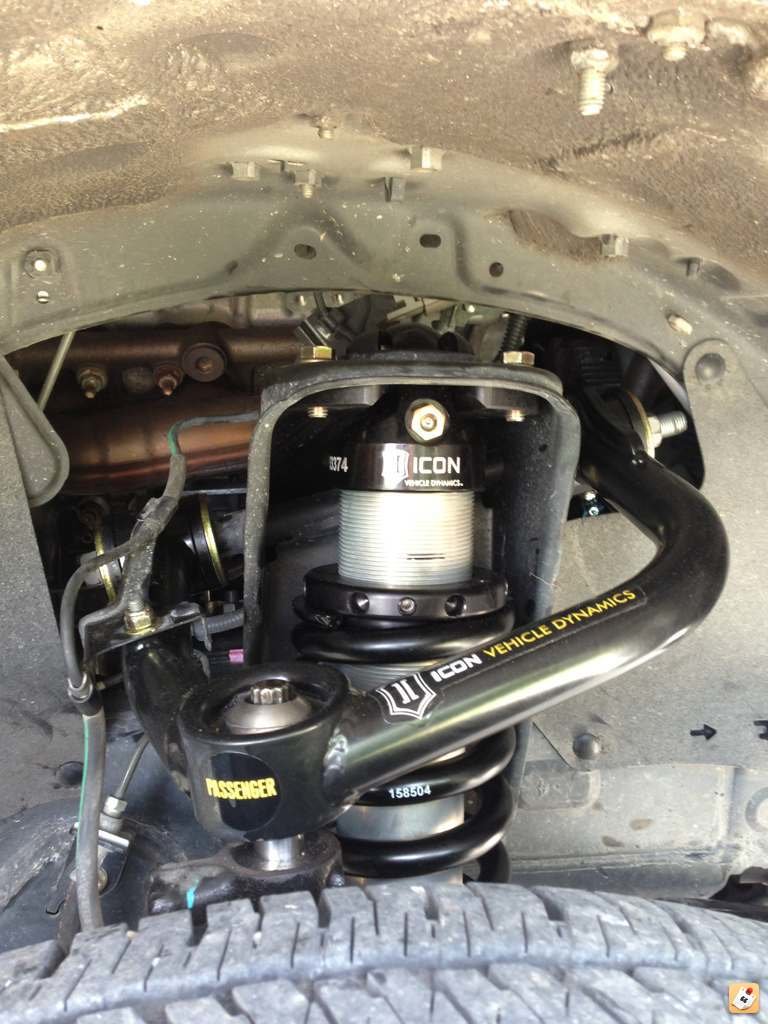

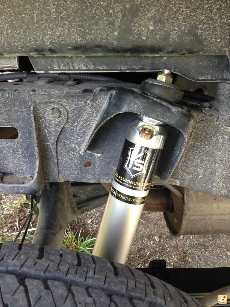

    Right now after driving about 10 miles, the dakars gave me 3" in the back, and up front is set at 2.5" from icons. I will tweak it next weekend. Numbers with fibermax cover and full tank: DF: 23 3/8"/DR: 24 5/8"; PF: 23 11/16"/PR: 25 3/16"
    Any feedback on adjustments or am I good like it is? Took about 7 hours to install everything and adjust. I have a take off shudder from 7-9 mph so any help with that would be appreciated. I did install 3 degree shims and re torqued everything.

    Very nice setup - I have one suggestion since you have the ICON arms: http://www.tacomaworld.com/forum/deals-coupons/287829-icon-uni-ball-upper-arm-cover-pre-orders.html
    The covers will help keep the uniball cleaner :thumbsup:

    So I went out and adjusted the icons some more and can't seem to get the taco lean out without taking my drivers side shock down too far. Right now the measures are DF: 23 3/16 (2.25" thread showing); and PF: 23 1/2 (1 11/16" thread showing) makes it a little over .5" difference in threads. The DF still has 2 3/8" of travel left though.

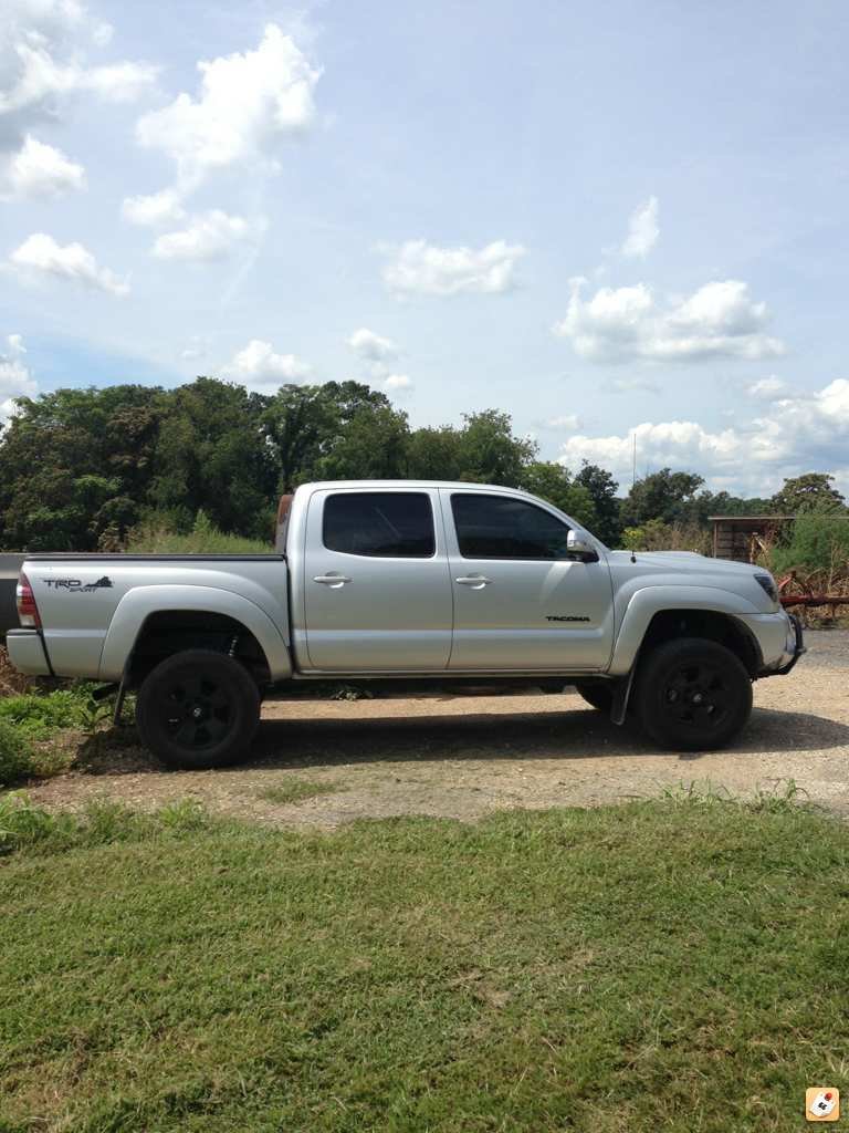

    Got the wheels and tires on, very pleased how everything has turned out. Thank you all for the help.
