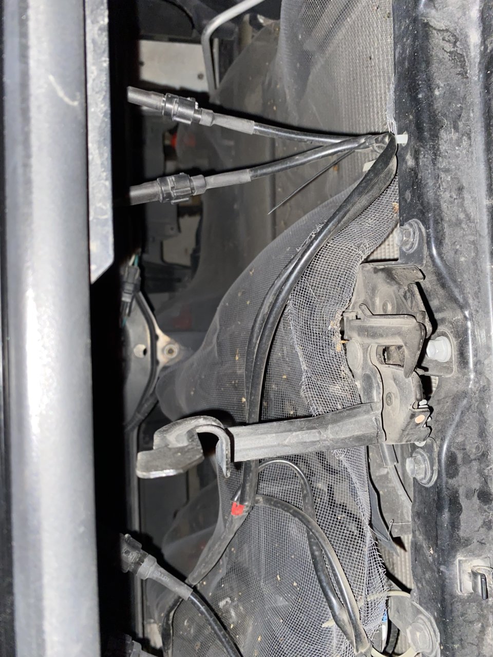

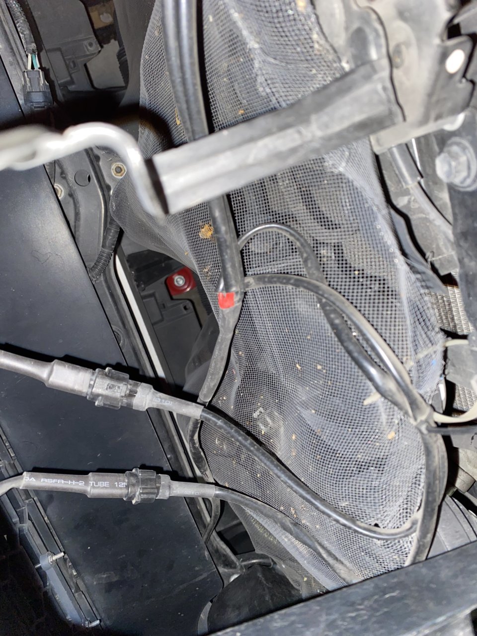

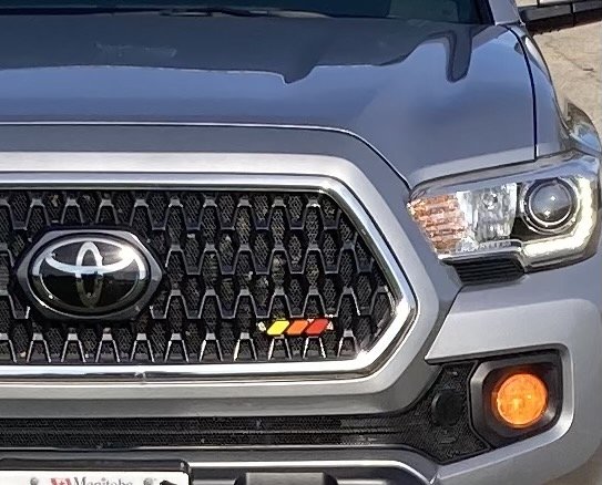

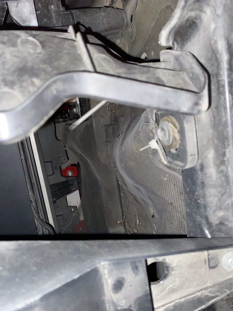

    Just use cheap screen and zip tie it on the inside. I’ve done it to all my vehicles.
    pics will follow shortly

    This is similar to what I plan to make if noone has one available. Did you use aluminum or fiberglass screen

    Aluminum
    after taking those pics, I’ll hit it with an old toothbrush to clean it off this weekend.

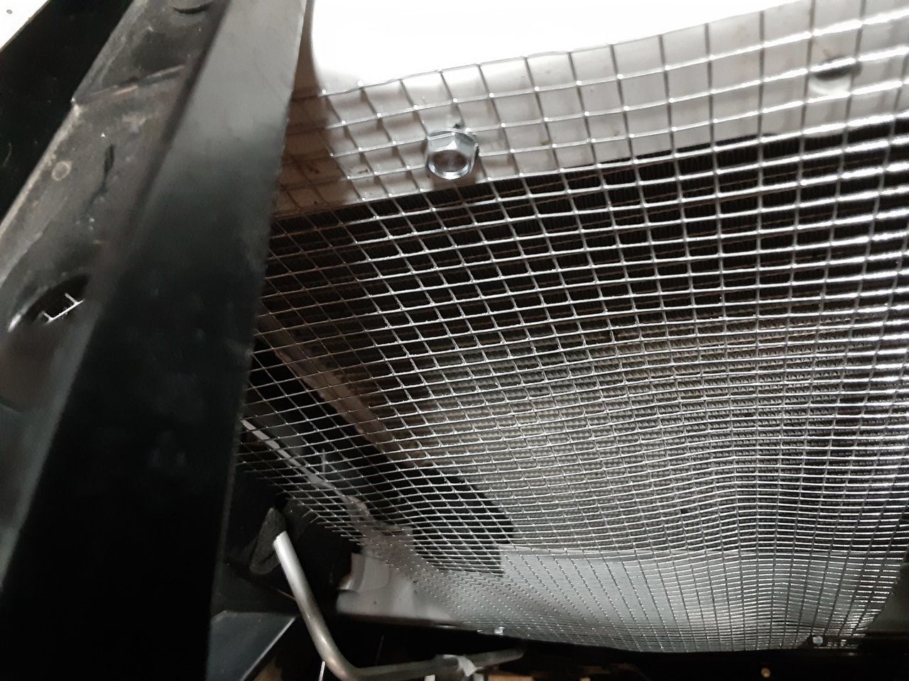

    I agree that it will slightly restrict airflow. But fins getting bent over will do the same and is harder to remedy than changing a dirty screen. I suppose it depends on which you are worried about, and the area you drive in

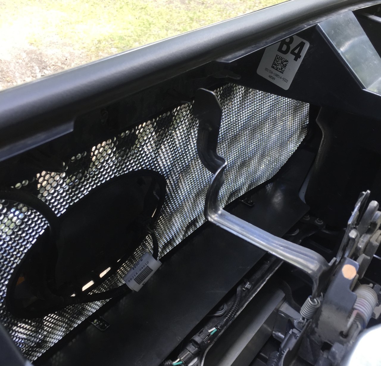

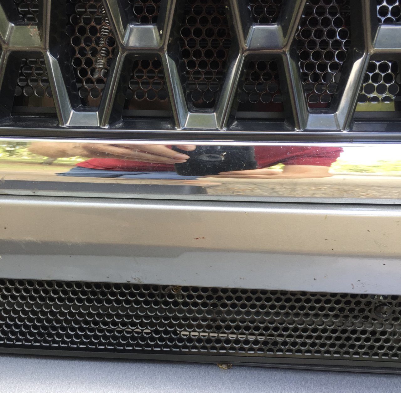

    Cloudrider makes exactly what you’re looking for. It’s a powder coated metal bug-juicer that fits behind the grille and a piece goes across the front under the grille. Keeps the rad nice and clean. Need something like this in Manitoba in the summer.

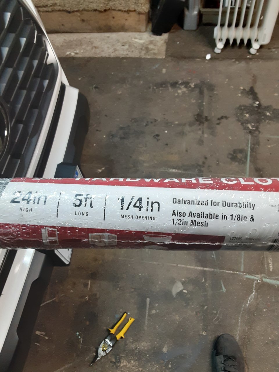

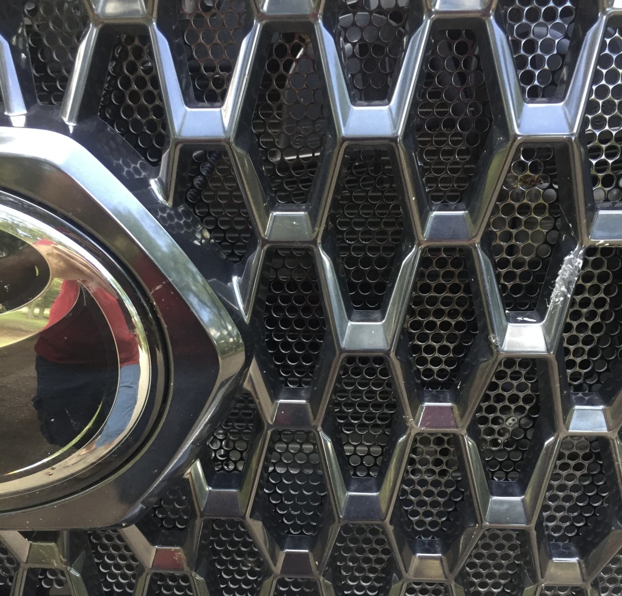

    Decided on this 1/4" wire mesh, I'll cut sections to fit and install with self tapping screws 20211113_110200.jpg
