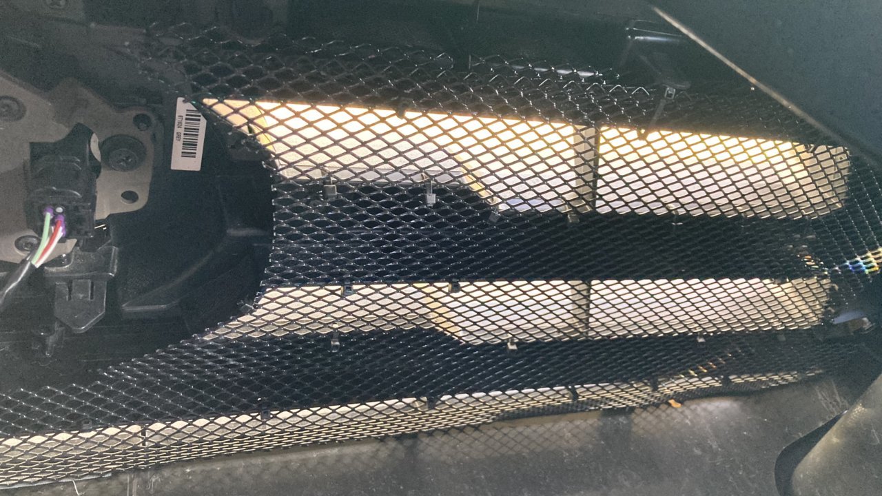

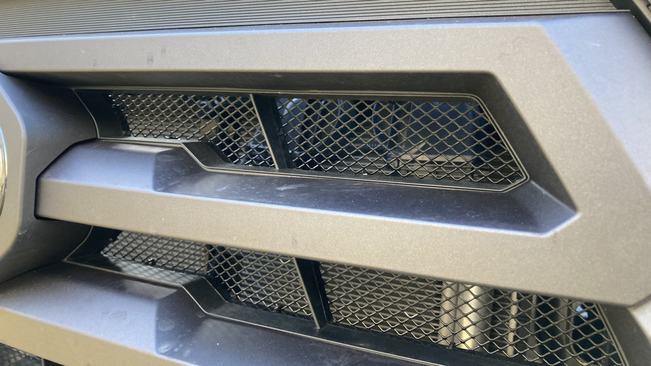

    Lowe’s has black powder coated gutter screen. It’s what I used. Simply remove grill cut gutter screen to fit. I used zip ties. I’ll post some pics when I get a better signal. I live in the sticks.

    The Lowe’s panels are long enough for the whole grill. Only need two. And at around 5 bucks a piece it was a steal. I’ll try to post a few pics but I live in BFE. May take a while.
