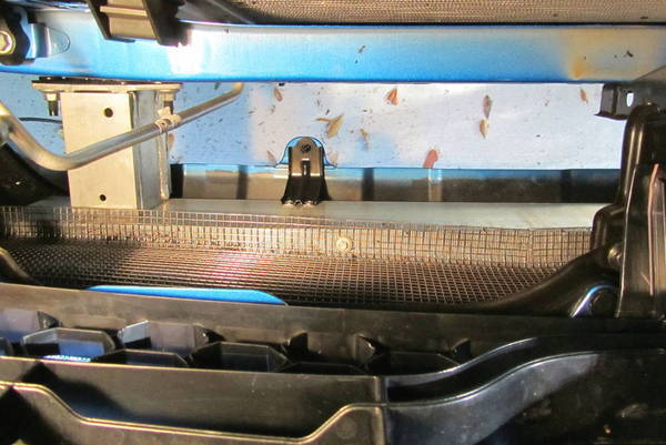

    We have a lot of bugs in Florida, so in March I requested info about how to cover the bumper slot intake so that bugs would not splatter themselves all over my new radiator & condenser. Again, the other day, I asked again about the same subject, but no one replied either time. I guess no one else cares, but just in case, what I ended up doing was taking a piece of stainless wire mesh & covering it with household screening. I was stunned on how easily the grille pops out to get better access to the bumper slot. I just bent the 1/4" squares SS wire mesh into a L-shape, pushed it up behind the bumper slot from the top with the grille out, & fastened the other leg of the L-shape to the top of the aluminum bumper (behind the facia). I am using a FIA screen for the grille, but now the bugs can't blow through the bumper slot either. I am surprised that no one makes a kit to do this.

    Looking down behind the grille on the left side, you can see the top of the aluminum bumper where I used a self-tapping screw (on both sides) to secure the L-shaped S.S. wire mesh, covered with household screen, placed behind the Bumper-Slot. I also secured the mesh to top of the bumper-slot using tabs & S.S. screws. A total of four screws is all that was needed.

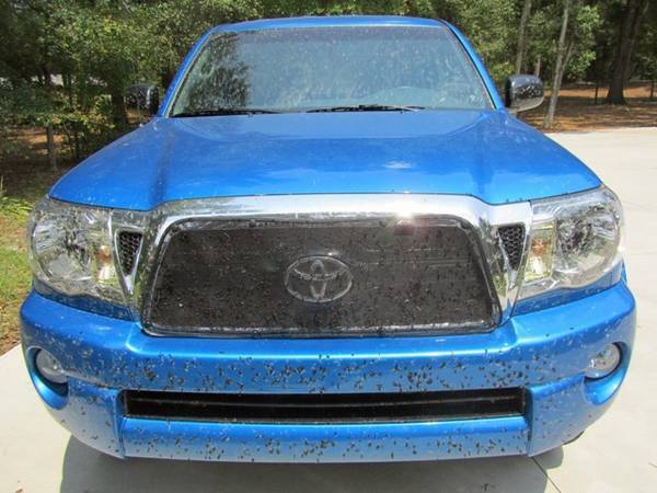

    This was only a 3-hour drive in Florida, during Love-Bug season. Fia makes a great screen for the grille, don't they think the bugs will come in the bumper-slot too?? I fashioned the bumper-slot screen (above) a few days before this & my radiator / condensor still look like the day they left the factory.

    omg that's a lot of dead bugs!!

    Yes, a lot of dead bugs (in just a 3-hour drive), which is why I was desperately looking for info on bug screens.
    After this onslaught of bugs, I popped off the Fia grille screen to clean it & stuck a garden hose up from the bottom of the bumper to flush out the customers in the bumper-slot. By the way, to clean the bugs off the rest of the truck quickly, a used dryer-sheet with a little soap works wonders. The dryer-sheet is not abrasive, but has just enough grit to get the guts off fast. Some bug guts can actually etch into your paint if not washed off quickly.

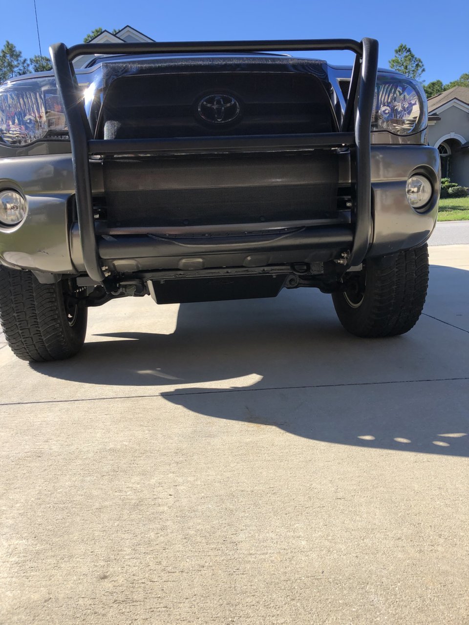

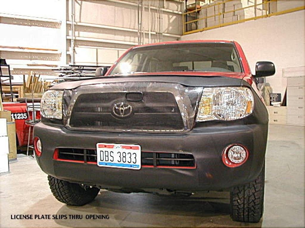

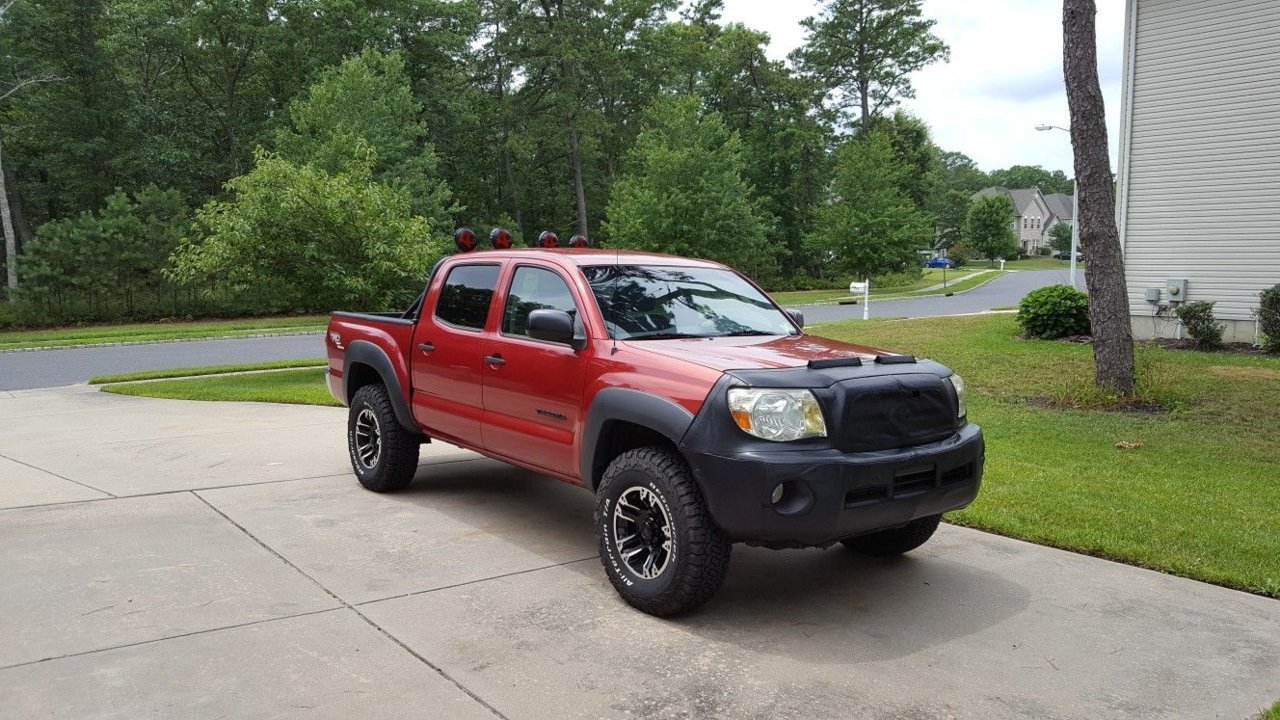

    Old thread but it's the same now in the area I'm in. Is there a seller that makes these ready to snap on our trucks?

    Wow! This is exactly what I need. Link?

    Google it! Covercraft and AutoAnything sell for $231.
    I made my own using dog screen (heavy stuff) at Home Depo and some push pins.
